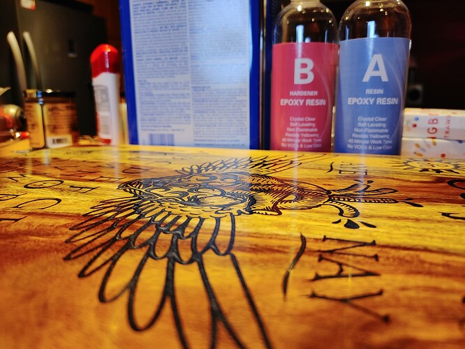

I am currently building cutting boards and butcher blocks and deep engraving and filling with epoxy. I like to cut acrylics but it’s not something I do a lot of
That looks like something a suitably sized CO2 would do quite well. I’m not in that market, but I believe your workpiece dimensions are going to put you into a floor model which would greatly exceed your budget.

I am deep engraving (~.030"-.050") cutting boards with a 20W diode running about 4-5000mm/min. It’s not blindingly fast, but I can do a full face engrave (scanning the entire board surface) of a 12x16 board in about 4 hours. A couple lines of big text could be done in much less. I tend towards more fine detail, so I often bump up against spot size and LPI limitations. CO2 would be faster, but really no better for detail. And, of course, a smaller spot means more scan lines, means more time at a given speed. No free lunch. Lol.

The spot size of my 20W diode is roughly .1x.15 on wood. That limits my effective interval or dot pitch, so any design requiring more than about 260 LPI loses definition. Some details are completely obliterated, corners get soft, fine lines get jagged or dashed, etc. This is with a Fill layer. In Line mode, I just get “fat” lines or overlapping if, for example, I wanted to produce something with an antique “woodcut” engraved shading style.
Take the image below. Scale it down so the individual lines are less than the beam width, and all kinds of nonsense happens. Lol.
