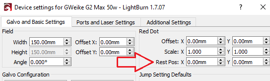

You can adjust the rest position (center) in the galvo and basic settings.

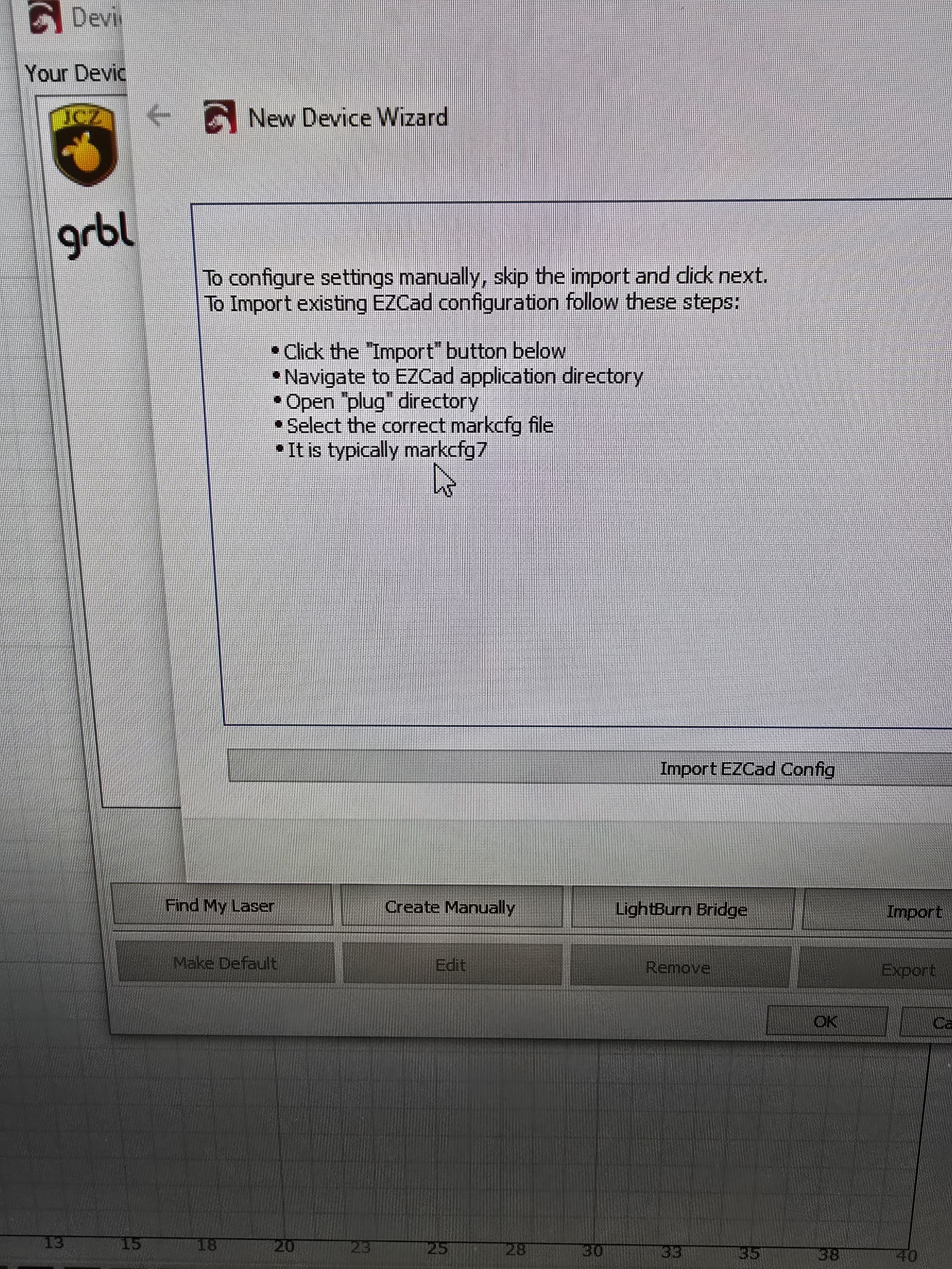

It doesn’t look like I responded to you on here I did respond to email but I’m responding on here as well. So with what you said and what I’ve been doing this is where I am currently at. Seems like the cylinder correction is working currently. Unfortunately haven’t been able to test it because now I can’t use framing tool. Well it looks like from the computer end it’s running but it’s not shooting or firing my frame. I did hit start and it did engrave so it is engraving. My focusing red dot is working. But my framing that shows me where to position does not. My assumption is while I was trying to reload the software it didn’t load the framing tool correctly. I have tried again still no luck. I do have the original USB was thinking about trying to run it again off of that instead of what I have saved on my computer. But I think that’s pushing it hoping for something lucky to happen. Do you have any suggestions? Sending pictures of what I have

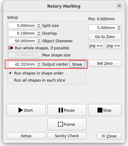

Don’t know in your situation if this will help, but you can adjust center for a rotary.
Thank you very much but unfortunately I’m not using a rotary I’m trying to use the cylinder correction. If I do it horizontally it thinks the center around 140 My work bed is only 110 if I do it vertically then it’s way high. But thank you for the response
