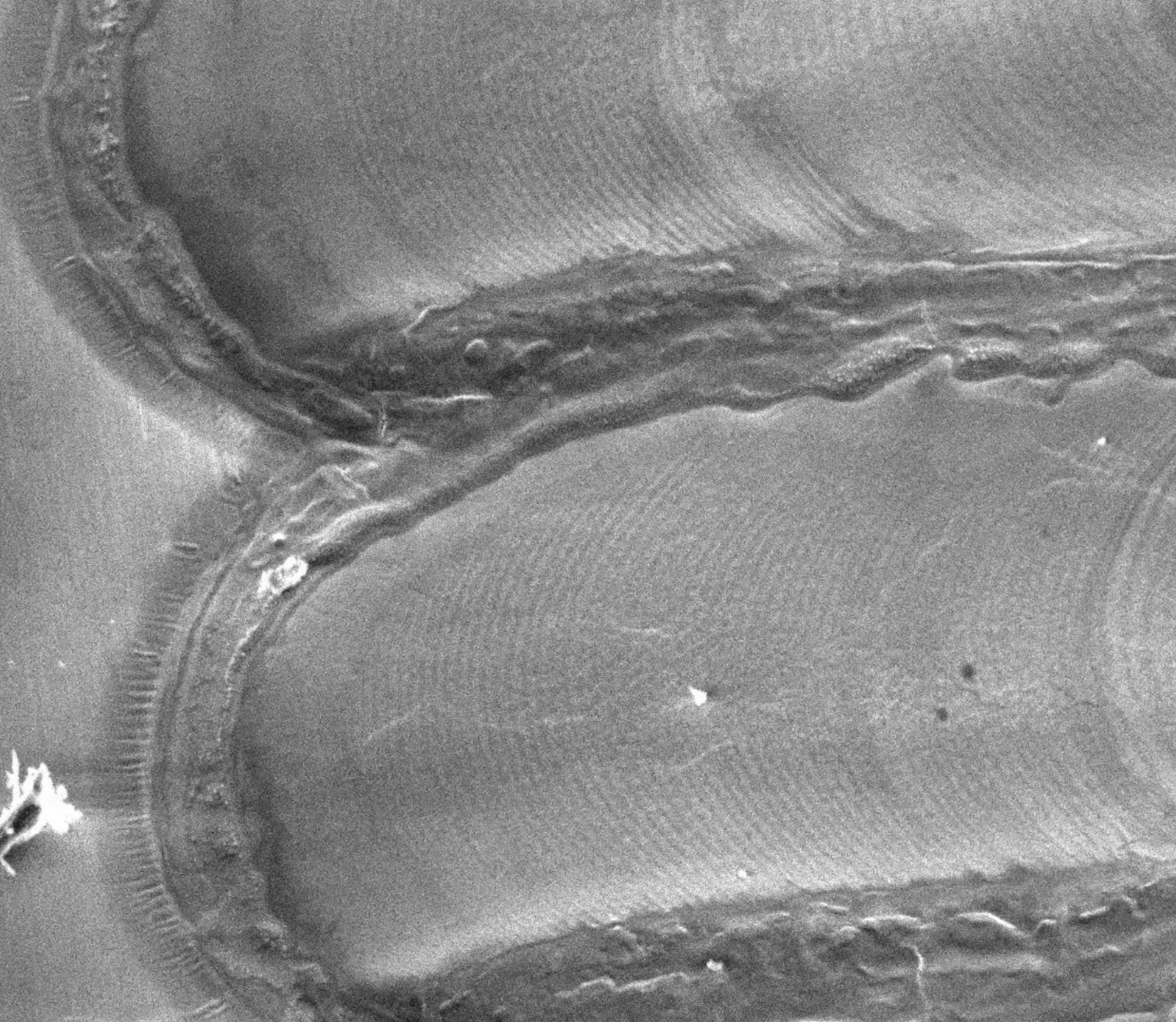

I am trying to replicate Applied Science’s method to create diffraction gratings on Stainless Steel.
I am suffering D:<
Setup:
ComMarker Omni1 5Watt (355nm)
Sheet of Stainless steel
The video in question is this https://www.youtube.com/watch?v=RsGHr7dXLuI
Now a short tldr for those lazy to read the paper in the description.
Incident beam hits the sheet of metal. Electrons thermalize in the process creating a temporary plasma. This makes the dielectric constant of the Steel surface negative, which allows according to the Drude model, for the electron frequencies in the surface to slightly lag behind the incoming EM wave due to their inertia. This will cause interference fringes on the free surface electrons, spreading out the surface heat in microscopic peaks and valleys along the laser dot. The fringe spacing is obviously dependent on wavelength of light (which may be the cause for my failure). So the interference pattern is inside the dot so to say after it is done radiating.
So the whole brunt of the technique actually ignores line spacing altogether (the mechanism you would use for oxide layer growth for colors) and focuses more on line dynamics. The idea is that even a single etched line is going to look Satin Rainbow. And you have to play with other modulation parameters
Now the commarker omni1 does not have power modulation, they run at a constant wattage and the amount of fluence you deliver to your material is mostly controlled by the qpulse parameter.
In the video he is using a 100Watt MOPA fiber laser (~1060nm i believe) with what seems to be a wide field f theta lens (from the size he is engraving on).
He runs on 1 micron pitch (When frequency in KHz match the speed in mm/s, each time the laser dot hits, the center-to-center spacing is 1 micron).
Now this is Important. This pitch and the grating pitch are NOT the same. The grating itself has features on the nanometer scale.
Those small ripples are the fringes and the large blob is the laser dot imprint.
I do not have a SEM to check my steel samples, and i COULD be getting fringes but not of the kind that will diffract in the visible wavelength (if any exist).
However the diffraction equation does not really help me here because i could just be creating fringes that are either too small for the visible wavelength or i am not creating fringes at all.
The guy in the video runs his laser at 300KHz which gives very low exposure times (unlike my maxed out at 40KHz) and causes the metal plasma to not cool down in time before the next time hit comes.
Overall i have done interesting colors but nothing close to a visible-wavelength grating.
Anyone has suggestions ?

The small rings are anywhere between 400-1000 nm, apparently they can be modulated by adjusting fluence and intentionally defocusing the beam (as mentioned in the scientific paper in the video)
They diffract the whole color spectrum in his video. Some of the gratings switched red-green but some (most) went into the deep blue’s too

Also important, those rings are not ablated from the material. The surface itself is flat as in a later video 8 months later he used an AFM to check if he could mold a holographic sheet out of it. Apparently what happens is that there is this magical point between ablation and melting, where the Steel plasma behaves like a fluid, and the polarized Poynting vector from the incoming laser wave jiggles the surface of the molten fluid which stands under a nanometer layer of Chromium oxide. The layer of molten steel itself is few nanometer thick too. But Cr2O3 has almost double the melting temperature of steel. So it will enclose the thin sheet of molten fluid underneath and transfer the vibration. If the pulse duration, pitch and cooling are at that magical point, the molten steel under the oxide will solidify very fast with the induced vibration mode and permanently form into a grating. The transparent oxide layer coats the grating.

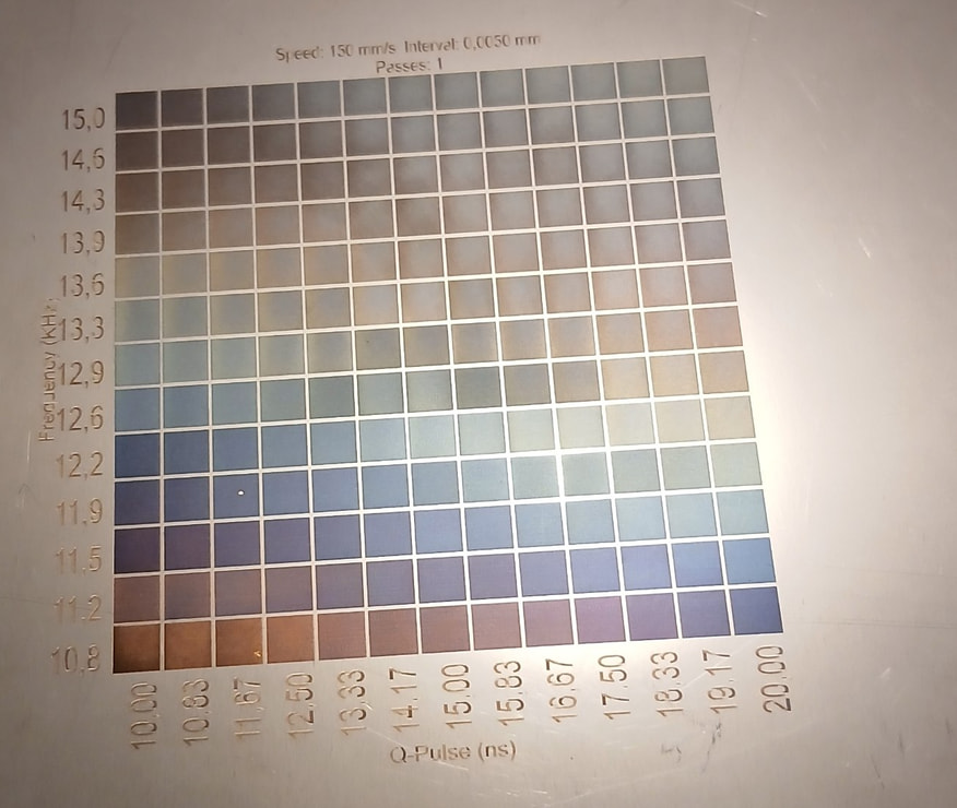

That is a myth. UV lasers will absolutely produce hot plasma on steel. And you can get very good colorations too just as you would with an IR laser. In fact you kind of have an advantage on how much heat you can create because they can usually get smaller beam diameters (usually depends on your optics i would not entrust marketing on beam quality)
Different materials have obviously different absorption rates for different wavelengths but steel will actually absorb more UV than IR ( https://endurancelasers.com/absorption-wavelength-spectrum-for-different-materials/)
The cold ablation, i am not sure where that legend started. Even engraving wood with UV is going to smell like burning matches (god knows i wear a respirator mask). In fact the Omni 1 only goes up to 40KHz (1-200ns) which is too long of a pulse duration to get a true clean ablation. That would be possible with MHz fs lasers tho.
This is a color palette done with UV
As for your other question, i am trying to do diffraction gratings. These colors are the result of growing an oxide layer, whose thickness is going to essentially filter out parts of the white light spectrum. Hence leaving you with your color

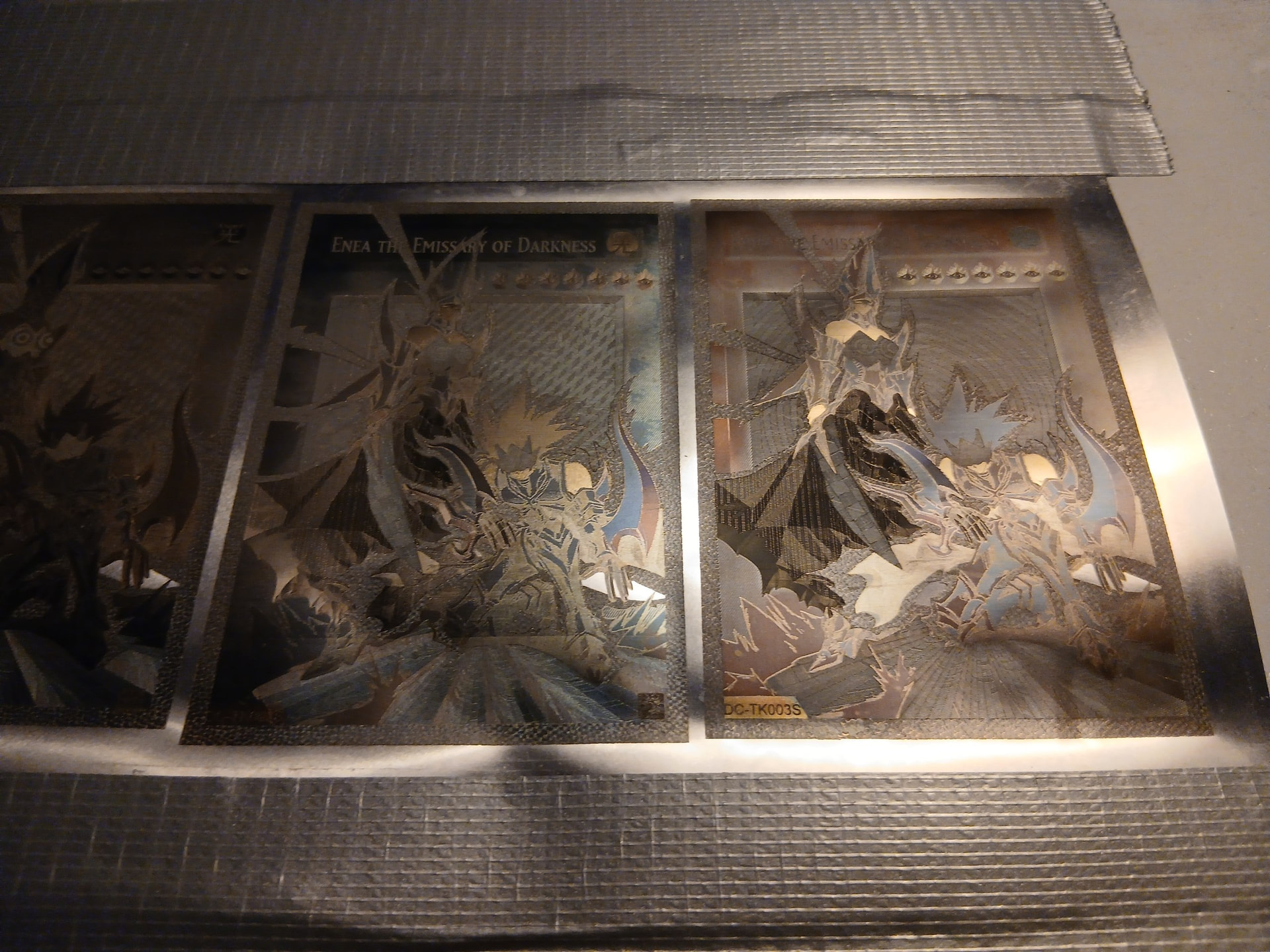

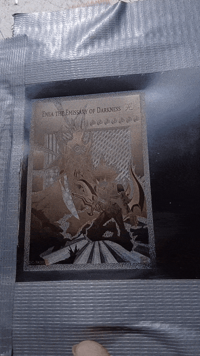

Some more pics of my color work. I usually sell these tokens as commission for us Nerds

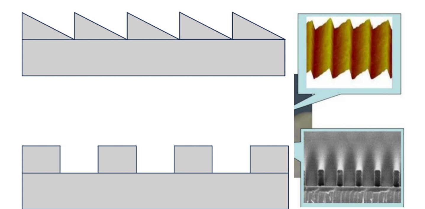

The shape and slope of the fringes does indeed determine how the final pattern will look. I believe different types of microstructures get different effect. I know for sure straight lines give u a diffraction rainbow, but i am not sure how sinusoidal fringes or crossed fringes would behave. Or even fringes with different shapes.
Like these. These are 2 different rainbow diffraction Gratings from Zokoptics
Zokoptics do a square mask with straight tubular gratings. The beam dimensions could be brought to the mask size or visa-versa by columnation and the result would be a nodal point/standing wave separated by lines of non-displacment. Therfore the point of interest is the mask and it’s ability to create measured areas of non-displacment.
The zokoptics mask uses tubular grates that may cause too much diffraction/diffusion after the bean passes through the mask causing interference of a useful kind…or not!
