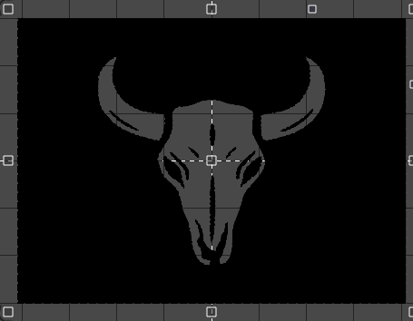

Hello Everyone,
I’m having real trouble getting my head around this one SVG that I want to cut and engrave. I have attached the SVG - I would like to engrave all the white and then cut the shape out so that I’ve effectively created a stamp. Can anyone help - I’ve tried masking (not the solution) and the changing the order of the lines so that there is an outline for the engrave to work in but then I get stuck.
I’m sure someone knows how to do this, please can you help?
Best
Louise
Take your original SVG
Use the OFFSET command
with these settings
to get this result…
Then draw a box the size of your rubber stamp around the SVG to get this…
The black area will be removed, leaving the white area to pick up ink to transfer.
