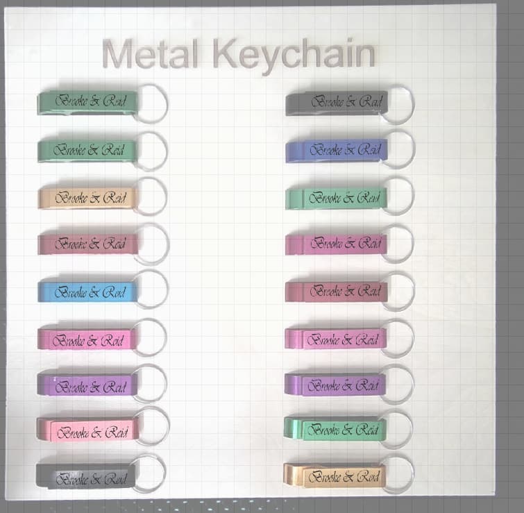

I cannot figure out how to line up my items with a camera. I have done all the setup and configs. It works great with 1 item but when i make a jig and set it up the job is always off. Creality Falcon Pro - ACMER camera - Light Burn - Photos for reference attached. I was able to change my x,y axis settings and got the X to show perfectly in the corners but it still will not line up with my jigs

You need to be aware that the camera calibration only works on the level you calibrated it to. Your flask openers are about 10 mm higher than the paper template you use. This doesn’t work. You need to do the calibration at the exact height of your openers; otherwise there is a shift in perspective.
