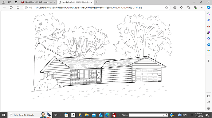

I have a PDF of line drawing of a house, but its not converting any of the brick lines on the front of the house or the horizontal lines on the sides of the house and garage.
I attached the SVG
Alexis-neighbor-house
and also a screenshot of what it looks like in Lightburn. Do you have any idea why those certain lines disappear in Lightburn?
Even in this help forum the file is missing lines too. I am lost why.

They are very light.
alexis darker house lines
I made the lines darker and but when I open in Lightburn they are still missing. Attached is the file. Could someone open in their Lightburn and see if it works? When I open the file it another program the lines are there. Could I have some setting turned off thats causing this?
I also included a screen shot from File Exporer of the pic and the lines are there, but they disappea in Lightburn.
Note that OP is using the posted SVG file. He’s not working with an image.
@Brian19335 How was the PDF generated? If the brick lines are generated using a pattern then LightBurn won’t import it. These must first be converted to paths for LightBurn to import them correctly.

The first image posted is an SVG. The forum automatically shows posted SVGs as inline images.
I’m confused though as the OP mentions PDF as well, and as far as I can see the SVG posted doesn’t seem to have any of the lines they say are missing.
