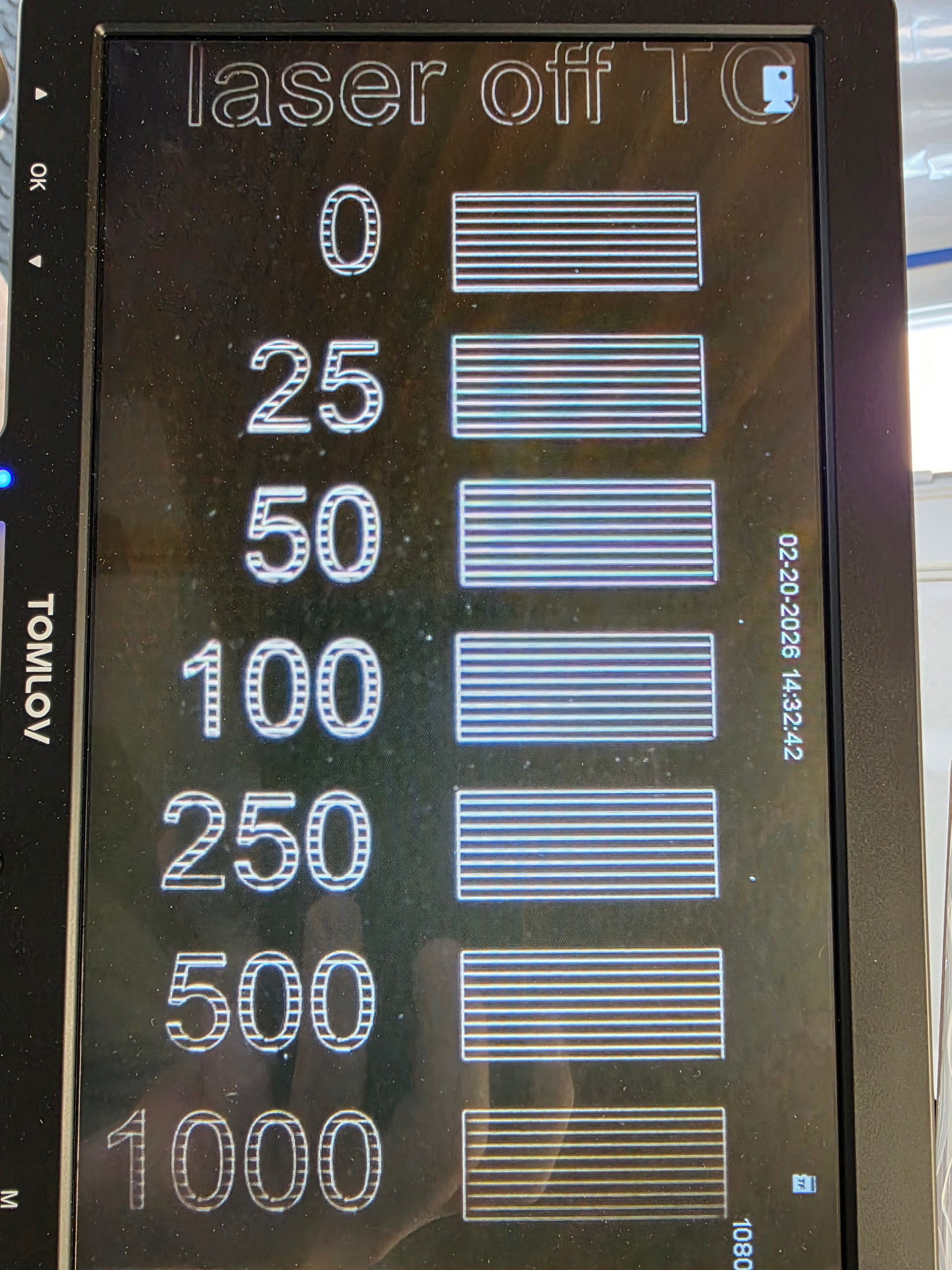

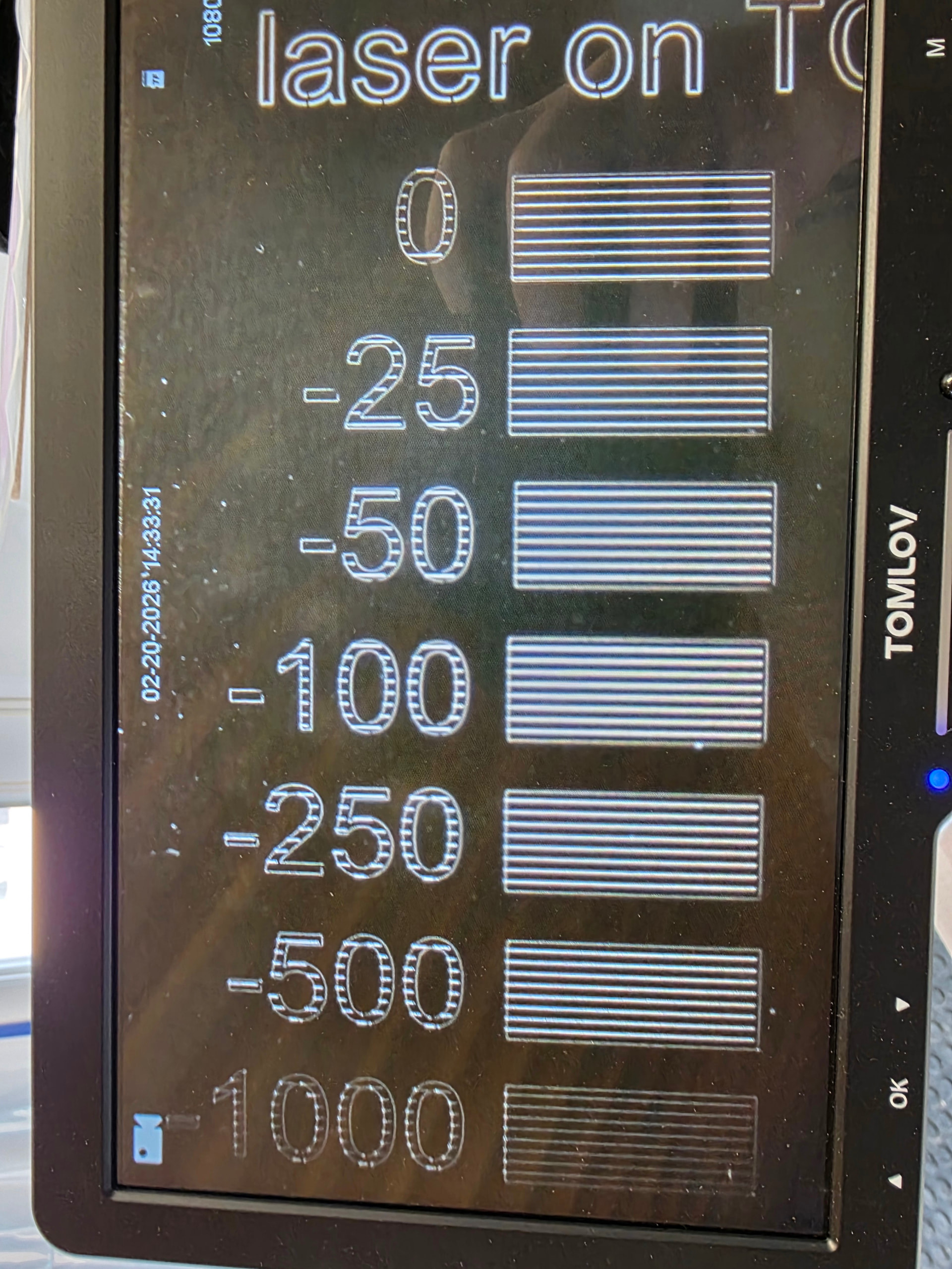

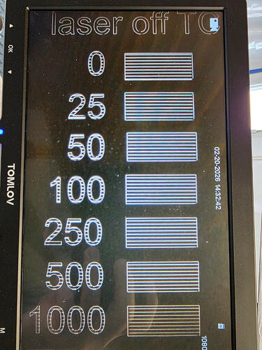

The Ton/Toff delay should always be set globally. At least that’s the way it worked for me, on my machine.
As best I understand this-
The galvo controller is the BJJCZ. It’s all this refined high speed DSP stuff inside, but the fiber source is an entirely different thing from a different mfg and sort of a black box to the BJJCZ. It just blindly sends a fire command and doesn’t have any feedback on when the energy hits the bed. And with high speed galvos, that’s critical. Especially with high res rastered graphics. If doing bidir (and you usually want to), if the left and right passes don’t line up you’d get a double image. When doing rotation (also, you pretty much always want to do this), a pixel firing early or late would be offset on a single line, but overall make a circle across the sum of the passes, with a radius equal to the timing error.
The BJJCZ just needs to know exactly when to send or stop sending the fire command so the energy hits the bed at the precise moment it planned.
It doesn’t matter what speed or type of moment (raster vs vector) it’s doing. It just needs the timing number so the fiber source is in sync. How much a timing error offsets raster pixels, resulting in blurring the image, depends on the speed of the raster too. The spatial offset error you get scales with speed, and the significance of the spatial offset error scales with the level of detail in the job.
So here’s the big reveal- these lasers are capable of getting fine detail at far higher speeds than people (and vendors) think. They just don’t know how to do a high precision Ton/Toff calibration and don’t even realize the problem exists. They think that at higher speeds the galvo mirrors are inaccurate and you just shouldn’t go that fast. And erroneously validate that their testing method was accurate because the raster quality is still ok at the low speeds they think is the limit of machine galvo accuracy.
You might think the fiber laser source’s response time would vary with its q-pulse or power level. But I don’t recall see that on my machine, surprisingly. I can’t entirely rule out that for other laser sources though.
So, I didn’t see any reason this would be a layer setting. It’s a question of the delay within the fiber laser source and it doesn’t know or care what you’re doing with the beam.
As listed on the text on the test LB project, jump delay min/max get set to zero.

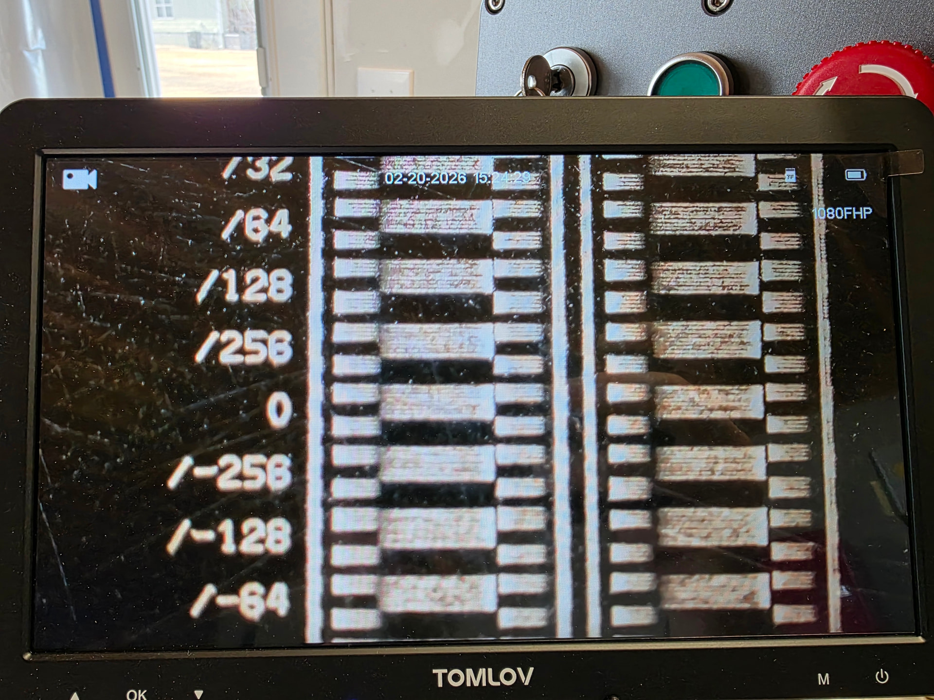

The design of this test is that we’re clear of the edges and the mirrors should be moving at constant velocity across the “gaps”. We’re comparing right-going and left-going passes, at constant velocity, so all you’re looking at is the Ton/Toff inaccuracies and nothing else.
Get Ton/Toff PERFECT first. Then go play with jump delays and polygon TC etc but DO NOT touch the Ton/Toff again.

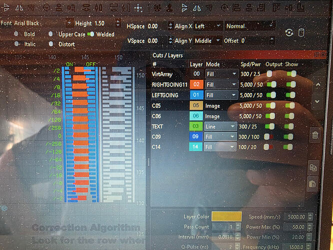

If i am doing frequency for the test… it says speed /Li
So lets say 7,000 / 0.0818 for a 300mm lens
Thats like 86,000 …. I am missing something on that one
I also see some difference between the vector side and the image side that I’m not sure if im supposed to see when looking at this… Itmeans i would have to break between the two… i must be doing something wrong with this

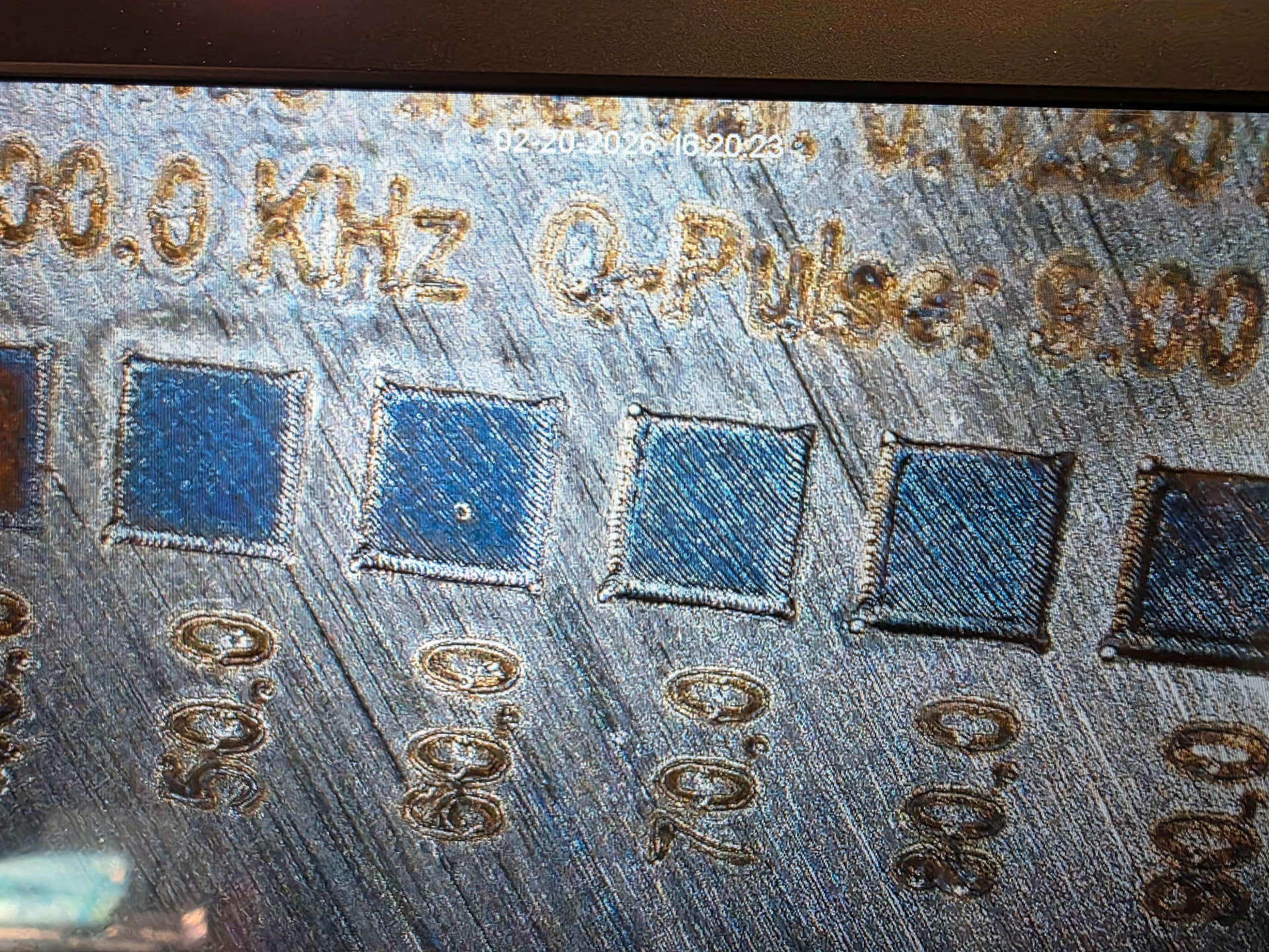

I cant seem to find any combination of setting in LB that will let me do a material test with 45degree and cross hatch that wont show that outside box engraved harder because of the ramping…. No matter if im at 0 delay timing

There IS a workaround. Why is there a vertical bar on the left and right of the Ton/Toff blocks, anyways?
That is forcing Lightburn and the BJJCZ galvo card to start the scan line outside the area you need to have right. It may have artifacts in like the first 2mm of a line at high speed- but that’s outside the timing blocks so just ignore it.
So, the timing test really should be done with the raster layers.
Can I do this fix IRL? Well, say you’re doing a coin. There’s no technological reason LB shouldn’t just pretend like the image starts a few mm outside the first nonzero pixel, start the scan line in whatever direction it is, and be up to speed when it reaches the edge of the image and edge of the coin and fire there.
OK, that’s the way LB could fix it (and maybe they have, I haven’t done tests on mine for a few updates, apologies if I have it wrong). Can *I* fix it? Well, AFAIK you can’t force LB to see the image as larger than it is with white space (actually, I need to confirm that now).
But you COULD make a ring outside your coin image, a ring a few mm larger dia but only one black pixel wide. LB would have to start the line further out and it will be at constant velocity by the time it reaches the coin edge. But it will etch into your holding jig. You could just tolerate it, or put spoil there, or put something there that the fiber laser won’t have any effect on.
