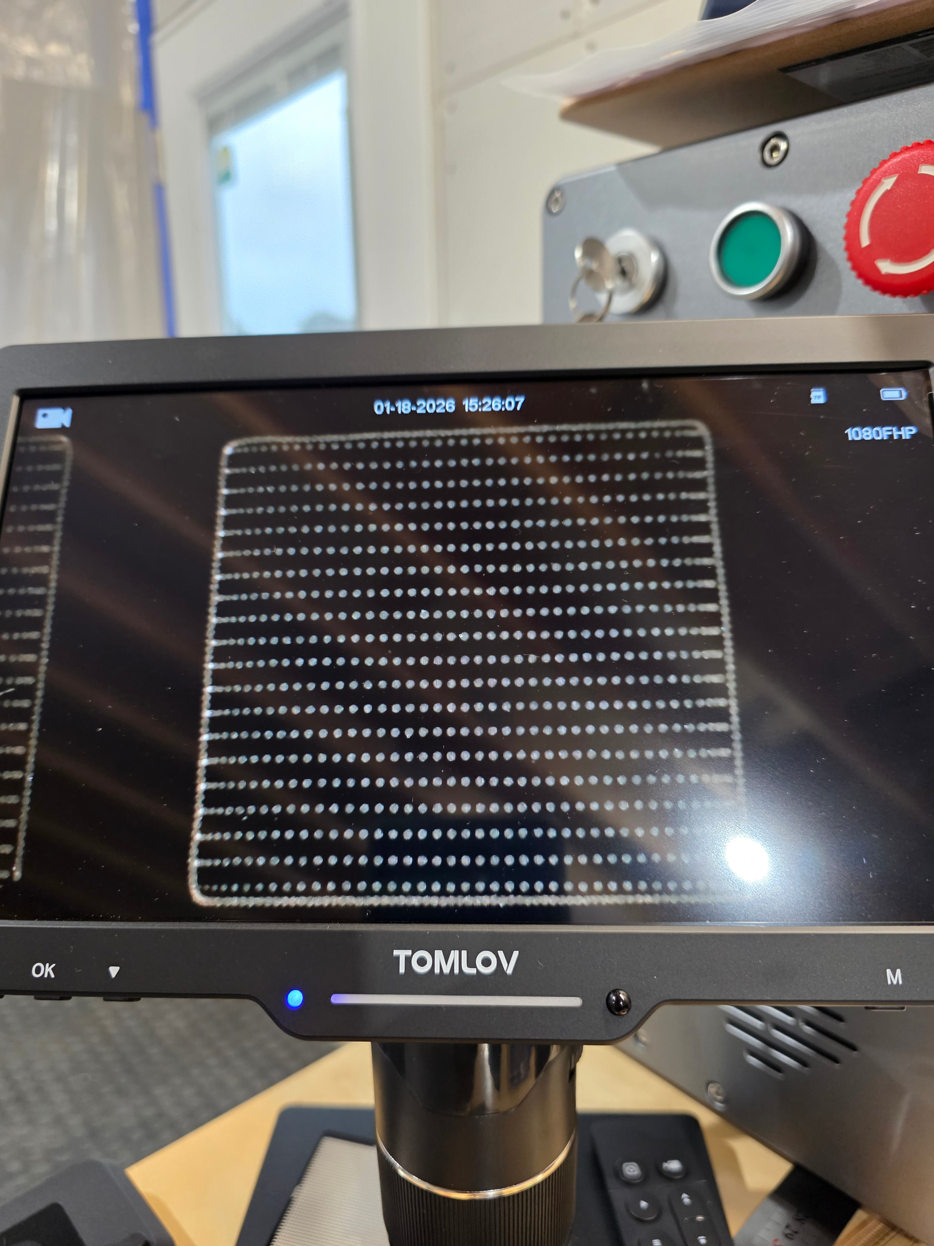

Working with a 60w mopa galvo configuration.
Trying to eliminate the dot density variations during ramp at the beginning and end of a fill line.
Without adjustment for overscanning available… im at a loss for what adjustment ability we have to correct dot density during ramp.
I don’t see a way to adjust the frequency per speed during ramp, or a way to allow the ramp to be during overscan on both sides…
So how do i correct dot density issues without simply going to excessive slow speeds…

Appreciate the feedback on possible ideas. It’s not TC on/off though… i believe its actually the ramp during mark im seeing
Went 1500&2500x magnification setting timing and feel its solid
His suggested jump delays are exactly what I’m running though as I wasn’t concerned about the speed difference he mentions
The picture is at an exaggerated speed so its more obvious what I am referring to with the higher dot density at the ends.

The image is exaggerated with high speed and low frequency just to display what I am referring to, but it still happens until very low speeds and high frequency at different amounts depending on settings.

The image on the picture is very exaggerated at 7k mm/sec, 30k frequency
I am seeing this density show up in slower speeds at various frequency. When doing material testing i can actually see the very edges of the test squares show up earlier than the full square will mark due to the density change.
The tighter-spaced dots at the beginning of each line are the mirrors starting to accelerate. Plus, maybe some ringing and burn-in at the end of the lines when the mirrors come to an abrupt stop.
The left side of the edge appears to show white dots, which indicates a too long “Laser Off TC”.

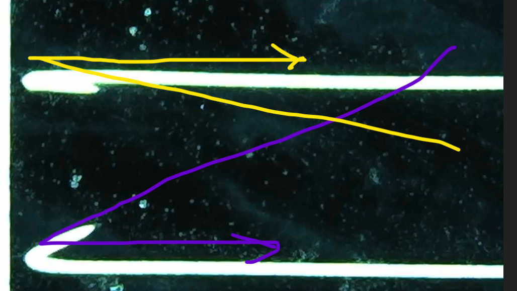

Agree overscan on a fiber galvo would be useful, I’ve got my timing and delay dialed in but get similar results to your photos in certain instances. I think I’ve seen it in feature request or somewhere else with an explanation of why it is not possible with our boards.
I remember this thread where Danny completely dissected the topic, and ultimately came to the following conclusion:
Having recently deep dived into the lmc driver, I may have some insights.
There are 2 separate delays modes available at the protocol level to the JCZ boards: the regular global TC on/off, polygon etc, and an inline delay mode that is specifically for this scenario (actually 2 different ones, one for power ramping/timing delays, and one for clamping power output).
(Note: possibly not on all boards, but the v4 and fiber seem to have it)
EZcad uses this secondary delay AND inserts overrun vectors to prevent this specific issue. I think it also may zero out the static delays to purely use the secondary mode.
Lightburn seems to also use the secondary delay mode, but, crucially, doesn’t inject the additional overrun jump moves for accel/decel, and keeps the original static timing delays. This explains some of the weirdness in the previous thread regarding how start and end were treated, as with a properly dialed in tc off, the influence of the ramping part is hidden, and why the error occurs.

Love my high power USB microscope. Really would like to see overscan for a galvo. The timing and delay just seems like a band-aid. And here is something to note, unless I’m mistaken, ezcad applies jump delay to the end of a pass where as LB applies it to the start of the next scan.
Ezcad jump delay off
LB jump delay off
