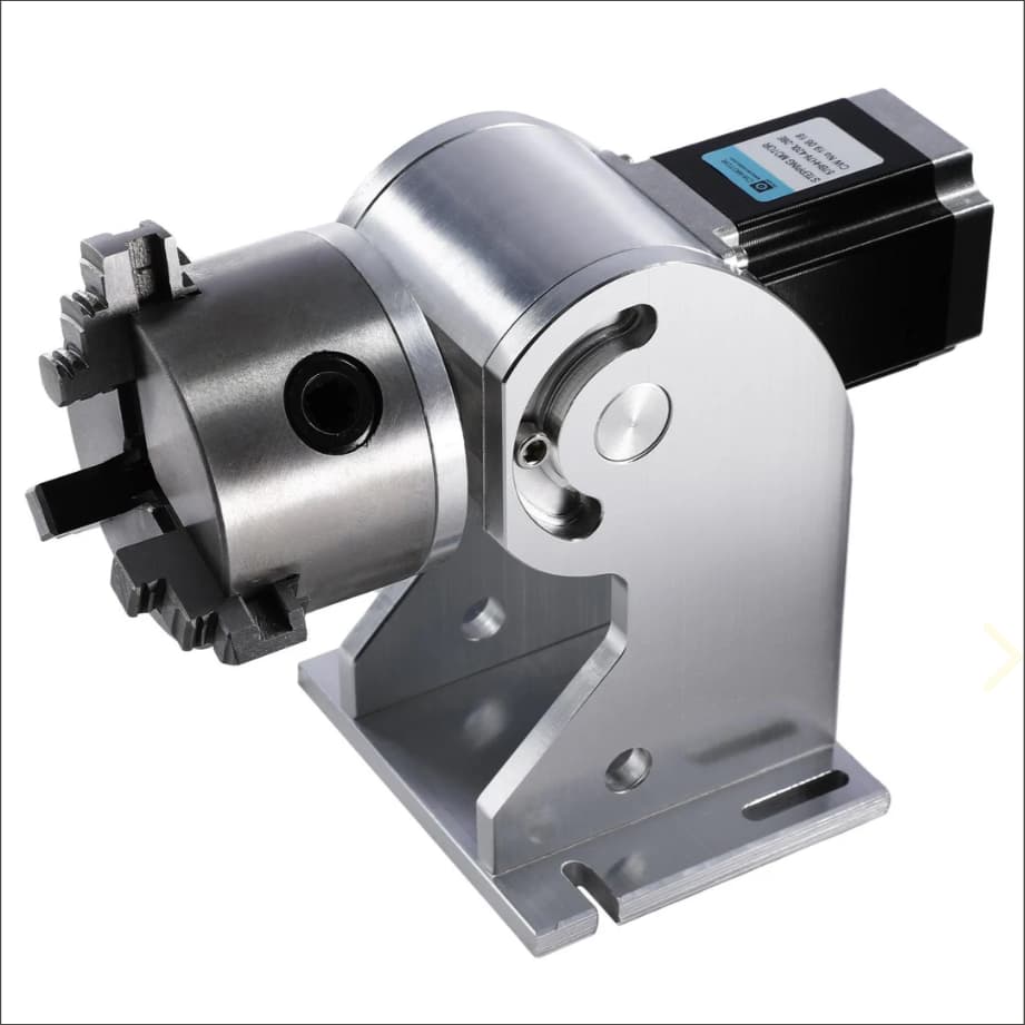

It’s driven by a Chuck-type rotary axis, like this one: https://ca.omtechlaser.com/products/80mm-rotary-axis-lra-6000-00
I removed the chuck and built the jig to bolt on to the flange the chuck mounts to.
The galvo laser being used to do the marking uses Repeat Marking in LightBurn, and Variable text, to increment the jig as well as update the names on the card from a .csv file.

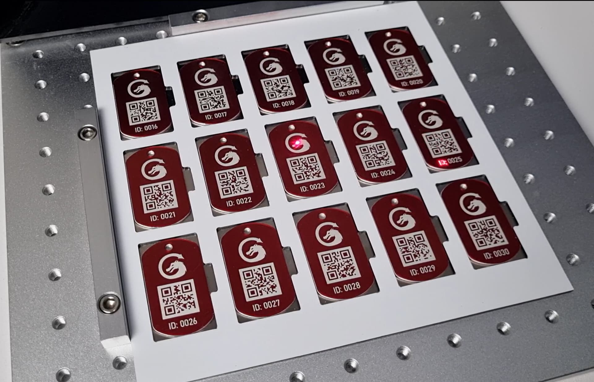

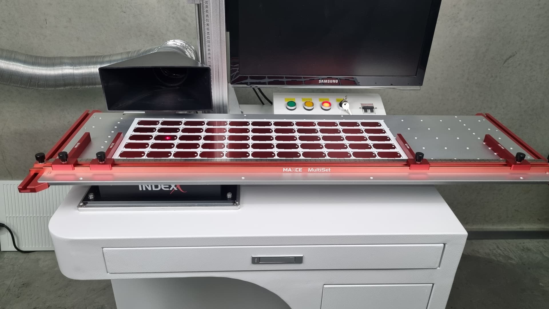

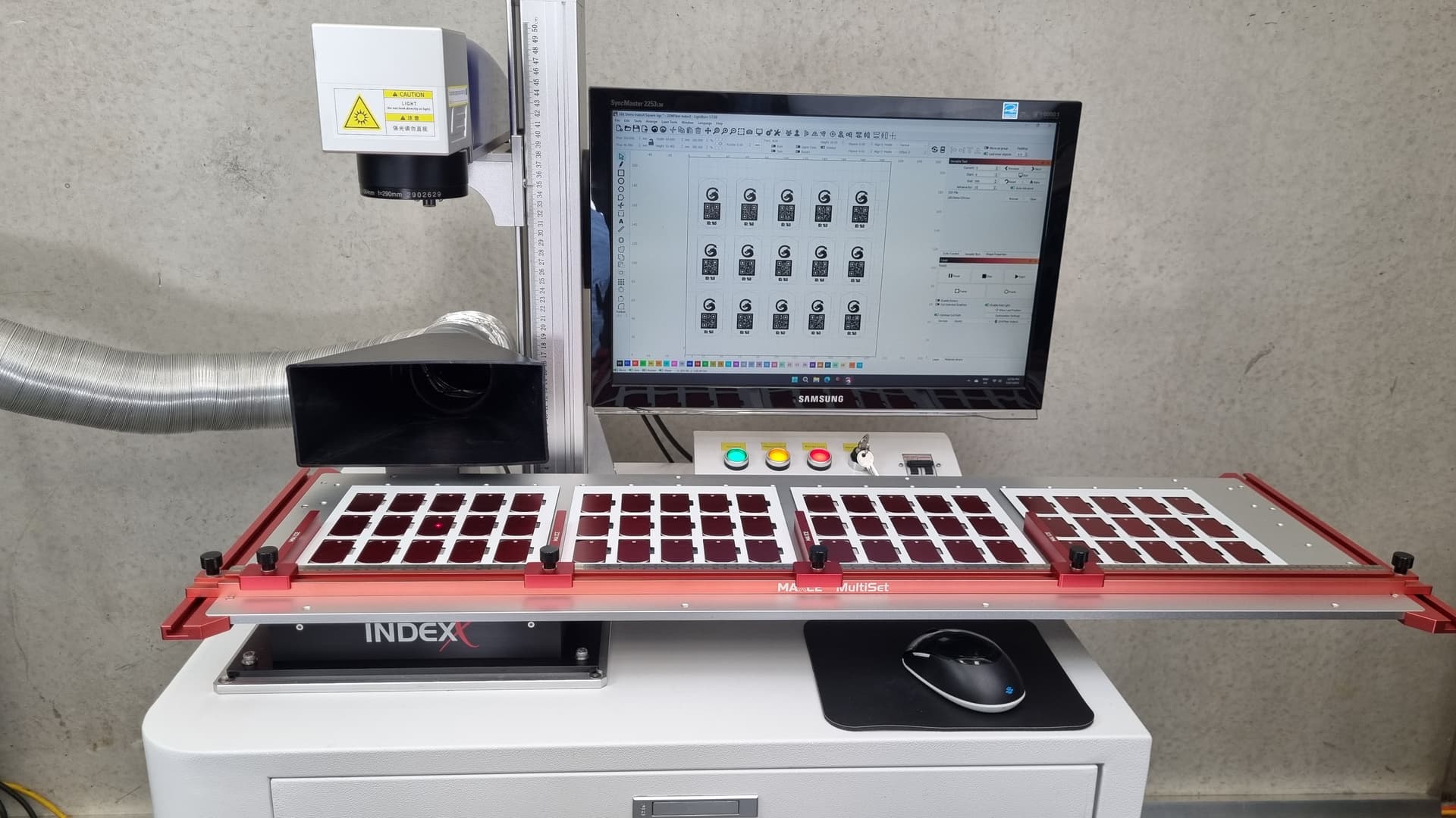

A 20 or 30W galvo fiber laser with a 200x200 area lens, and an IndexX slide attachment would be well under 10k. Use two large interchangeable jigs/trays so you can fill one while the other is marking.
This setup would give you similar capacity to the co2 gantry with the detail and speed of the fiber galvo on aluminium.
The talk I gave recently on batch production marking at LBX would have been perfect for you.
@BetaMax , that’s pretty slick. How is the image quality of the perimeter tags vs the central ones? I was wondering if the extreme angle of the laser at the edges would be enough to make a noticeable difference. Maybe that would only be a factor when deep 3D engraving.
The quality was the same across all the tags in the jig. As a general rule I try not to mark in the outside 10-15% of the lens area. Sizing the jig to the marking area and insetting the parts from the edge gives some buffer.
Breaking up the template so each tag can be framed separately is a good idea. It lets you check each tag alignment in the template matches up with each physical tag and make minor position adjustments in the template if needed.
