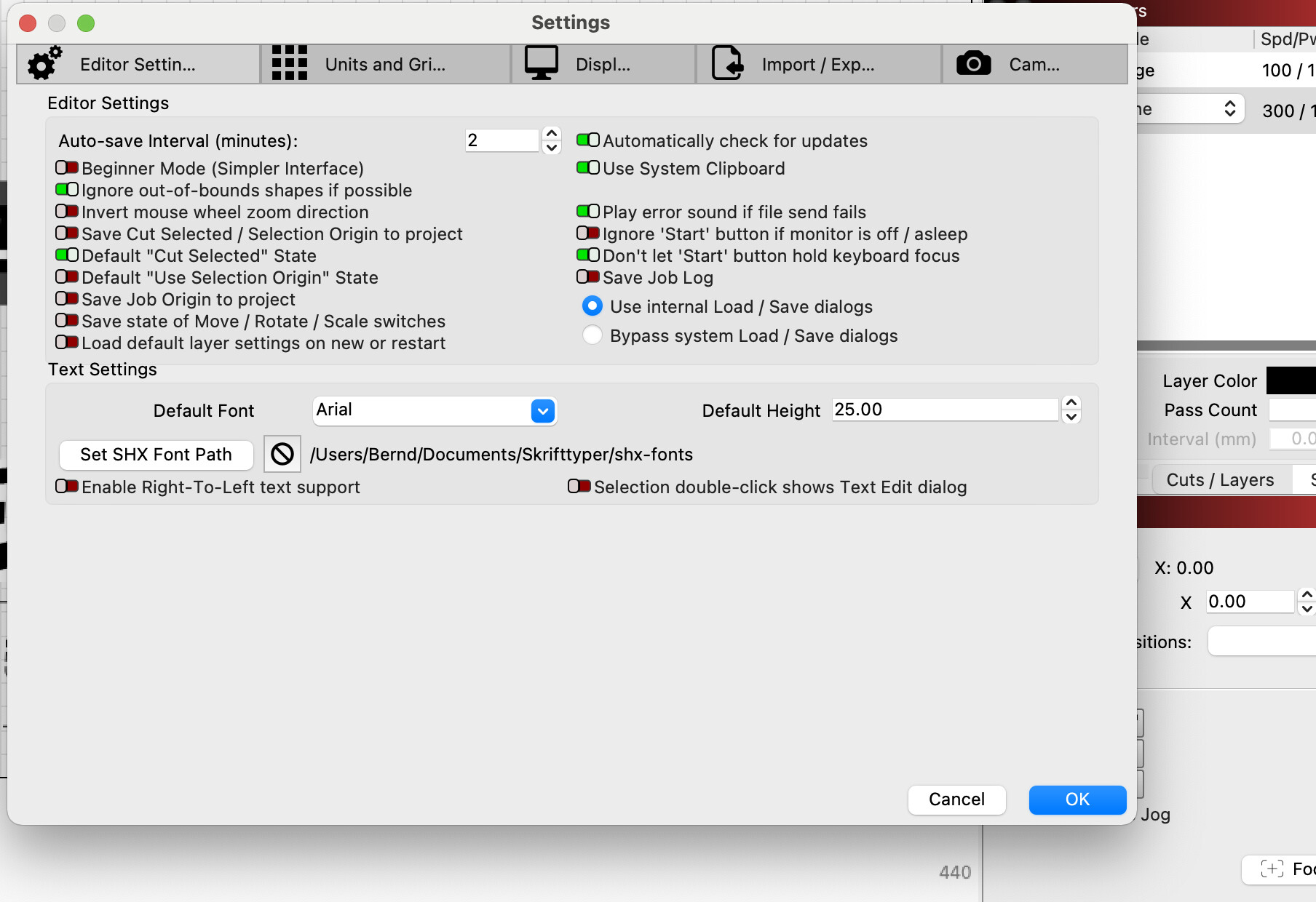

I fully realize that I may be doing something to cause this, but the biggest frustration I’ve faced is how LB handles layers settings when reopening a project or starting a new one. Because at times, it seems random to me.
I’ve had it change for some reason right in the middle of the project when I’m only using one layer.
How is it supposed to work?

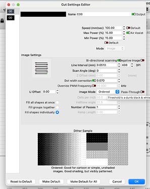

The values used by the Load default layer settings switch can come from several places:
There are a couple things worth mentioning here:
Units affect how settings are displayed, but don’t actually change the settings themselves. For example, if you change from mm to inches, it’s possible for the speed settings to change as well. 200 mm/sec could be displayed as 7.9 inches/sec. There is a “mixed mode” setting that only changes distance units, not speeds.
Default layer settings, if enabled, are per-laser, so if you have more than one laser configured, and have set layer defaults for each, the values for a new layer will come from the current laser profile.
If you have never specified any defaults, and have “Load default layer settings” enabled, you’ll get LightBurn’s built-in defaults per layer (100mm/sec, 20% power)
If you have that toggle switch disabled, layers are just “the last thing you set”. This can be either a blessing or a curse, depending on how you work. If you load someone else’s project file, it’ll overwrite your layer values, and stay that way until you change them back.
Be sure you Open project files, not Import them. If you import a file (File → Import, or the Import button on the toolbar), it pulls in only the graphics, not settings. If you open a file (File → Open) then it reads the file along with all layer settings.
