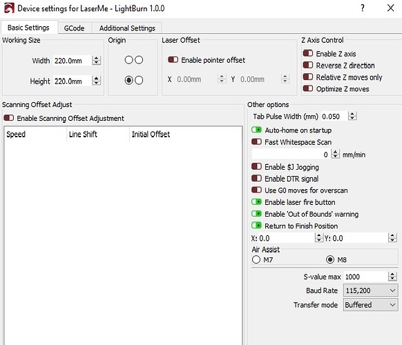

Buongiorno.
I will review your post. You can attach images by dragging into the edit window or by pushing the icon that looks like an up arrow.
It seems like you’re nearly there.
Can you try:
G10 L2 P1 X-215 Y-215
That should have you at 0,0 for origin and home. I’m curious why your top right isn’t getting to a full 220 or at least 215.
Let’s see after you post the Device Settings.
Thank you,
it worked!!!
Now x,y 0,0. -215 is probably the only number I didn’t try.

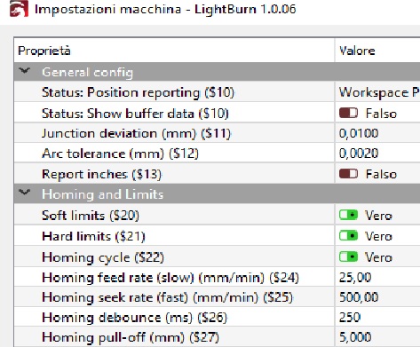

Anyhow, here is the picture. Pls note that the word “Vero” means True, and “Falso” False (of course)
I’m going to bed now. Here it’s 11:15 p.m.
Tomorrow I will re-do all operations you suggested and let you know. Thanks again so much
Also, I was looking for Edit->Device Settings… not the machine settings. Or push the gear icon on the toolbar.

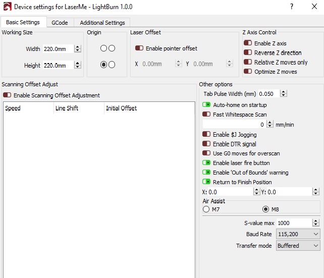

Good morning,
here is the screenshot
Actually it’s strange: the vertical move (Y) is right because my maximum span is 210mm. More than that the laser would hit the limit switch.
In the X direction, the maximum allowed (by LB) distance is 215mm. Actually I could go easily to 250 without touching the limit-switch but if I try to move the laser to 220 mm, that is the limit of my working area, the laser doesn’t move and an alert message pops up saying that the motion target would exceed the machine travel.
These set the X, Y, and Z travel in GRBL. You will need to adjust these if your actual bed is larger than 220x220 mm.
In this case you should consider Y axis at 215 since you are losing 5 mm in the homing pull-off in $27.
This is because you have soft limits on $20=1. When you change the Y travel this will be fine. If you can go to 250 then probably set Y to 255.
Take a backup of your current configuration then run in Console:
$130=255
$131=215
Change working size in lightburn to 250, 210.
It’s possible that your offset will be wrong after that. Check current position after homing.
