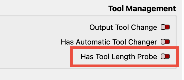

So until this is figured out it’s best for you to disable the tool length probe in MillMage and not use that feature:
I have disabled the tool length probe in Millmage. Full of anticipation, I tried to start the job only to have yet another error!

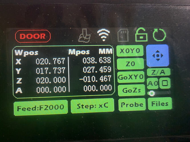

The probe moved up from 0 to the position shown stopped there and alarmed with the door error shown on the controller
Restart and rehome the machine and try again.

It’s actually done something at last!. I didn’t have the door firmly in place.
Thank you so much for your patient help throughout. Hopefully, I should be able to start using it…
