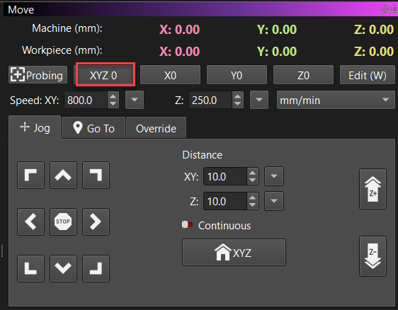

when you 1st start machine do you home , in the move tab what are the machine and workpiece numbers showing
can you take a screen shot of the below and upload so can see what yours ar showing
check the below make sure they match what your machine is meant to be

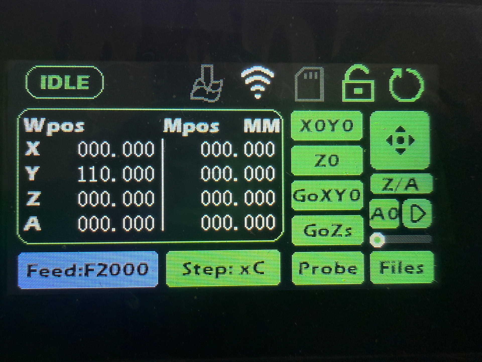

Yes I do home so that I am starting from a known position, here is an image from the offline controller

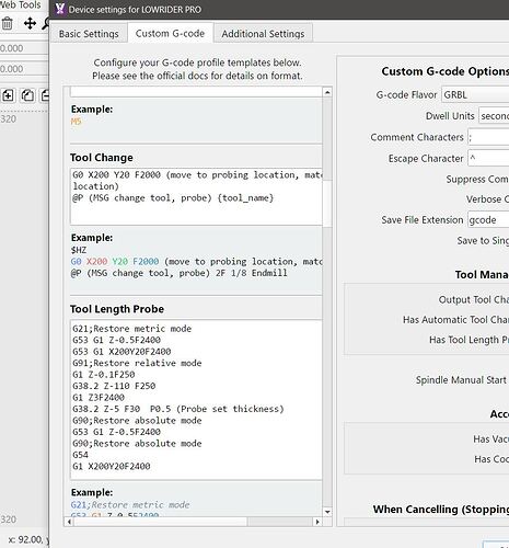

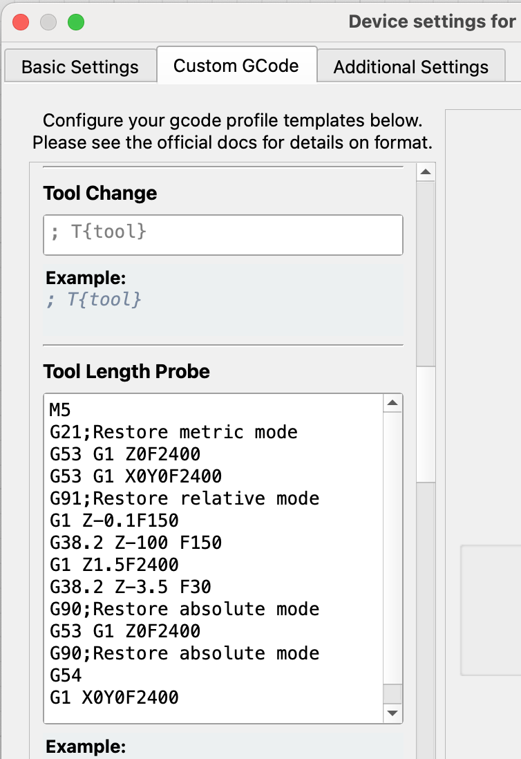

for some reason the the custom gcode screenshot doesn’t display above, here it is again;
The bottom line is telling your machine where to start from.
deleting that line may cause issues it did for me when i first deleted it , say if you probe from x300,y0 set it to that.

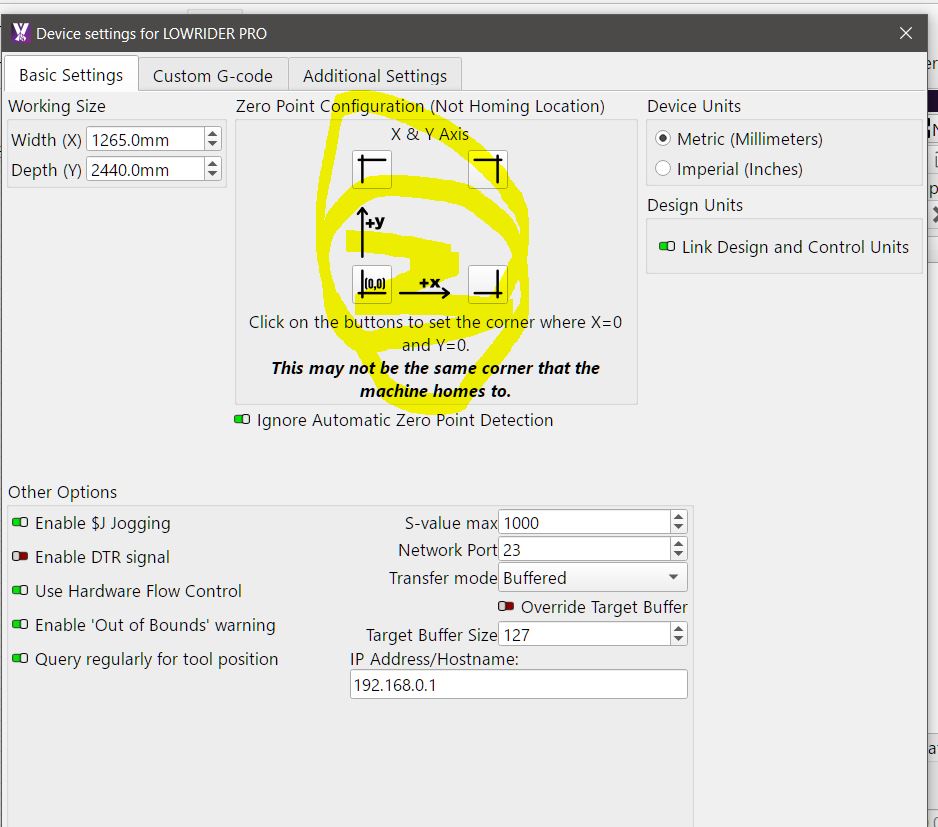

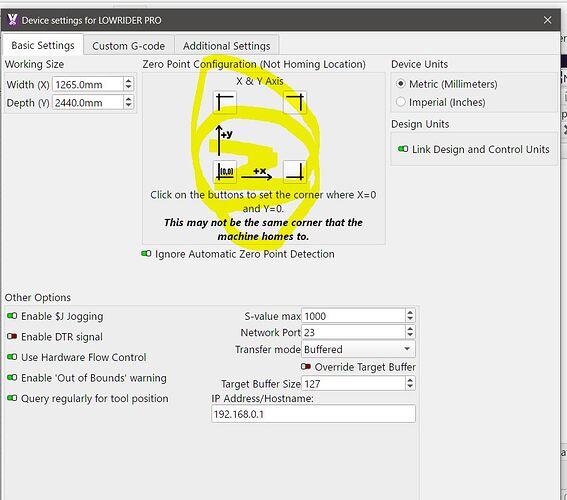

you say image from the offline controller ? is this photo of led screen on the machine itself or from another software, is that your home position ,
is home left front, if so change your xy axis in device setting screen to match left front you have it left back
So, I need to edit Tool change similar to yours but with my parameters for tool probe position which are x 147.3 and y 108.4…?
Sorry for any confusion with my image it is the LED display from the machine itself and yes, that is the home position.

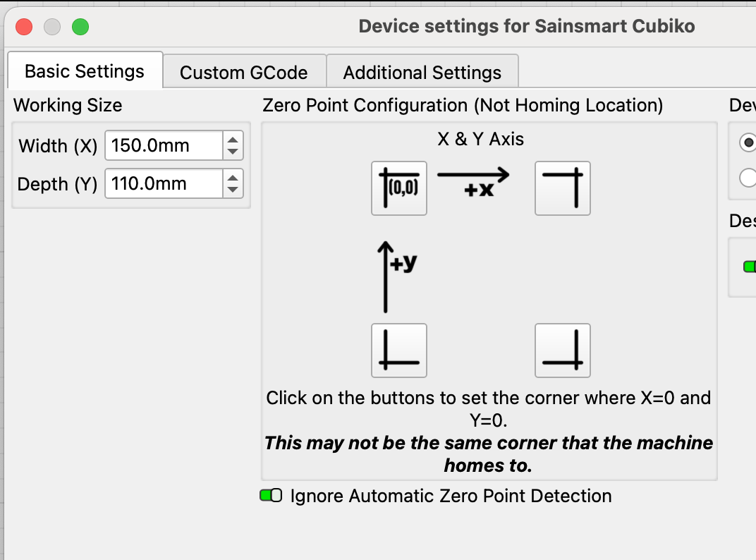

Home is left front. I am confused because I changed the xy axis from the front left to rear left in the belief that is the XY 0 for the workpiece, is that not correct then…?

I agree with @wanderingtruckie about your zero point not being correct. The machine position in your post is showing as zeroed in X and Y, so if the spindle was sitting above the front left corner of the working area when that photo was taken - then the zero configuration should be set at front left.
I notice that photo also shows a -110mm Y axis offset, but I think that will clear itself if you rehome and then just use the ‘XYZ 0’ button in MillMage:

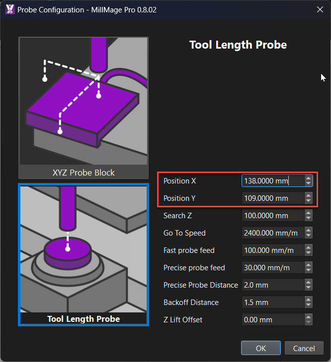

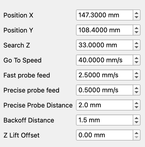

To setup your tool length probe, jog the spindle over where that probe needs to operate and then copy the machine coordinates you see in the top line of the Move Window to this Probe Configuration window.
The values for your machine should be similar to this but you will need to check:
I have changed the zero point configuration with no effect.

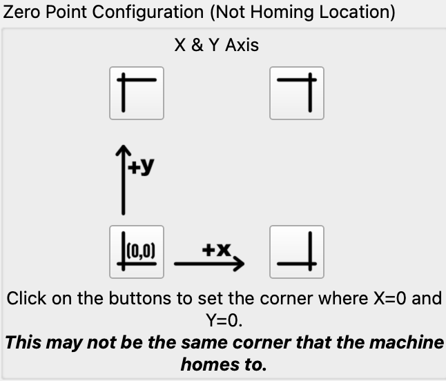

This is why I am confused about the zero point
I have jogged to the rear left of the workpiece and zeroed in on that point and set workpiece zeroes. The screenshot clearly states not homing location and may not be the same corner the machine homes to.
It is showing a positive +110 offset, not negative

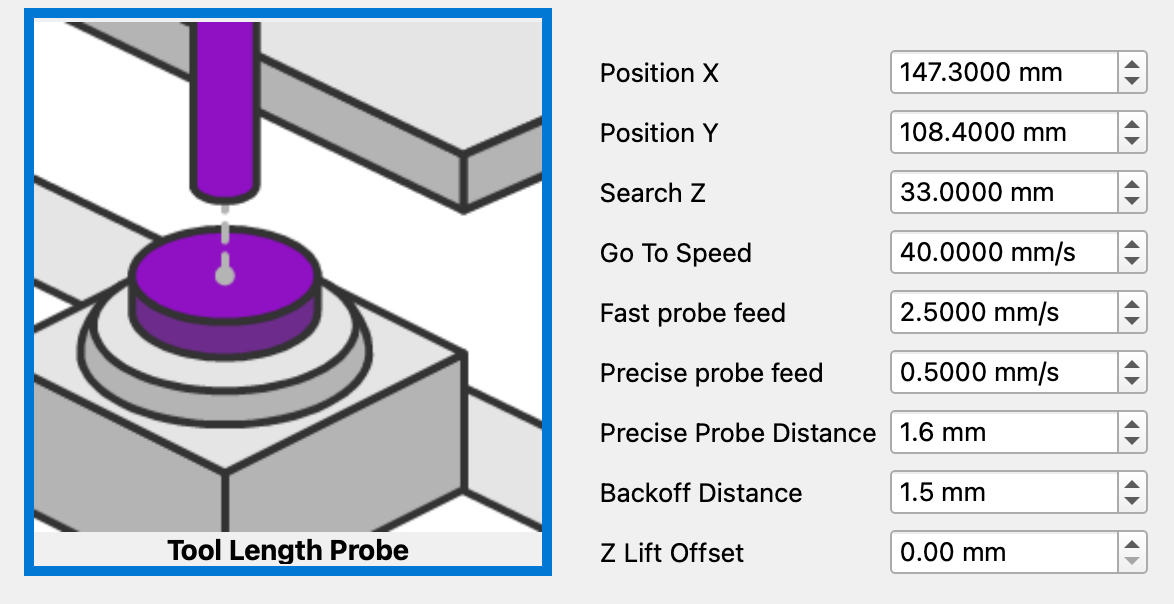

Regarding the probe parameters I have already set these, I took the exact location shown from the offline controller, namely, 147.3 and 108.4 and it positions itself correct, the problem is the Z axis, it touches but does not raise instead it alarms
What alarm do you see? I notice that your Precise Probe Distance at 1.6mm is only 0.1mm more than the Backoff Distance, it may need to be increased to at least 2mm to ensure the precise probe always triggers.

When I said moving the zero point configuration had no effect I assumed it would alter the existing project, it did not. However, I can now create a new project with positive XY values!
I think I’m beginning to see where I’ve been going wrong, as long as I use the same corner as the machine home, its using positive coordinates and I can now get it to frame in the correct position. The problem I now have is that at the start of the job I am warned the z axis probe is incomplete, I have set it up through the offline controller and I am happy with it, I tell it to ignore it but it doesn’t it tries and fails to do a probe.

You either need to increase the ‘Search Z’ if it does not move down enough to make contact on the fast probe, or increase the ‘Precise Probe Distance’ if the second slower probe is not making contact.
The probe is definitely making contact with the plate but it instantly and consistently alarms it does not raise at all. These are my current parameters;

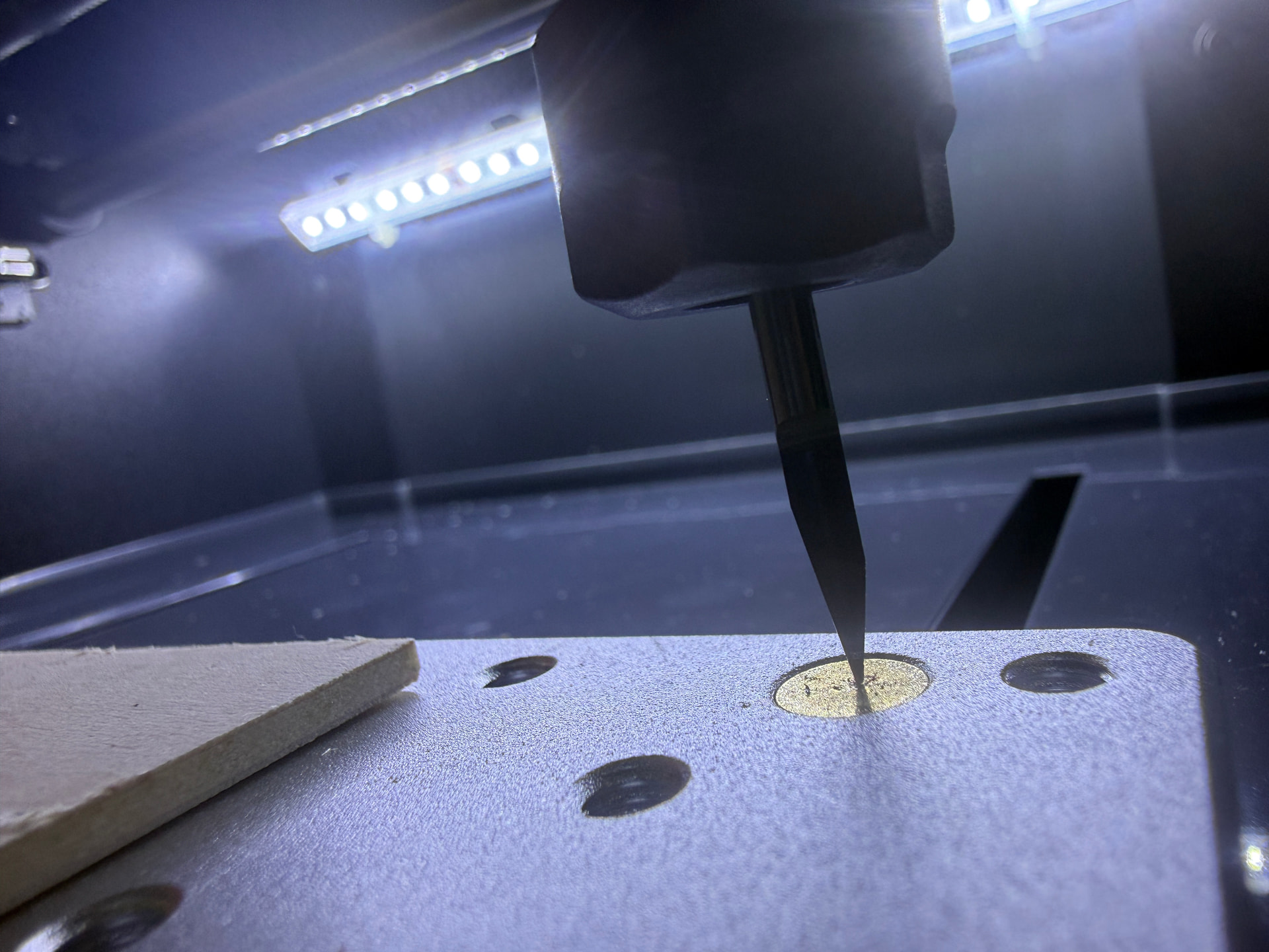

Is there a wiring clip you need to connect to the tool & workplate to ensure the probe contact completes an electrical circuit? or is the tool physically pushing on a switch?
The machine physically pushes on a movable plate switch. Here is an image of it at the exact point where it touches and alarms.
Temporarily change the Backoff Distance to 10mm and the Precise Probe Distance to 12mm.
When the fast probe starts, if you physically push down that switch with your finger does the tool stop, lift 10mm and then start moving down slowly? And then if you press the switch again does the probe finish?

I’ve tried twice without success, it does not stop it caries on down to the pad and alarms. The alarm this time is different though;

That’s more like a limit switch, perhaps thats the failsafe if the electrical circuit is not made? Are you absolutely sure no wire is needed?
it works exactly as it should using the offline controller and results in a precise z location…
