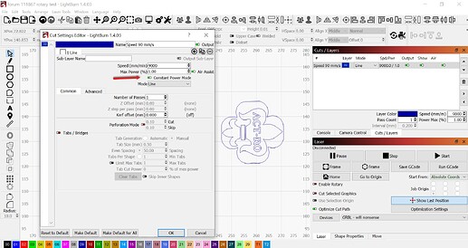

Neje 4 Max 4 axis. Selecting the A axis, it burns at the end or at the beginning of the line
If you click on the layer you’re working on the Cut Settings Editor comes up with the Cut Settings.
Turn off the Constant Power Switch and click OK at the bottom.
