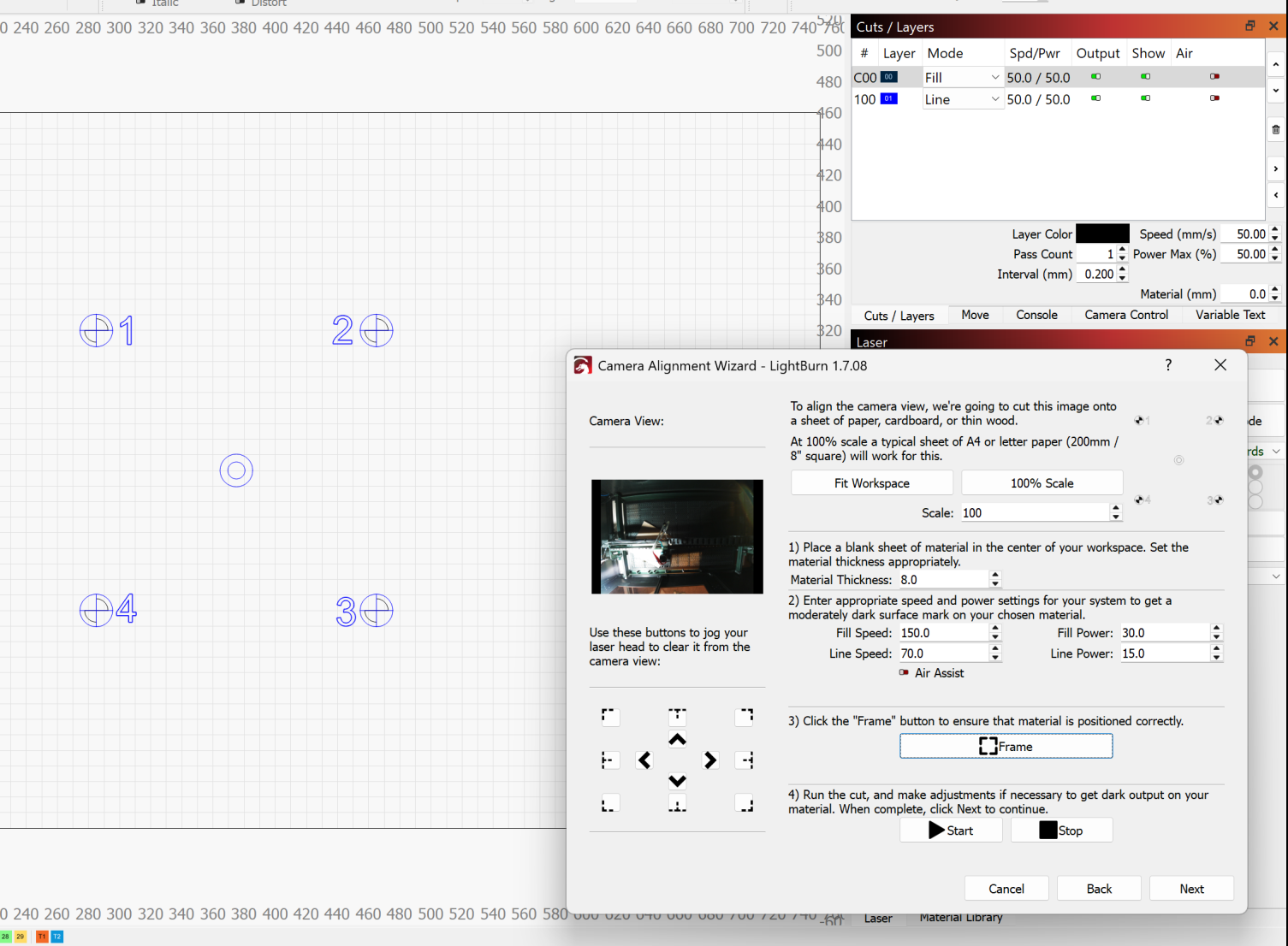

Setting up new Neje 4 Max to use camera for detecting material not working. LightBurn Camera Alignment Wizard doesn’t adjust the Z Axis when modifying material thickness, resulting in Laser nozzle not focusing correctly and crashing on top surface of material (6mm corrugated cardboard).

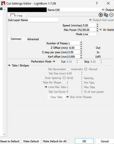

  2. Verified Z height works for setting material thickness in Cuts / Layers

  4. Tested multiple Material Thickness variables (6mm, 10mm, 15mm). All result in laser starting from the same Z height and hitting the surface of the material (only when using camera alignment wizard).
  5. Cuts / Layers pane shows the speed, power and thickness for the Fill and Line cut list, but these also don’t update to reflect the modified speed, power, thickness values in the alignment wizard (visible but not editable in the background behind alignment wizard pop up window, which leads me to believe there is something wrong with the alignment wizard…)

I think you have a fundamental misunderstanding here. The camera function does not care about the material height. It is not possible to use a camera calibration with multiple material heights. The camera is calibrated to a specific height (the height you set the laser head to before starting the wizard) and nothing else. The material height setting in the wizard is only for your information, I think.
Just focus the laser on the material and then start the wizard. If you change the material height ever, you need to do the calibration again. If you change the height often, it makes sense to save each calibration to a file such that you can reload it easily. The calibration can’t be used anymore if anything of the setup changes (material height, camera height, position etc.).

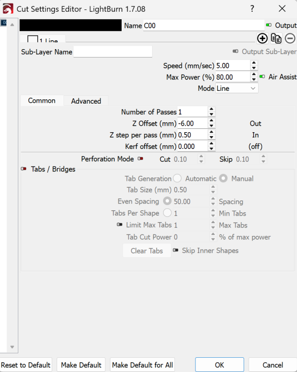

There is no homing sensor on the NEJE. The way the NEJE works is (at least for normal Cuts / Layers) is to set the (negative) Z Offset to specify the target distance relative to the bed or honeycomb instead of a fixed or absolute value if it was a static Z height. For example in the Cuts / Layers menu setting the Z Offset for -6.0 raises or lowers the laser head (at the start of cutting) to account for the material height plus any variance for defocusing the laser if desired (which can be helpful for moving the focus point IN or OUT). This is exactly what’s missing in the LightBurn camera calibration menu and why it may not be possible to do a calibration without going through a bunch of extra steps to temporarily re-baseline my current “relative 0” from the bed each time to account for the material. This would be alot easier if either
  1. LightBurn included a Z offset in the calibration menu
  2. The calibration menu allowed me to change the Cuts / Layers menu at the same time as the calibration menu
  3. The calibration pattern with the 4 rings and crosshairs could be added to a normal cut list and then focused separately in the calibration menu (skipping the step to create the pattern in the menu)
