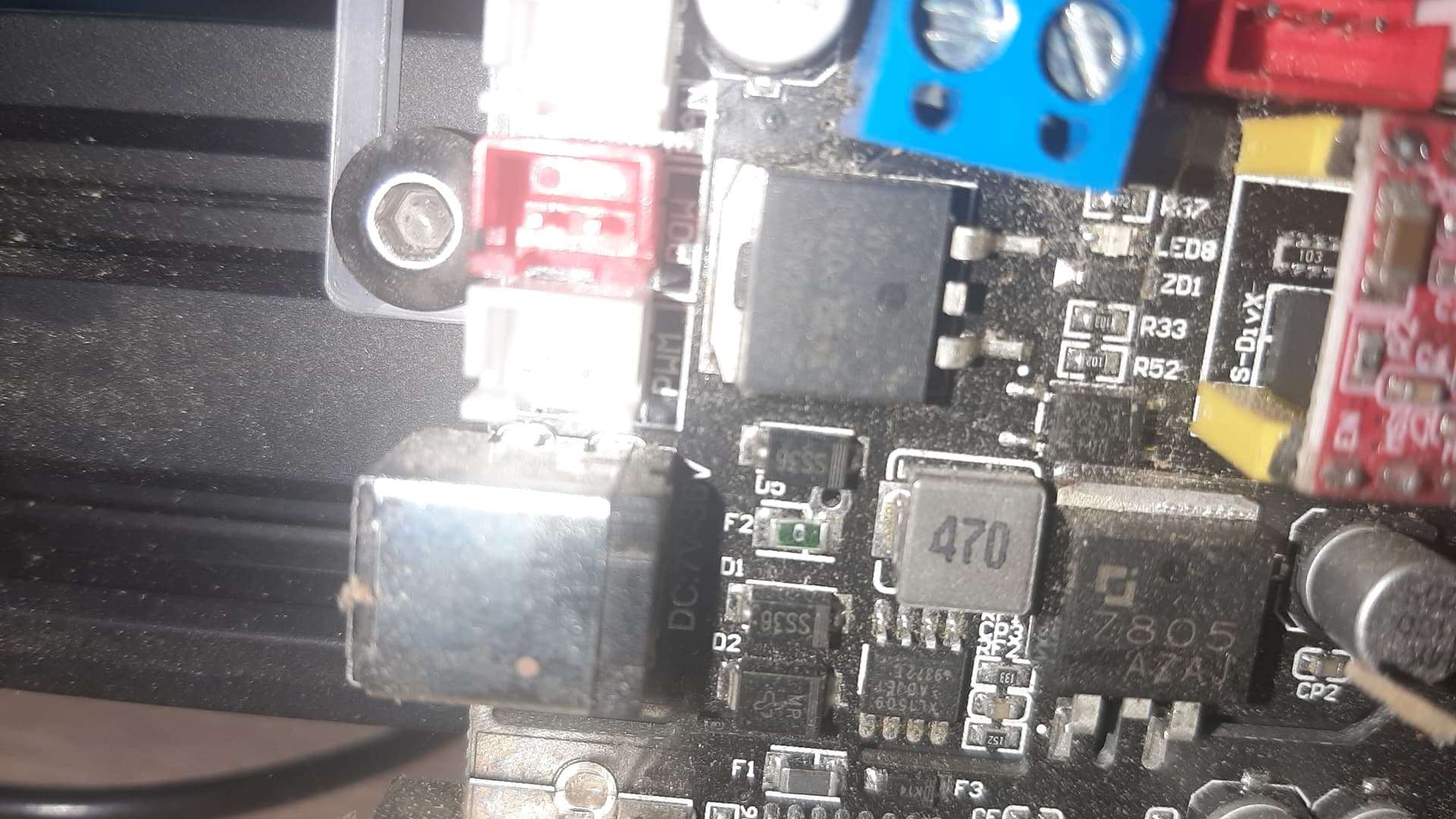

This is a picture of the control board being used. And I just realized that on the top left where you see White, red, white connectors, they are, from top to bottom, FAN, POW (power), and…PWM. LOL. It used the FAN hookup on the diode I replaced, but I’m about to go out to the shop and hook up the PWM. I won’t be surprised if the laser turns on just fine.
Plugging the TTL cable into the PWM on the board did not work. I plugged the old diode laser back in with it’s control board and was able to use the POW and PWM outputs to control that laser’s on / off function with the Fire button in Lightburn. So LB is definitely sending a signal but the NEJE A40640 isn’t interpreting it correctly. Or not even seeing it if the frequency of the signal is different.
In the past, I was did have an Arduino with CNC Shield v3 hooked up and was able to use that to get the A40640 to fire in lightburn, but couldn’t get the steppers to run correctly. I’m so frustrated.

Can you take a photo of how you’ve connected the controller to the laser module? Are you using the Neje adapter board?
Basically for the Neje, all it should need to see on the PWM pin is a voltage higher than 2.5V to activate the laser. It shouldn’t take much. It’s up to 12 V tolerant apparently so even putting up to 12V on the PWM should make it fire without issue.

I suggest you just go back to basics. For the moment, stick to the original controller.
Do you have a meter that you can use to validate PWM out of the controller? If so, check voltages at 0, 50, and 100% power. What do you read?
Also, can you take high quality photos of the wiring on the original controller to the neje adapter and then to the laser module?
I have a meter and tested the PWM and it was just under 5V and didn’t change when I hit FIRE in Lightburn.
It’s one 4-pin connector from the Neje board to the Neje laser. It’s a 4-pin wire from the original control board to the Neje board.

The image I posted earlier of an identical control board is better.
The yellow/red 2-pin wire plugs into the white PWM on the main board, left side just under the red POW connector. Then, the stepper motor wires are plugged into the top of the board above the A4988 chips. I power it with a 12V 4A-5A power supply. It’s truly very simple, yet something is happening to the PWM signal. The PWM signal works on the old diode. Tested that again tonight, so I believe the signal is being lost or not interpreted correctly by the Neje board.
