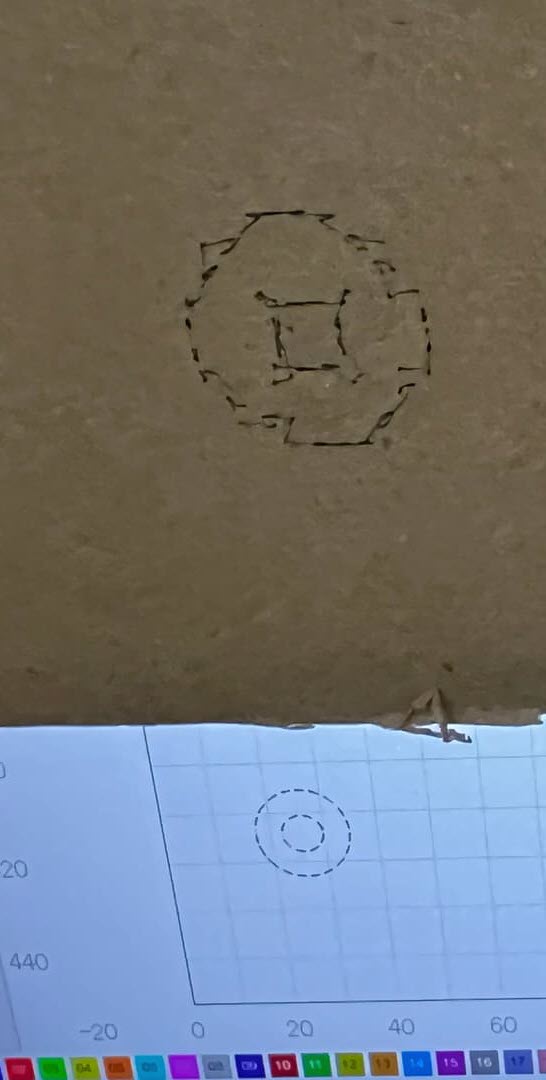

NEJE Max 4 I am using NEJE MAX 4. Transfer does not work properly
nice to meet you.

In NEJE_v6.5.3, it is transferred properly and works normally,
When transferring with LIGHTBURN, when transferring round characters such as “O”
It will be processed into pieces.

I’ve tried various things, but nothing seems to solve the problem.
Please help me. please.

This may be a behavior related to a failed license integrity check in LightBurn. Did you download LightBurn from the Official site?
Please Download the Free Trial to confirm that LightBurn will work with your NEJE Hardware.
There is a way to check to see if your computer has been touched by a corrupt version of LightBurn.
Please open the Hosts file and share a copy of it here. We are looking for references to LightBurn, Cryptlex and Github where the servers are rerouted to local.

Below is a cropped version of the image you attached in the 32nd post of your thread.
thank you very much.
I also posted on the NEJE forum.
Looks like it’s resolved thanks to you!
