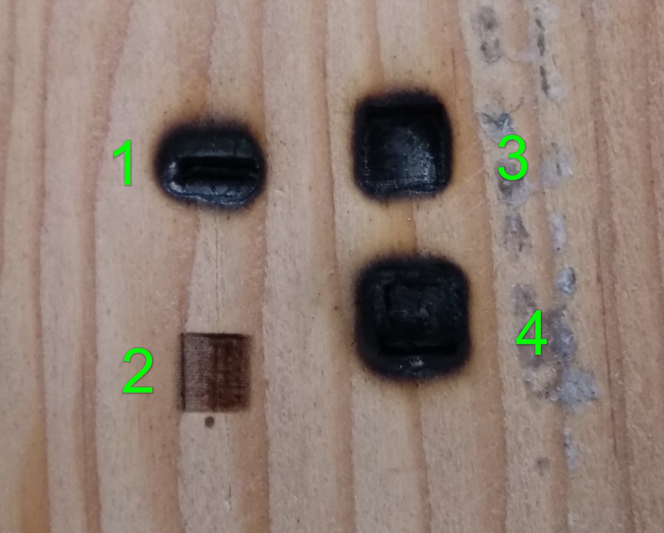

OK, so that was without the laser. Putting it together and running the same jobs again gave this:
  1. is Neje at 50% and 50ms. This is where I discovered it’s time rather than distance and aborted the job.
  2. is the Lightburn job using 50% power and 6000mm/m. This took 26s.
I wanted to use the incorrect speed for Lightburn to verify the effect of changing only that (and conversely, to check that other changes didn’t make any difference). Having got that out of the way…
  1. is the Neje at 50% power, 10ms per whatever. The job took 1:04
  2. is Lightburn at 50% and 250mm/m. This took 1:09 (there is an extra dot for identity). Looks pretty burnt to me!
So, user error. Cheque on the way to Lightburn, and thanks y’all for your help.
