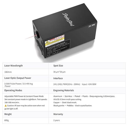

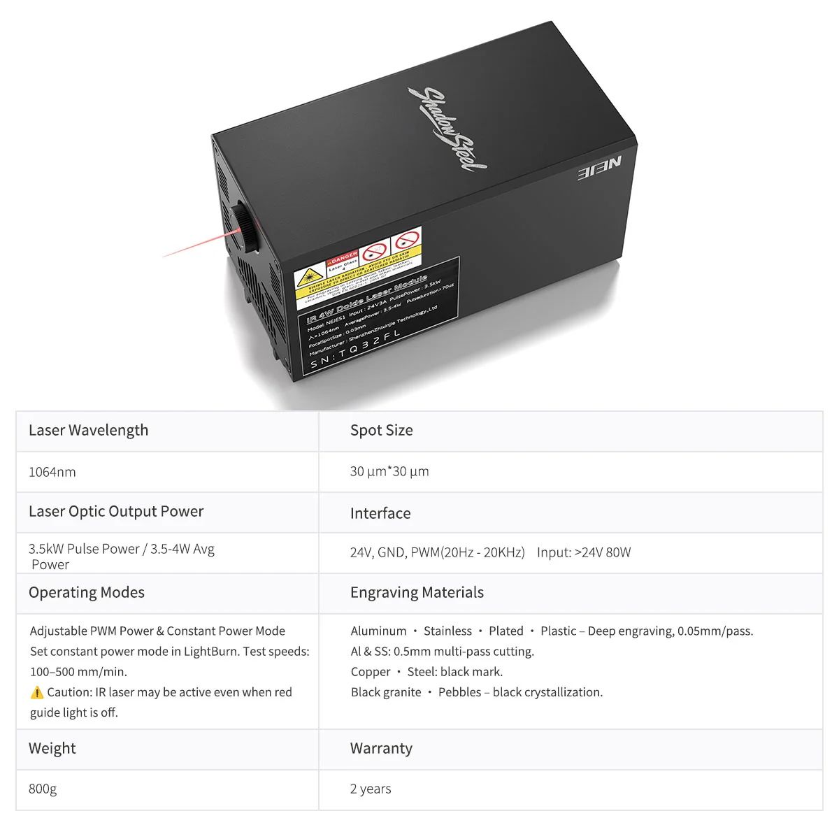

Things to consider:
  • The listed weight of 800 g, plus internal water, plus relatively stiff & heavy hoses, suggest reducing the X and Y axis maximum acceleration values by a factor of four will be prudent.
  • The weight may also require reducing the X and Y axis maximum speed values.
  • The hoses will require careful management to prevent snagging & dragging.
  • If it’s larger than whatever you’re using, reduce the X and Y axis maximum travel size.
  • Verify proper home switch actuation.
  • Verify the machine’s power supply matches its (presumably higher) current requirements.

and just seeing in that screenshot above - “Set constant power mode in LightBurn.” .. what might that mean? :thinking:
When all else fails, try the on-line documentation. Some prefer to examine this… :thinking:
If you read the docs, it states explicitly that your Ruida is not covered by this option, this shouldn’t show if it’s setup as a Ruida. Ruida computes overscan internally. You can force it by setting both min/max power to be the same.
This only applies to a scan type of operation, not a vector. A dsp will vary the power between min/max values when doing vectors.
Make sense?
