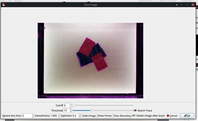

Grab it with the camera in the lid:
Tap the Trace button and dink around with the parameters to get a good outline:

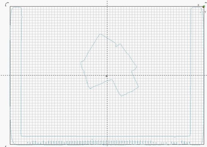

Which surely includes a bunch of clutter around the edges:
Ungroup the mess, select just the outline of the cow wrapper, Ctrl-Shift-i to select everything else, then tap Delete to get rid of the clutter.
