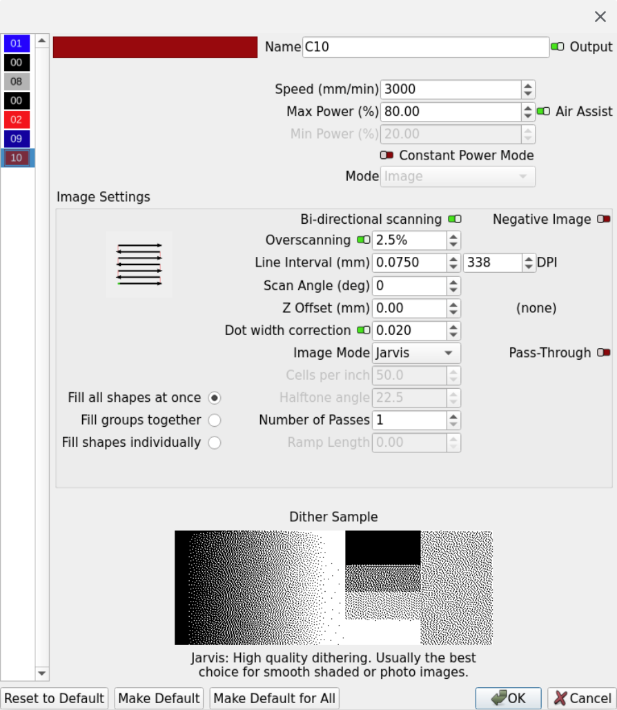

Took screen shot of image. Imported into LightBurn with image layer settings…
TiO2/glue/water mix (by volume 1:1:3) with few drops food coloring. Shake well, gently brush on tile surface… avoid streaks. Let dry for 30 minutes or more. Torch quickly removes any/all bubbles.
Lasered with Atezr P5 5W (optical output) diode laser…
Water cleanup…
Hope that helps.
– David

This is the TiO2 I’m using…
I, too, have always gotten better, more consistent, results with the flat-white spray paints… but using a new laser I was no longer getting good results; i.e. too gray and washed out. I had tried numerous raw TiO2 recipes before… but found very inconsistent, messy, and difficult to get a consistent coating. Finally, followed the recipe for the brush-on TiO2 “paint” I posted earlier and have been very satisfied with the results.
– David
Great explanation. You have a Diode laser correct?. Overscanning isn’t an available option for a Ruida controller.
Thanks. Yeah, I’m using a diode laser… right now, a 5W Atezr P5 machine. I really don’t think overscanning is much of a factor, one way or the other.
