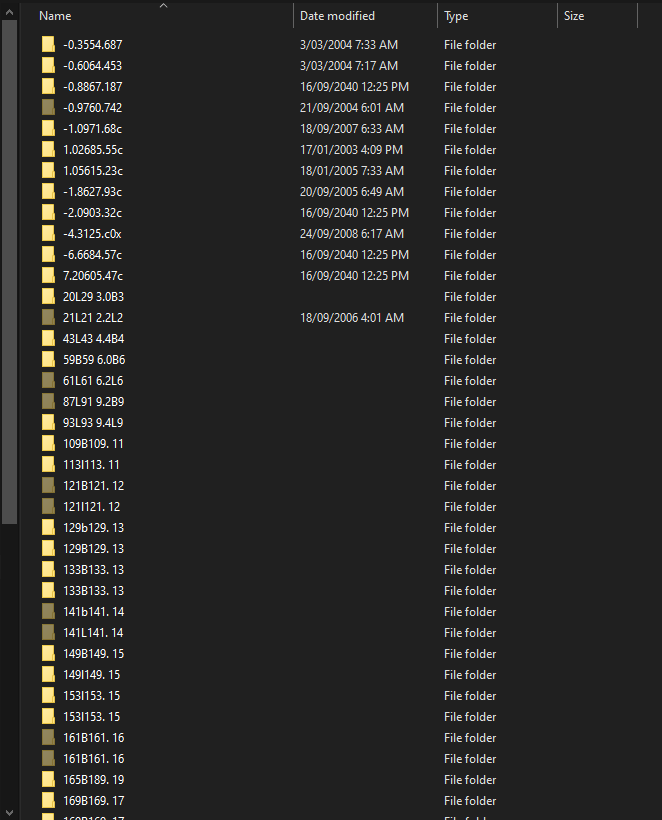

I have had a problem today when I saved a project.
I saved my Lightburn project to a 32GB tumble drive. I just went to open the folder to copy it over to another computer and sore a bunch of random files and folder inside the project folder I saved.
Check the date on them
When I check the folder property, Its saying its 628GB and has 560 file and 1996 folders.
Also all the files are Read-only
This is the first time I have come across this problem before.
Anyone else seen this before
Nonsensical timestamps and sizes point to a corrupted drive, not directly related to Lightburn.
Or possibly a virus.
It would be interesting to probe the drive with one of the flash drive testers:
I’ve used f3probe on many flash drives (including a fake), but it’s a Linux-only thing and I don’t know how the Windows testers behave.
