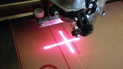

Today’s engineering day. Got fed up with single point position marker, which wasn’t functional to begin with due to rubbish wiring breaking in the chain of X axis (within 200 hours of machine operation). Decided its finally time to make a proper depth independent cross marker for my laser cutter. Lasers for my laser… Also upgrading wiring from pvc coated 10strand to silicone insulated 50strand flex wiring (i use it in my drone builds for low power distribution).
Needed another holder like the one that came with the machine (yellow part), but apparently its as rare as magic unicorn poop and no one, not even china, sell them. So, have to prototype and cobble something together myself.
Head mounting plate is also custom made by me (2mm steel) as original was made of 1.6mm chinese aluminium cheese. Added holes on the front for second line pointer to form cross mark, which is independent of bed Z position.
The pic with pointers powered up is just a test - alignment/focus and centering can only be done after i install the lot on actual head plate and laser draw an alignment pattern, so for now its just to see if it powers up. Using spare plate just to see how things fit.
If things work out the way i see them in my head i’ll have a bed wide material alignment tool, as honeycomb on my machine is not fixed so absolute positioning for registration is not really possible. Plus, being height independent it wouldn’t need head to be “in correct focus” for actual indicated position to be correct.
Amount of mods in my terribly “engineered” machine is increasing…
