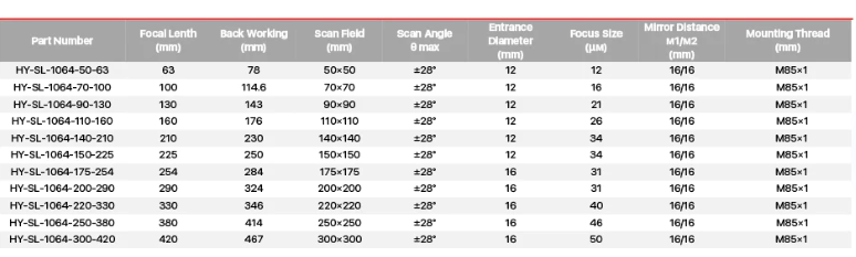

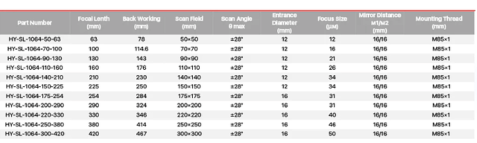

The field size is determined by your lens. You lens needs to be focused before you can calibrate it.
F-Theta lens Coverage mm2
F100mm 70x70
F160mm 110x110
F225mm 150x150
F254mm 175x175
As far as I know, when it frames for the lens correction, it will use the center of the field. On my fiber, I use the center of the work area and align to that.
When you do the 9 point correction, are you sure the lens is in focus? Generally speaking when you get near the edge of the lenses coverage, the distortion increases. I have 4 lenses and that’s my belief until someone convinces me otherwise.

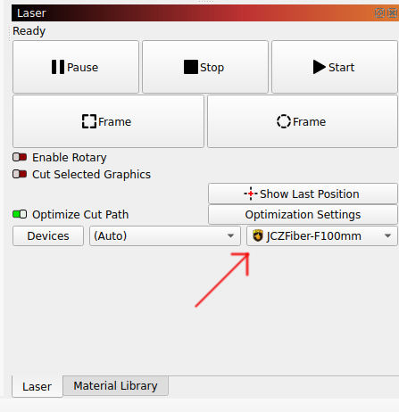

Did you import the configuration file, usually markcfg7 that came with your machine?
These not only have your lens configuration, but also the settings for your source. If you received two lenses with the machines, there should be two configuration files.
I believe these are not stored on the controller. I believe these settings are in your device setting within Lightburn. So they are associated with a specific device.
When I set up a new lens, I import markcfg7 file, then create a cor file for the new lens, or the 9 point alignment.
I’m guessing that you are not setting up a new device for each lens. Lightburn will handle these, but I like to export them to enure I don’t loose anything.
I have mine like this.
jack@Cat:~$ find ~/ -iregex ".*F.*\.lbdev"
/home/jack/mnt/dev-test/cnc/laser/fiber/device-files/JCZFiber-F420mm.lbdev
/home/jack/mnt/dev-test/cnc/laser/fiber/device-files/JCZFiber-F160mm.lbdev
/home/jack/mnt/dev-test/cnc/laser/fiber/device-files/JCZFiber-F254mm.lbdev
/home/jack/mnt/dev-test/cnc/laser/fiber/device-files/JCZFiber-F100mm.lbdev
jack@Cat:~$
When I swap lenses, I change to the associated device. This is for my F100mm lens.
Make sense?

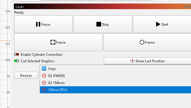

I am cloning the device / duplicating it and have importe the .cfg file for the device which for a BSL appears to be a file named LmcPar.cfg There was only one lens supplie with the machine, which had its .cor file and allowed for immediate setup. I have queried them about a similar file for the 150x150mm lens and they insist it is up to me to configure now and no such file exists.
Once the LmcPar.cfg file imports I do 9point correction…however, I can’t get the 9 point correction to correspond to the numbers it says it is showing.
It consistently draws me the 110mm lens config despite me changing the field to 150x150mm.
The closest I have got is by creeating a new device from scratch, setting field size immediately to 150x150, then importing the .cfg file. It still draws the incorrect dimension square for the 9 point galvo test, but instead of being 95mm its like 122mm instead of 130. Definitely infuriating :slight_smile:
The software shows the field to be 150x150, but the hardware is drawing the dimensions to 110mm ish settings…it is incredibly weird.

Hey Jack,
I am ensuring it is focused audially with the longer lens. The initial lens has worked flawlessly and I am using it now after backing out of the upgrade as we speak. The issue was merely I wanted a bit longer of a diagonal to accomodate carbon slides and a few floor plates that exceed 110mm in length quite easily.
I am importing the machine .cfg
Setting field size to 150x150mm
Focusing audially
Running 9 point correction (stuck)
On the STOCK setup, I imported the .cor file that was supplied and it was essentially plug and play for lightburn.
I agree it must be something with how I am confugiring it but I do not see a problem with my process.
