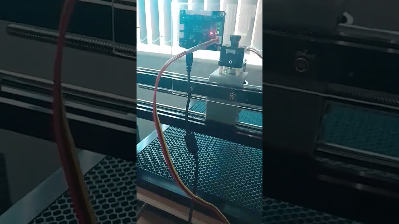

Got myself New Genmitsu CNC 3018-PRO Ver V2 (TODAY) doesnt seem i am getting enough speed 2 motors I have unattached the threaded rod from my motor and it makes the same noise like its struggling to go round

The 3018 Pro CNC with Laser option is a screw machine and is not capable of high velocities. The screws mean high torque, so the steppers will sound the same hooked up or not.
What you hear is the stepper noise produced by the power switching to the motors. This is not a quiet machine. When I high-speed (relatively speaking) jog the table, it makes a very distinct whine noise. While my 3018 Pro max speed is 2000mm/min, my belt drive S30 is 6000 and the SF-A9 is 20,000mm/min.

Its just not right i have never heard anything like it I will send u a video of the noise if it lets me never heard anything like it ,I don’t think its the machine it was working A1 its just with the New Board just at moment 1 problem after the other…

New board means setting all the GRBL parameters the same as the old board. Otherwise you get one problem after another. Do you have a copy of the old parameters.

I am convinced it is a parameter issue. I am pretty sure you can get the parameters from Sainsmart’s site. It is a Sainsmart machine?
Decided to look through some storage boxes as im moving soon and i found some old cables hey presto works or i say one did tried on X and Y runs smooth again i have to make second cable, so thinking i have 3 different type of coloured cable probably a lesson for myself Thanks a lot ![]()
