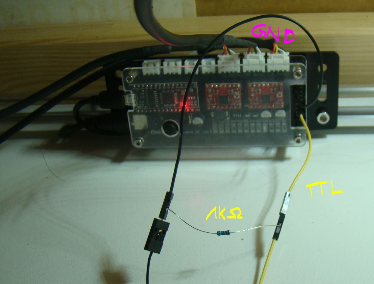

With the eleksmaker mana se 3.2 controller I have a OHM resistor between TTL and GND because otherwise there were burn marks… this prevents that.
maybe must be gone ? with the new laser.

Bild_2023-07-16_211240911

I don’t see why this would have been necessary. What burn marks were you getting? Is this between traversal moves?
Seems like to me this may have just been attenuating the signal but not clear.
I think for sure worth trying. Or at least sorting out the root cause for why that was necessary to begin with.
