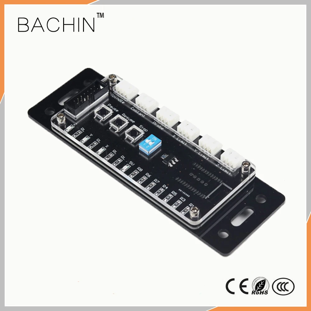

I think this might work
and have one in the post and hoping to use with this
to add limit/homing switch.
Thanks for the links, I really like that second product of the “support board for limit switches” Thanks!
You do?
As opposed to the $3 board that does the whole job as a full cnc controller with limit switches?
Do you guys measure functionality by howexpensive stuff is?

That 3$ board doesent do all that as it needs an arduino and driver, leads etc (i dont have the techy word as a beginner) and for a beginner it most probably best to stick with standard parts that you may be able to get help on rather than a unique system that you will have to figure out most yourself.

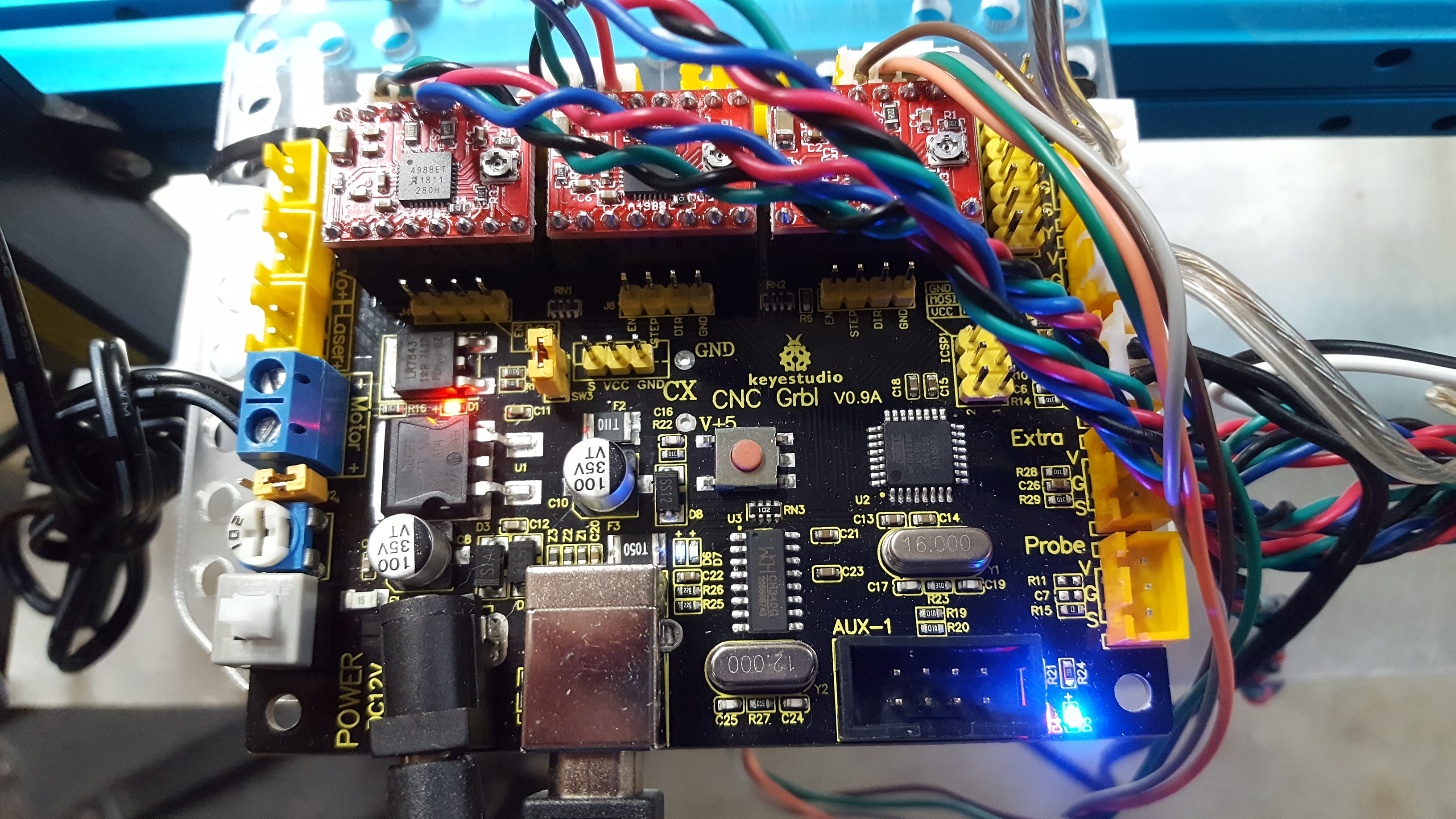

I have a diode laser VERY similar to yours. I stumbled across the “Ks0288 keyestudio CNC GRBL V0.9”. I use it with GRBL 1.1 and Lightburn. It’s got all the standard i/o, plus an extra Y output for 3D printers with 2 stepper on the Y axis. Its just an ATmega328P, and drivers cost extra. But it works great, is easy to connect to. Ks0288-2
Hi Eddie!
Its funny, I stumbled on the same board and have been using it on my Chinese laser. Although my plan is to build a enclosure for my laser. Have you added your limit switches yet to your board. If you have can you let me know how you set the new engraving parameters in settings? Any feed-back is appreciated. Thanks.

Sorry for the late reply, I meant the insert connections to plug in my limit switches. Sadly my board came with out instructions or diagram of these connections. Thanks for any feedback.

For those limit switches, I use 4. 2 on each axis. The two for each axis are wired in series through the normally closed pole and common on the switch. To the right hand side of the board, there are five yellow, 3 pin JST connectors. Top right is X, pins are 5v, ground, and signal. If you’re just using a passive micro switch, just hook to ground and signal. It just forms a loop through the two switches for each axis. First connector is X, second is Y, third is Z. Forth says “Extra”, and the fifth connector is the Z probe. Does this get you started? I wired my own connectors and so I cannot tell you for sure a plug and play option, but you should be able to buy limit switches with JST’s on them, rewire them in series, or get the JST crimp kit with tool.
