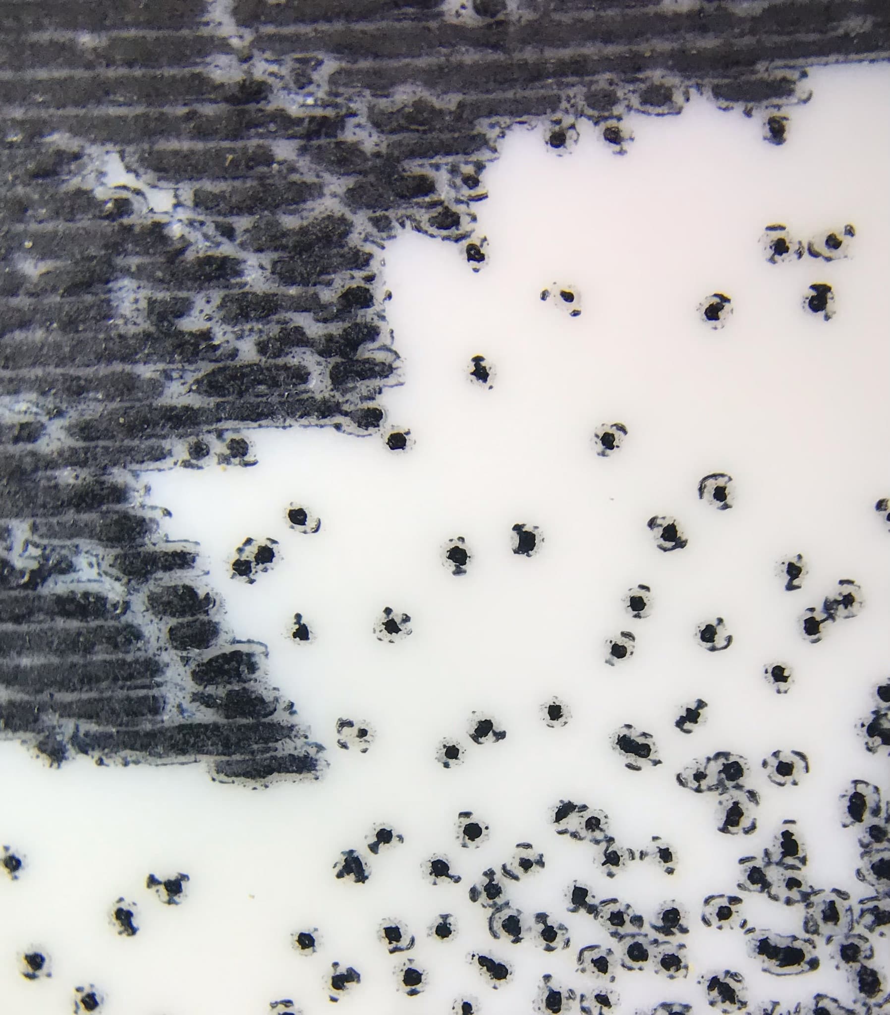

Got a microscope lens for the phone. Closeup of the dither dots. Individual versus a more solid black area.
Thats cool! I like how it looks like a little explosion at each dot to mark the ceramic.
Nice photo… I have a microscope that I look at damage from the laser quite often… it’s the best way to ‘see’ what it’s really doing.
It’s nice to see the continuous black…
I have problems with this kind of consistency.
Thanks for the photo…
