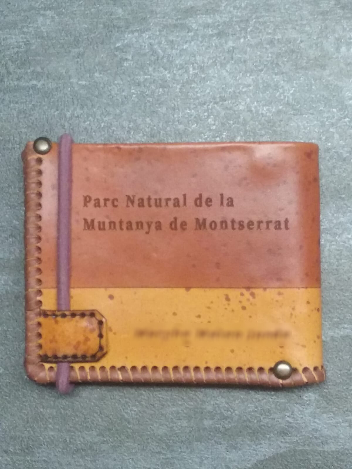

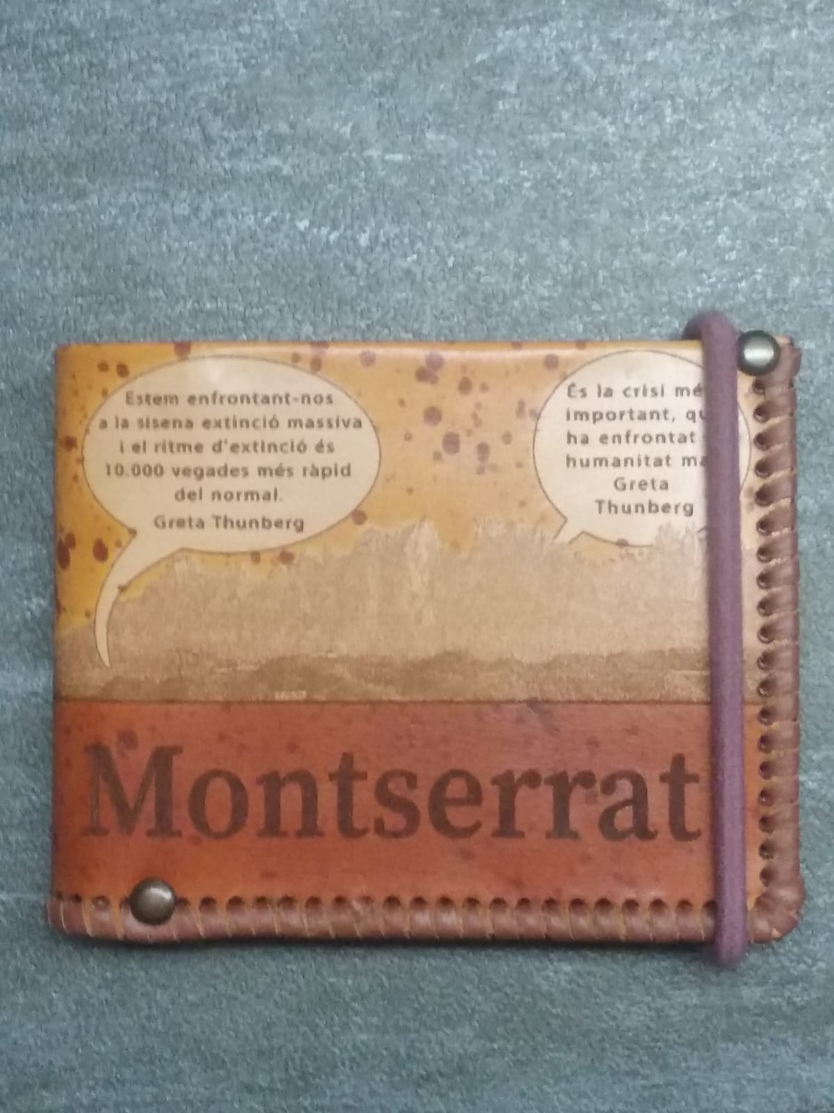

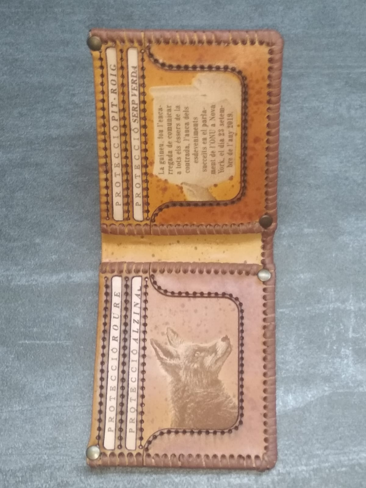

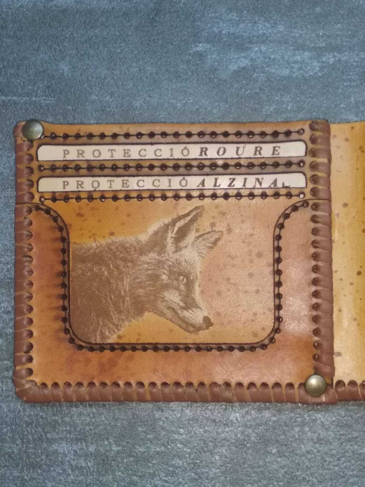

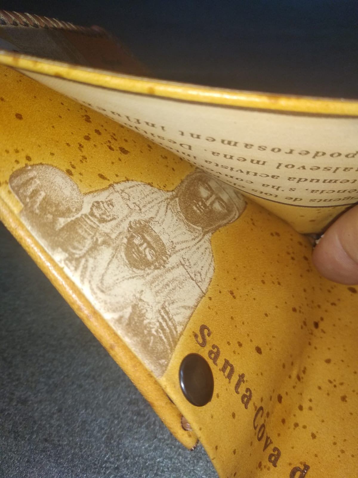

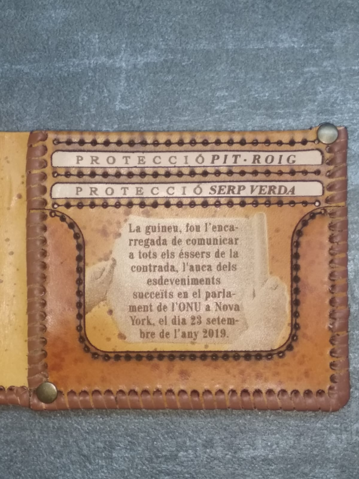

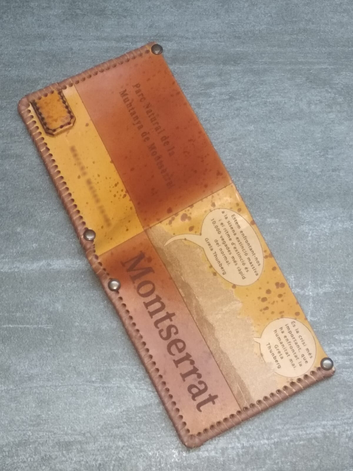

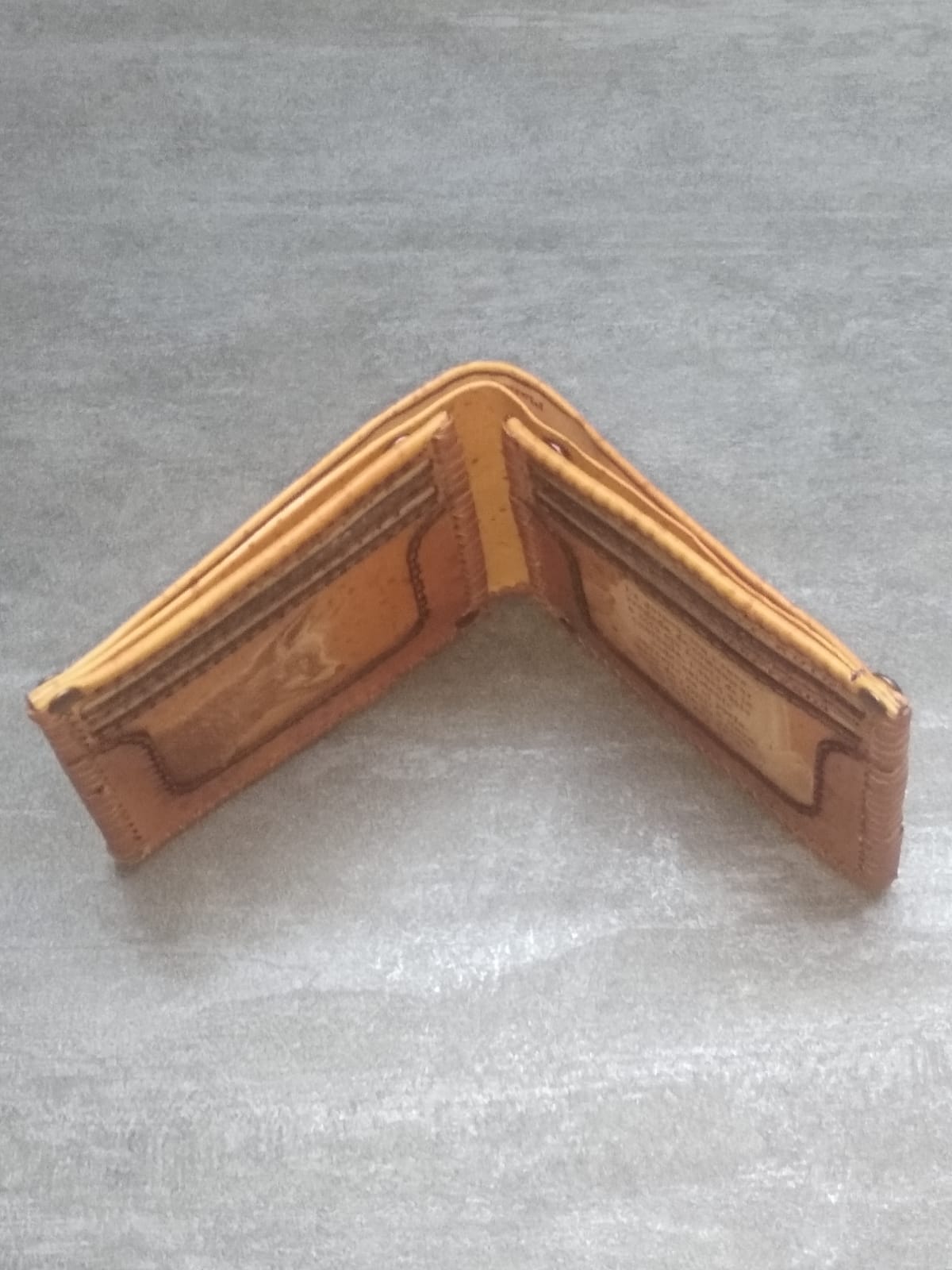

Hello everyone, fellow enthusiasts,
I’ve created a new wallet model and would like to share some photos with you.
This wallet features nine functional compartments and is made from twelve pieces of vegetable-tanned leather, rivets, thread, four pieces of RFID-blocking technical fabric, and a hair elastic that serves as the closure.
This closure system offers great durability, since snap fasteners tend to wear out over time. In this design, the snap that holds the elastic is only used occasionally, instead of being opened and closed hundreds of times a day as in other models. Moreover, if you prefer a wallet without a closure, you can simply remove the elastic.
The piece has been engraved and cut with a 10-watt NEJE diode laser, dyed using an airbrush and brush, assembled by hand, stitched with nylon thread, and reinforced with leather strips that include a nylon core on the back, along with four rivets to ensure strength and durability.
