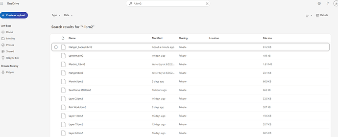

As you can see version 2.0.02 has been creating and saving files to OneDrive. Version 2.0.03 fails to create a new file on OneDrive. So File.Create fails in the new version for some reason.
I do not use OneDrive for the reasons in posting #2, but that image shows what can happen. It appears your file could be local, but the backup is on the OneDrive. Lightburn expects the file and backup to be in the same folder.
In Explorer, navigate to *C:\Users\LENOVO\OneDrive\Documents\Tortugas\Laser* and see if your file is there. If it is not, open the backup with Lightburn and see if that is your missing file. If it is only partial, read Posting #2 again.

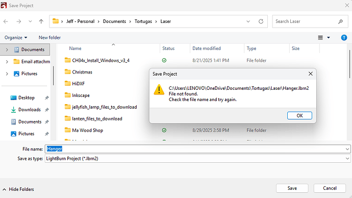

I’m not aware of any changes from 2.0.02 to 2.0.03, that could explain this behavior change.
The Windows error is peculiar: You are saving a new .lbrn2 file to Jeff - Personal > Documents > Tortugas > Laser
The error message states, that the file does not exist in:
C:\Users\ LENOVO\OneDrive\Documents\Tortugas\Laser..
I’d say, the better the programmer, the less obvious it is what OneDrive is doing here!
You could try saving it directly in this path
C:\Users\**LENOVO**\OneDrive\Documents\Tortugas\Laser\..

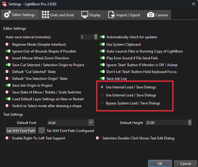

We don’t recommend using cloud storage providers due to the multitude of errors that can appear in ways like this. Save locally if at all possible.
You can also try going to ‘Edit > Settings’ and changing the Load / Save dialog to use external or bypass system, which may play nice-er with your cloud storage solution.
This seems to be the default settings for both versions. Does not work in version 2.0.03. When saving a new project the error states that it can’t find the file you are trying to create. Maybe you need a test case scenario that include a OneDrive user, since it is very popular to access files remotely.
Please show us the exact file directory so we can compare.
