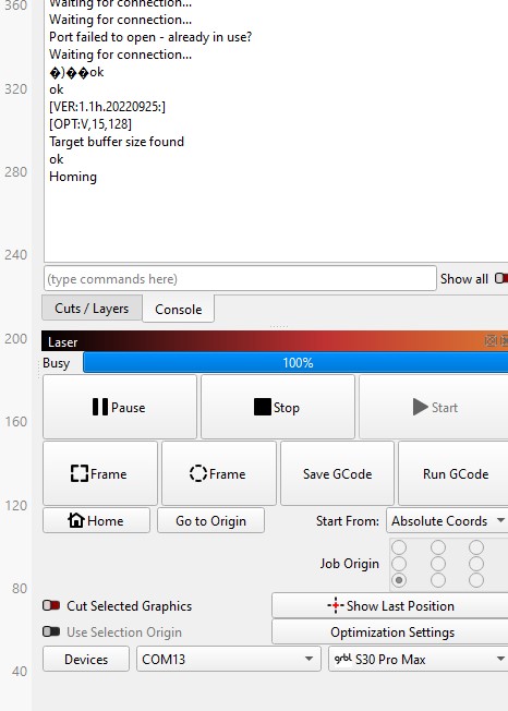

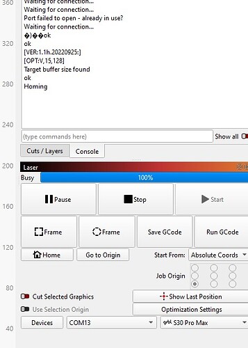

Evening anyone… Back again still no workie… Plugged the power brick into another wall socket but same supply line…
When I switch on the laser the Y axis starts to make a low clicking sound and will not home…
The busy Blue signal under the console window comes on and stays there until I use the Home button on the Move window and after that if I click anywhere on the screen the Home Busy signal comes on again…
I can’t supply a console c0se nothing is working there either..
I’m wondering (curious) if this is a power problem, I have no other 24v power brick to try without buying another one and waiting two weeks for it…
