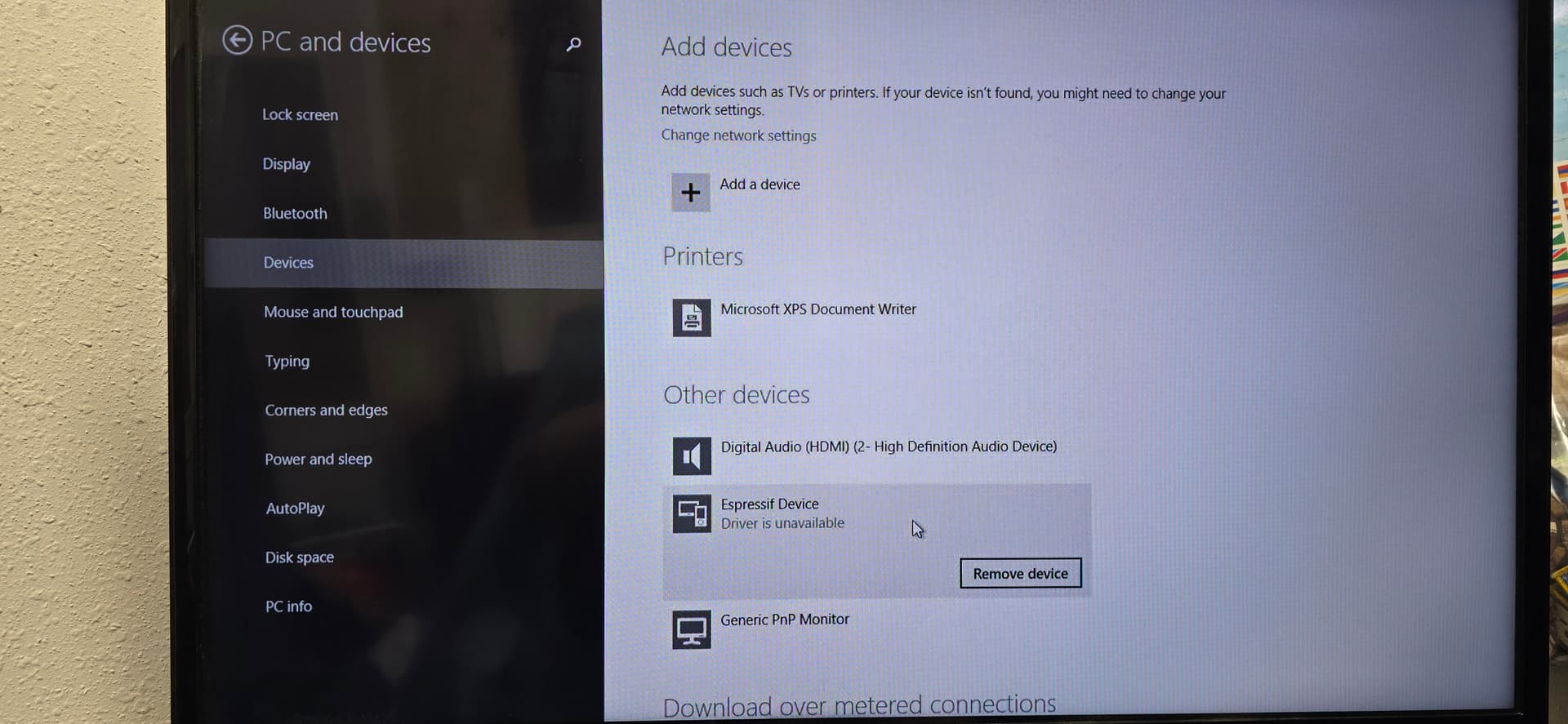

Can you take a screenshot of the device in Device Manager. That may help provide clues as to what driver is required.
Else can you provide a photo of the exposed board on the controller? A visual confirmation could also work.
Above is the device screen on my PC. When i turn the laser on this pops up and tries to find drivers then says “Driver is unavailable”.
Just to reiterate I am using windows 8.1
After i power on the laser I think I should be able to select the port its pluged into. However i dont jave any options as you can see in the bottom right corner.

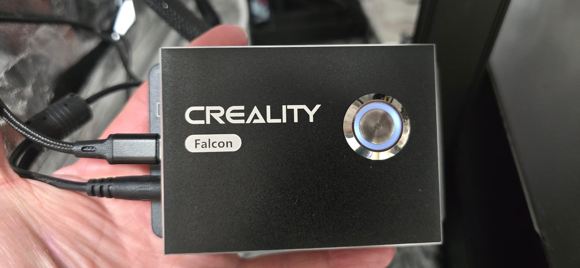

Above it the “controler” that is supposed to run the laser.
Note that the screenshot is not showing Device Manager but the information shown indicates that the device is an Espressif device. Assuming this is Espressif CDC Windows 8 does not provide a driver for that device.
I’d suggest following directions from Ortur for how to use Zadig to get around this:
OLM2 Pro - DRIVER WINDOWS 7.pdf
Some Ortur devices use the same serial chip and should work the same assuming again that your device is using Espressif CDC.
Take caution to follow the instructions very carefully as using Zadig incorrectly can lead to some hard to resolve situations.
I have now pluged in an old windows 7 upgraded to windows 10 desktop to the engraver. Everything started working as desined. I am still going to try the driver install recomended by berainlb. I would like to use the laptop for space savings. Ill update with the results asap.
Thank you. This 100% fix my issues!
