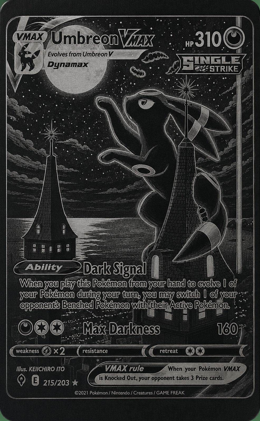

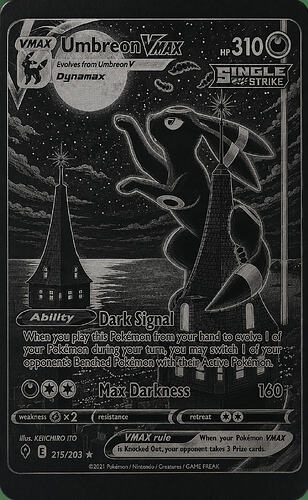

Hi everyone! I’m brand new to the laser engraving community and I’m learning how to use my AlgoLaser T-150.
I’m trying to engrave an image onto a black aluminum card measuring 2.06” × 3.24” × 0.01” thick, but I’m running into an issue where the laser seems to overshoot the material/work area instead of staying within the card dimensions.
I’d really like to understand why this is happening, rather than just guessing at settings.
I’m currently looking at using LightBurn or LaserGRBL/GRBL, and I’d appreciate advice from anyone experienced with the T-150 on:
  • :gear: Proper machine setup and calibration
  • :straight_ruler: How to accurately set the engraving area to 2.06” × 3.24”
  • :framed_picture: Correct image sizing and DPI
  • :counterclockwise_arrows_button: How to make sure the laser’s origin/position is correct
  • :fire: Recommended starting speed/power settings for a black anodized aluminum card
  • :laptop: Whether LightBurn or LaserGRBL would be easier for a beginner
  • :police_car_light: What could cause the laser to move beyond the edges of the material
Machine: AlgoLaser T-150
Material: Black aluminum card
Card size: 2.06” × 3.24”
Thickness: 0.01”
Software: LightBurn / LaserGRBL
I’ve attached the image I’m trying to engrave.
I’m not necessarily looking for someone to just give me settings—I’d really like to learn how to properly set up and calibrate the machine so I understand what I’m doing.
Any tips, tutorials, or advice from experienced T-150 users would be greatly appreciated!
