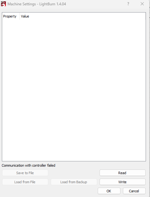

OK, I now have the lbdev file from a FB group. I was assuming I just load this onto the machine settings, but the option is greyed out in my latest version of the software?
I also tried in device settings, import, but this wants a different file type?
All good, found it. Just hope this works now :slight_smile:
You might have not noticed I added a link to the LB documentation about this part to my first answer, they show where you load it (I tried the same things than you before searching the doc…).

Wonderful, thank you. It all seems to be working as it should now. Just a case of fine tuning the speed and power settings. :slight_smile:
