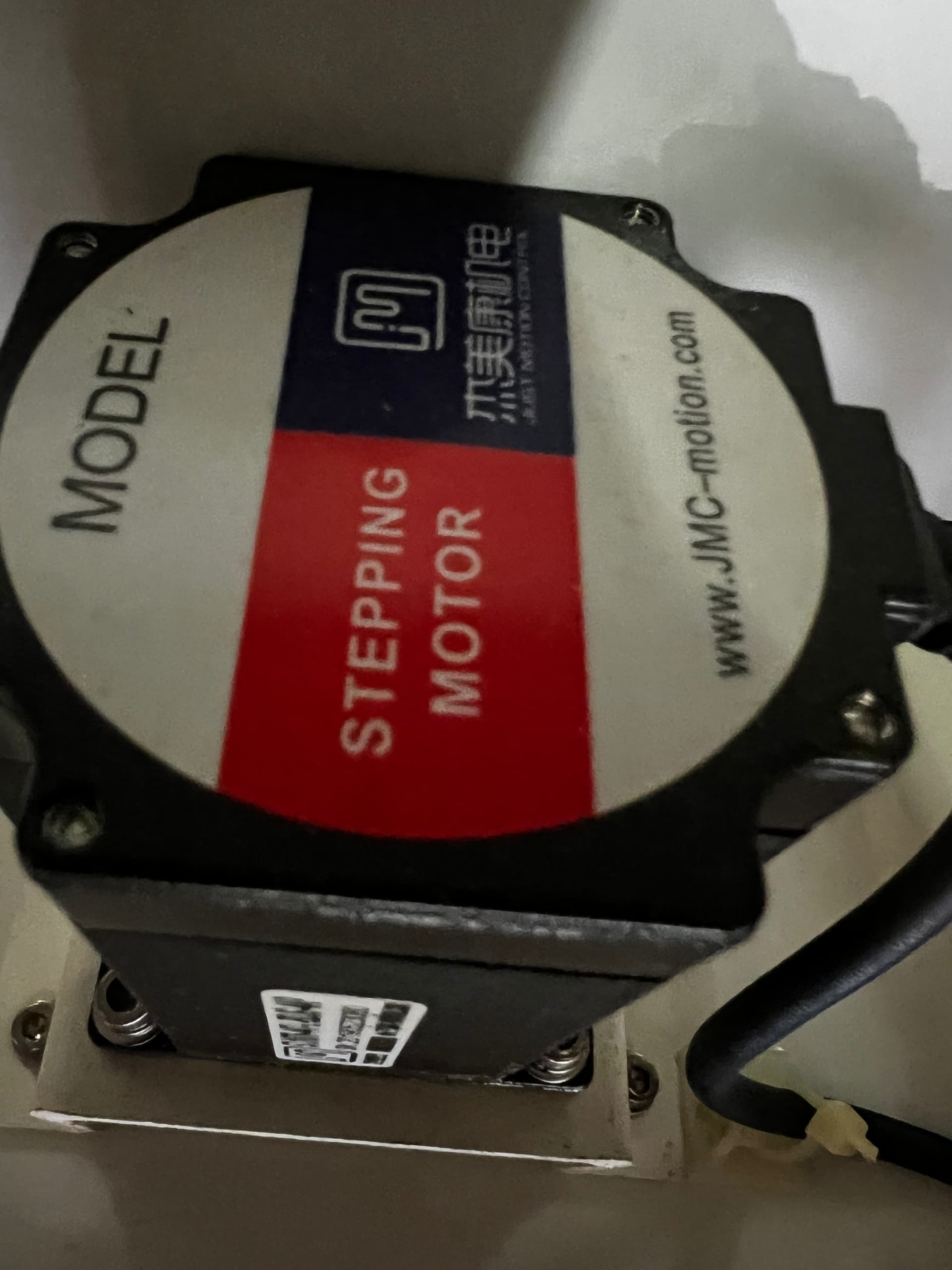

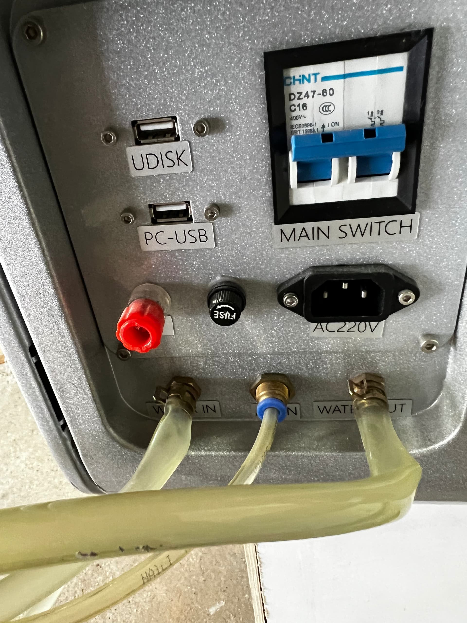

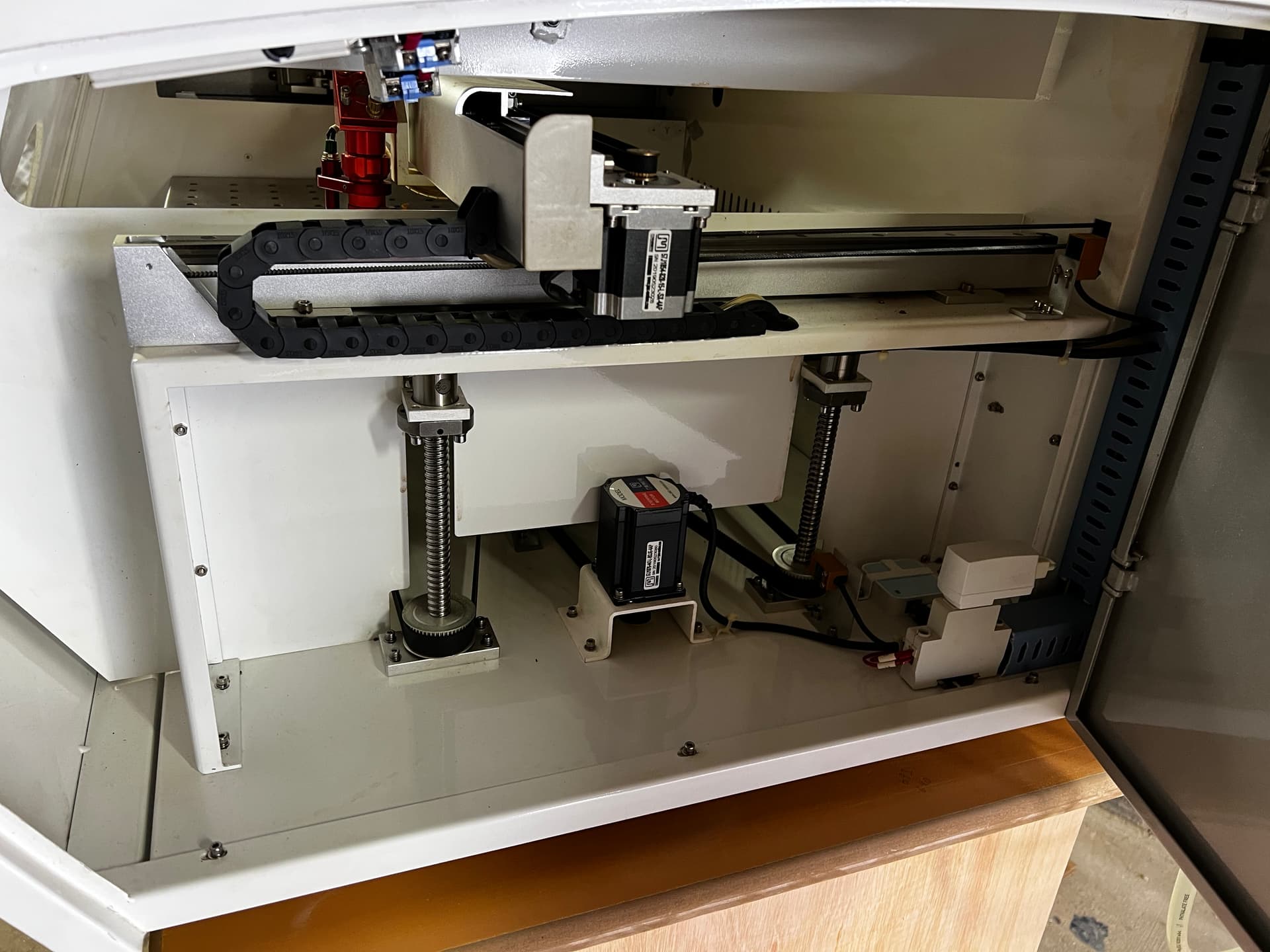

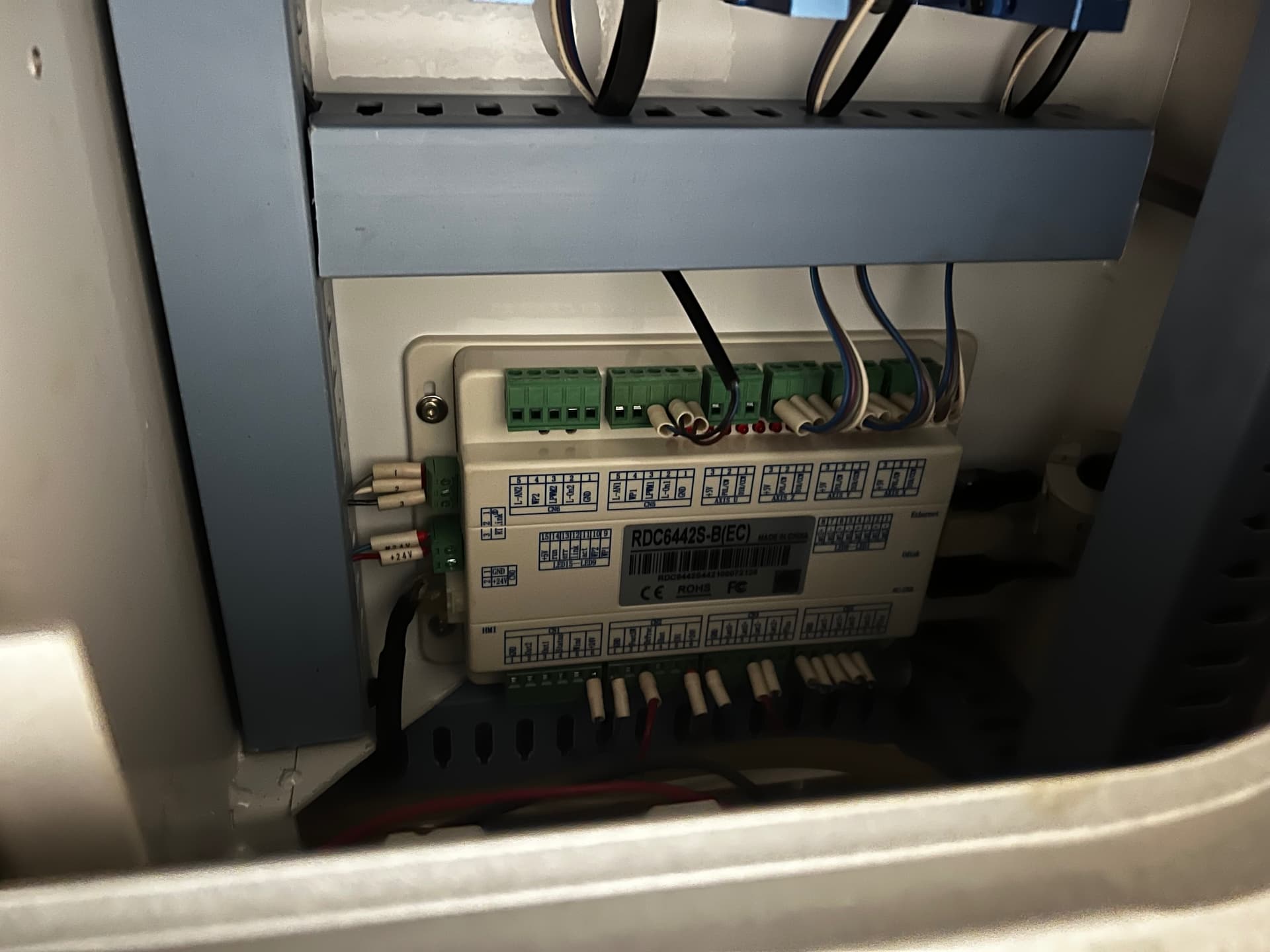

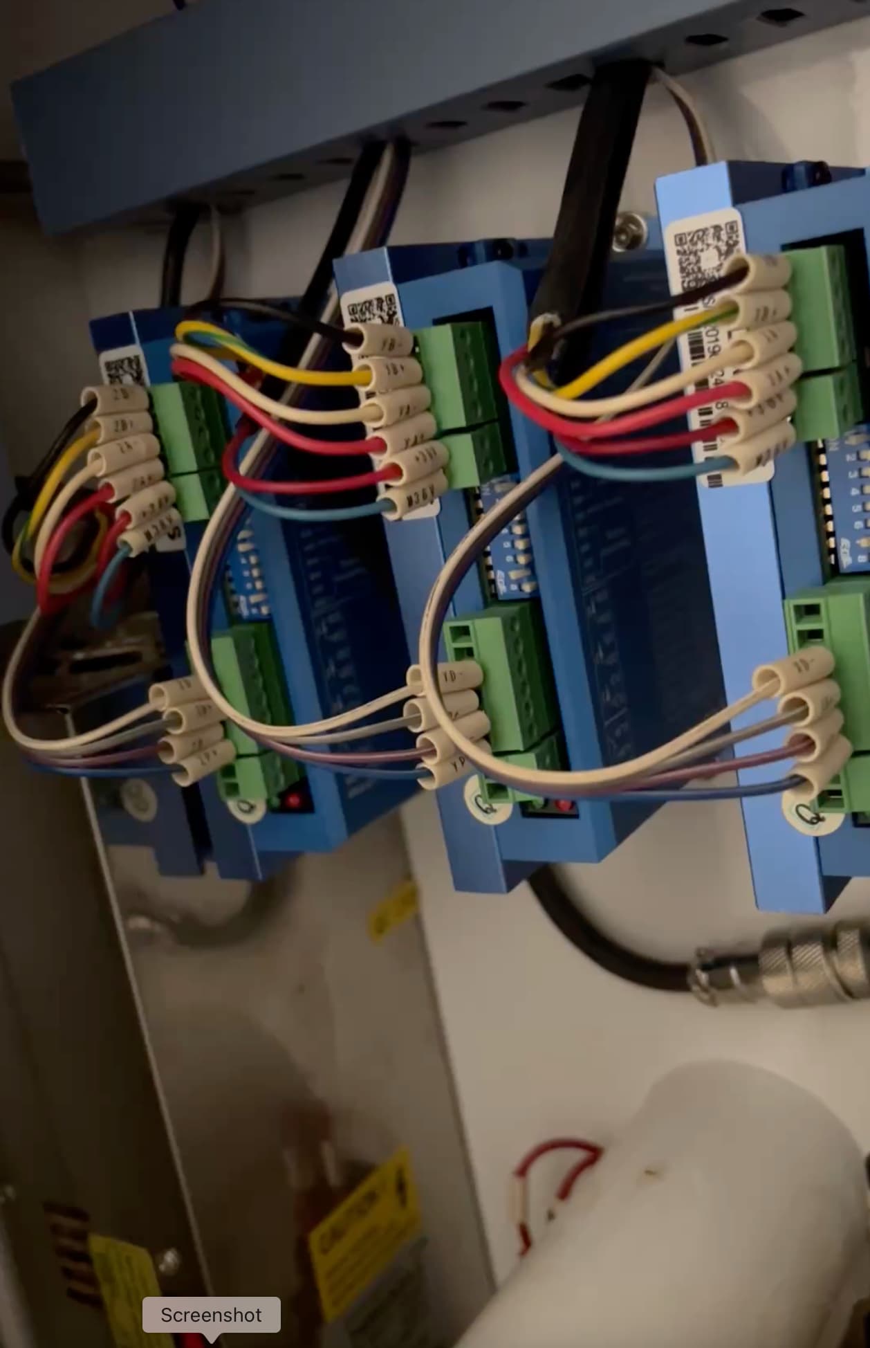

If you open the electronics door and take a photo of the insides, maybe we can help. Information in the link is not really usable …

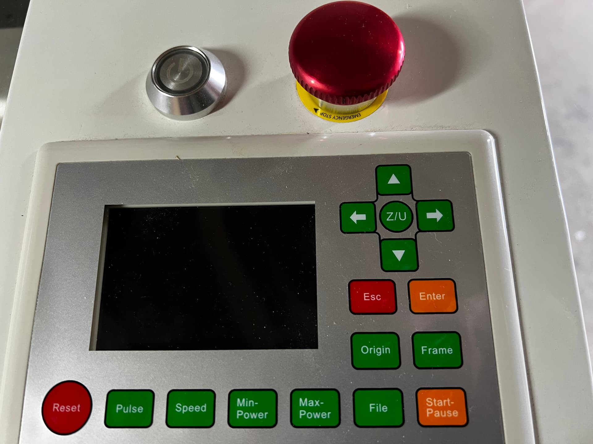

Does number 5 indicate it’s using a non-standard controller? RDWorks runs the Ruida controller, so this is a question about compatibility. This is why we need to see inside.

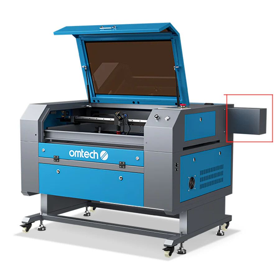

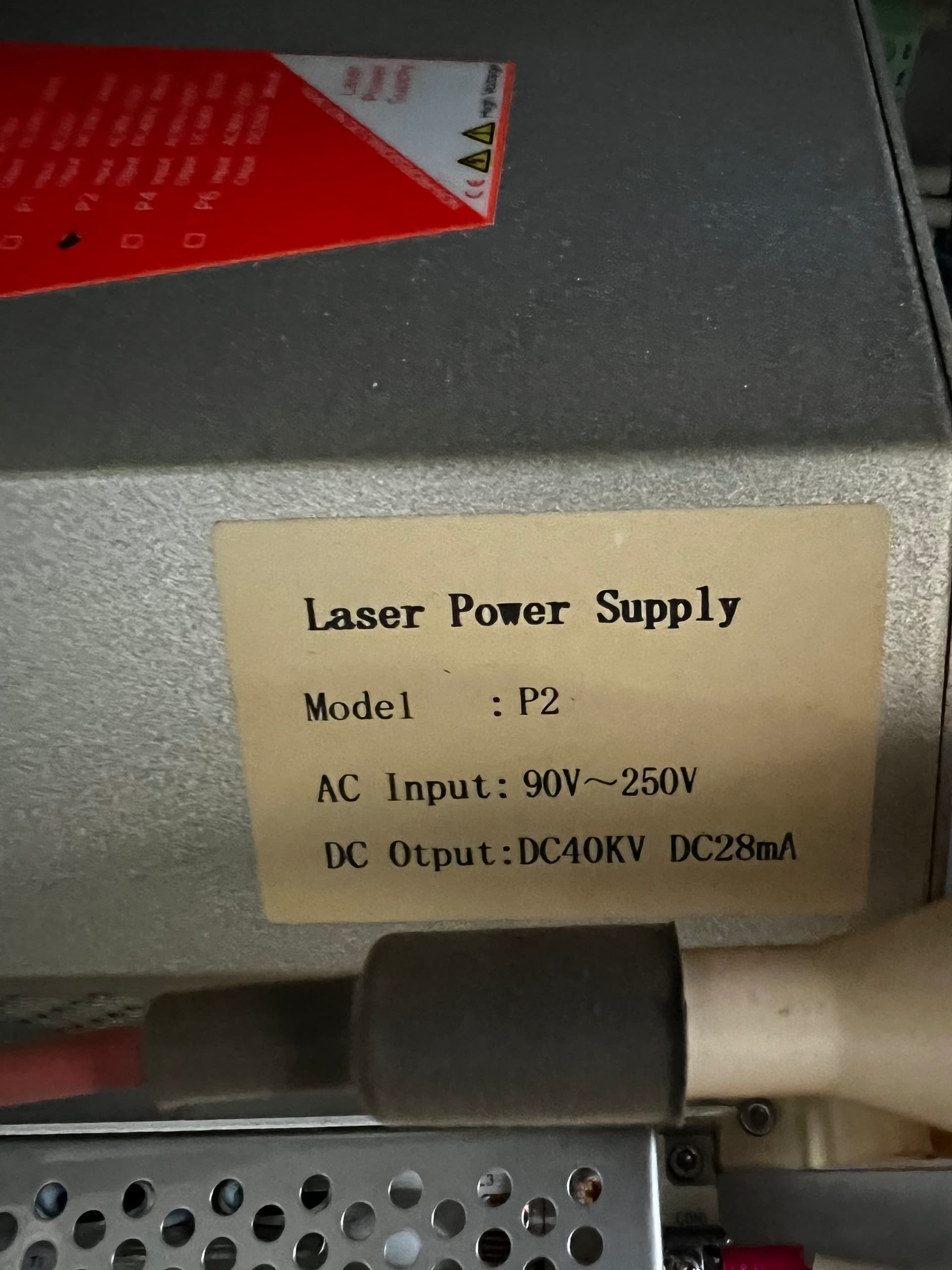

They claim it’s an 80W machine, however an 80W tube is usually 80mm in diameter and 1250mm in length. The machines specifications indicate it’s <1000mm in width… Good idea to measure the length of the tube.
Does your machine have a side extension to allow for the extra size of tube, such as the one on this machine?
You need to look inside and let us know the type of controller. A few photos would be good.
Will do Jack, and will post photos in here as well as following Ed’s suggestion regarding a post for help in setting up as a new user.

Hi again Jack.
Been a little while but things going on etc!!! Any way I am going to post a lot of photos of my machine as requested plus a lot an info I have been able to gather so far. cheers :+1:
