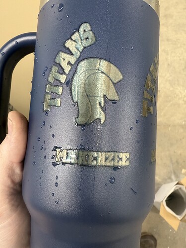

I’ve been learning all day. I just realized I had my nozzle was way too close (3mm) and I’m slowly backing it off and the engraving is becoming much more focused / sharp. I’m at 15mm currently
Here is what it looked like at 3mm (it slipped on the rotary)
And this is what it looks like at 12mm:

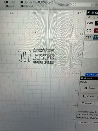

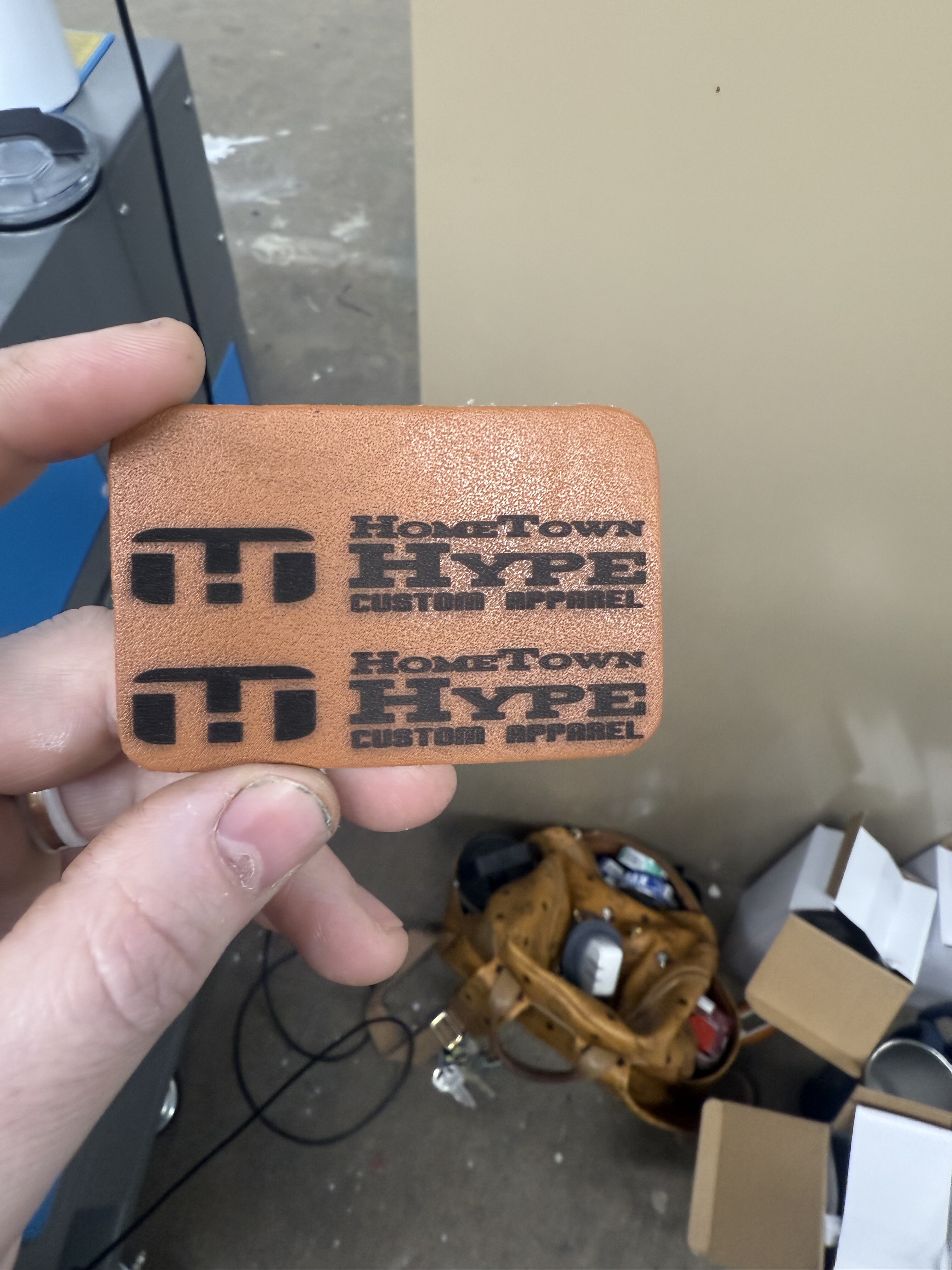

I went back to my laser today and converted it back for “flats” instead of rotary, I loaded my saved settings (I made a backup like you told me to) and made sure I’m not in “rotary mode”
However now when try to burn something, my design is pinched on the y axis, it’s not as tall as it should be
Any clue here where I’m going wrong?
This is what my design should look like:
And here is how it’s coming out:

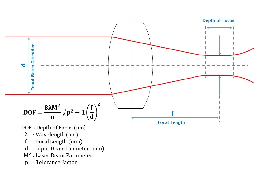

This is a common view of how we generally imagine how lenses operate.
But this is much more representative of a lens.
There are on-line calculators for computing much of this information.
If you know the focal length of the supplied lens, you could measure from the approximate center of the lens to the mug.

Be certain you don’t have the rotary enabled, because it’s very easy to be mistaken.
Take a look in the Machine Settings for the X and Y axis distance/step values: on a CO₂ machine, they should be equal. If not, then the settings you saved as Linear have values from just after you started fiddling around to set up the Rotary.
You can load an auto-saved config backup from long before you did all this, which should reset everything to the linear-only status quo ante.
