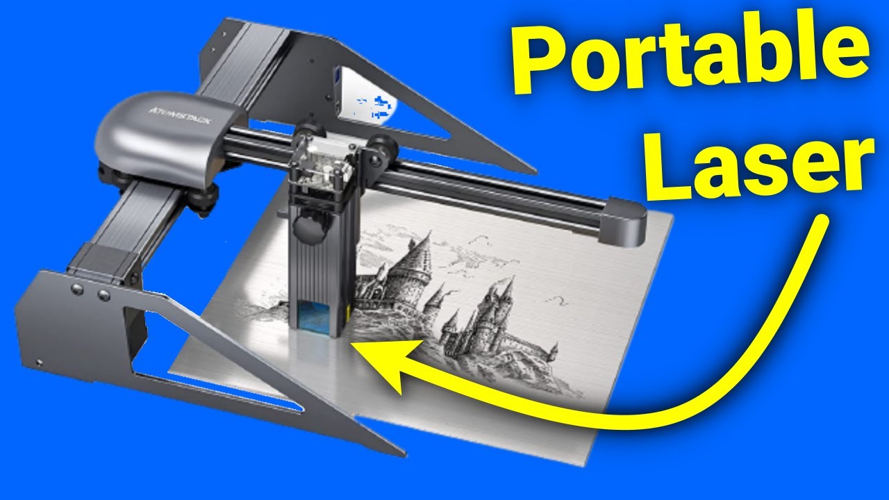

You might double check your cabling. The author of this video found a cable connected to the wrong port on the controller board from the manufacturer. It’s also unclear to me if the device has homing switches which could be the cause of the Alarm 9 your seeing if it doesn’t.

Thanks lots for this. That cable was a issue for me and one other one wasn’t seated.
