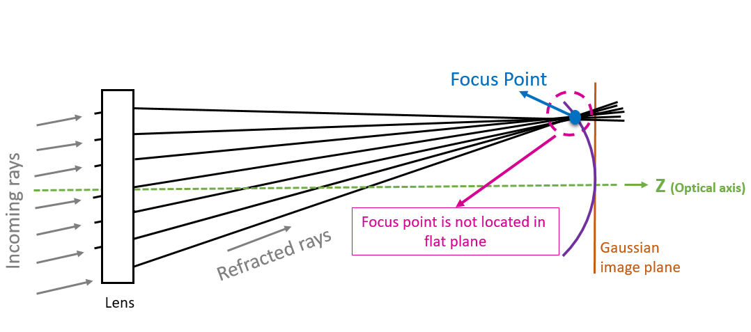

Here is one guide on F-Theta lens operation. There are many.
