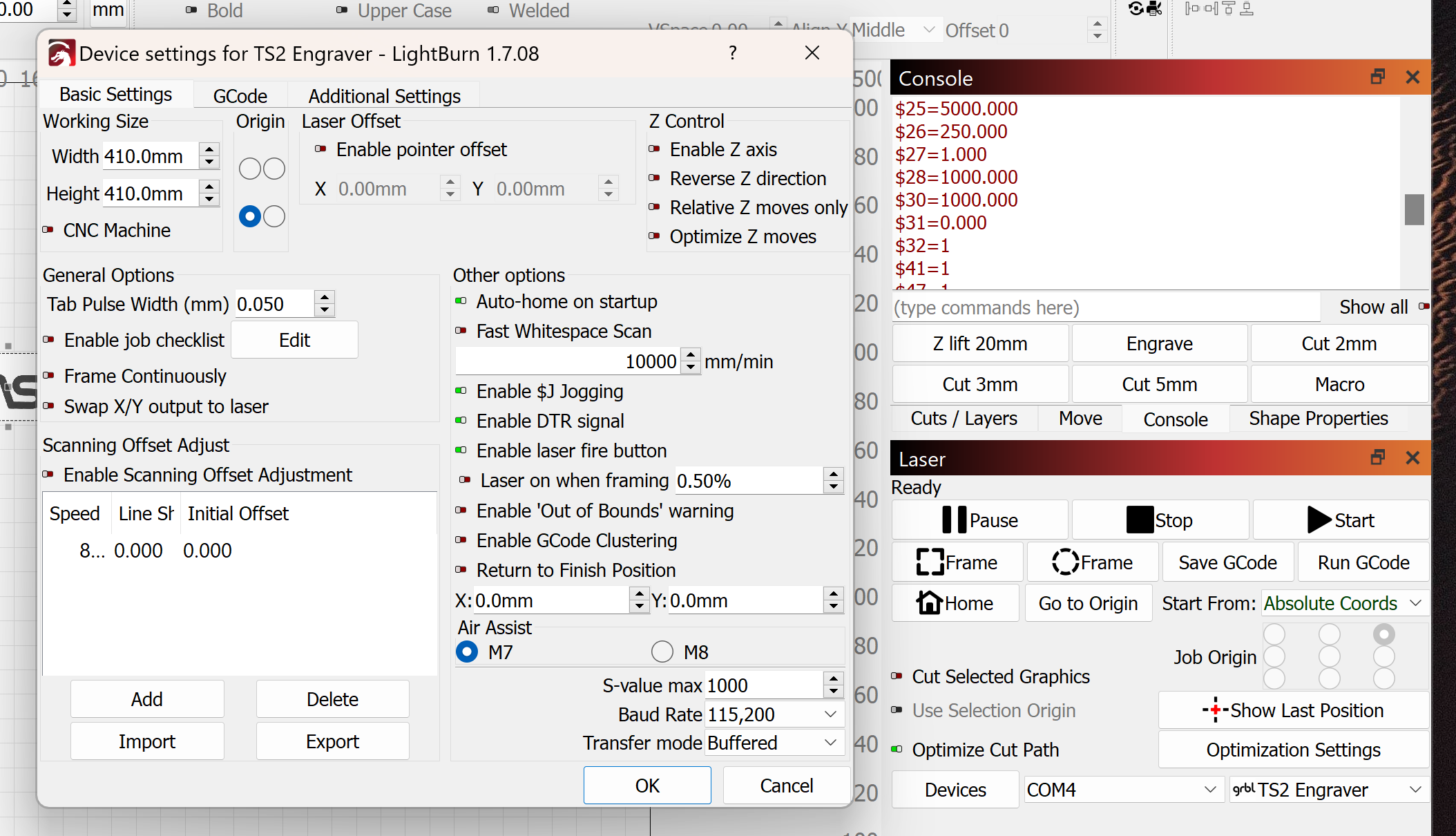

We are just trying out new TTS-20 Pro laser engraver.
I am attaching a video. Diode light comes on, it goes through all the xy axis, but doesn’t print anything.
We are using LaserGBL software.
Appreciate any help.

Not sure what you mean by you are using Lasergrbl.
Does it work with Lasergrbl and not work in Lightburn?
its working now. power was the issue. got the right adapter
