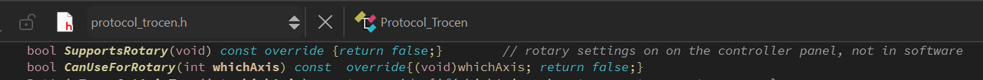

Unfortunately, Trocen doesn’t play well with a rotary:

@JohnJohn: What’s the truth about Trocen nowadays?
There has never been a rotary button in LightBurn for the Trocen controllers. There’s no way for LightBurn to query for or alter the setting.

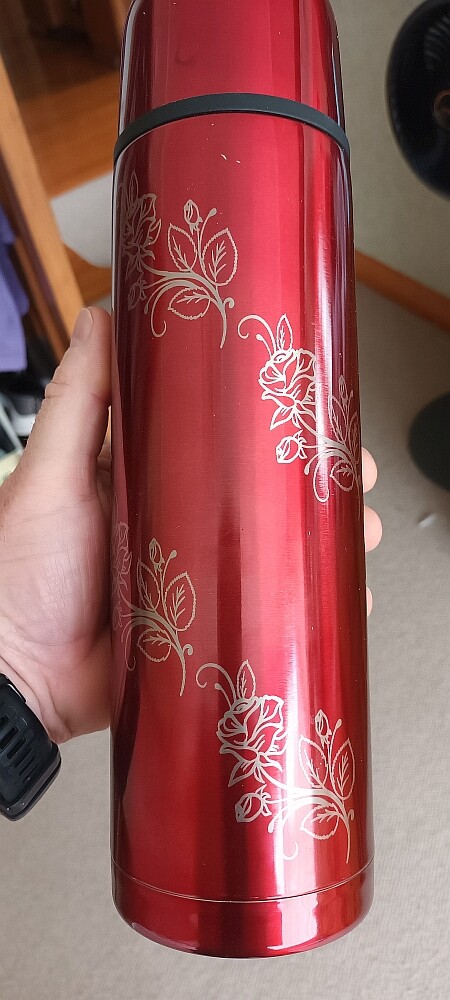

That’s really strange because I still have several projects on file where I used my rotary from LB and distinctly recall having the rotary function for my roller attachment which I have only ever used on the CO2 gantry. When I open these projects there is no longer any rotary facility.
In order to accomplish the job I had yesterday I was constrained to do it from the controller which was SO involved and KNOW I’ve never done it that way before.
The project attached (Nov. 2020) shows the setup lines and the photo the result.
I have several other projects done the same way. I was using LB before I bought the gantry and have never used any other software on this machine. The controller is Trocen AWC708s.
Rotary Red Flask.lbrn (945.4 KB)

Well, I’m not sure else how to put this - Trocen’s own software also doesn’t provide the ability to set rotary parameters in their software, because the hardware doesn’t support it. It’s possible they’ve added it to some of their newer models, but the 608 and 708 definitely didn’t.
You might very well have used the rotary on the gantry and just got lucky with the settings, but I can say for certain that you didn’t use LightBurn to enable rotary mode, or change any rotary settings on a Trocen laser. The code doesn’t exist, and never has.
