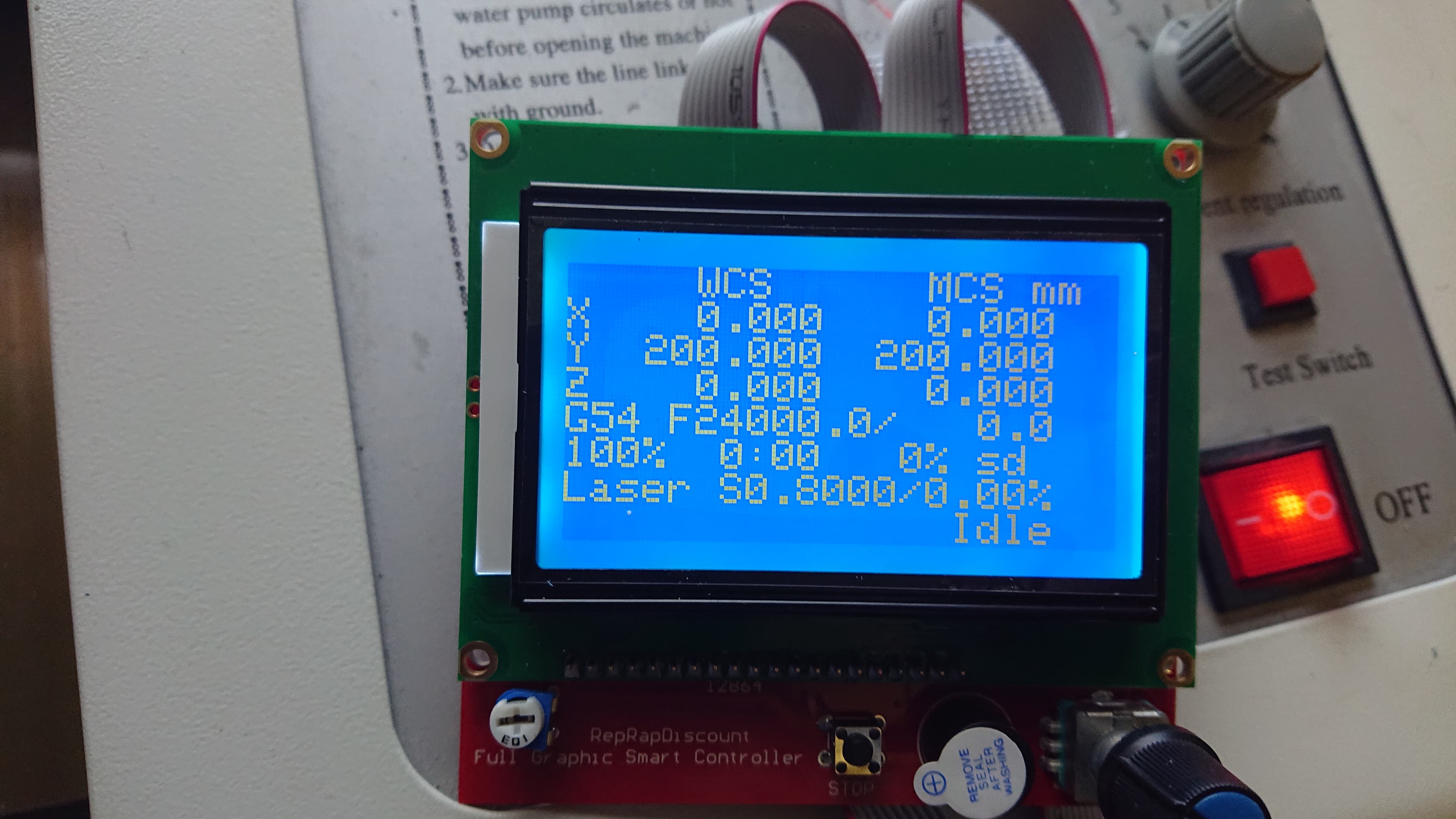

I have k40 laser and i put Cohesion3D Controller. But not fire move is ok but when i pres the play on curtin is only move but not cutting. If i trying gravering is freeze. I don’t know this problem with LightBurn some code missing or with controller, please help!!!

Ok i put picture

$$ is used to echo the configuration for GRBL controllers, but Smoothieware uses a config file stored on the SD card. Where did you get the firmware that you’re running? Did it come with the LaserBoard, or did you find it somewhere else?

Now is ok i solve problem is make fire. Because i chose chesion3d (gbrl) on LightBurn but need (smoothie).
