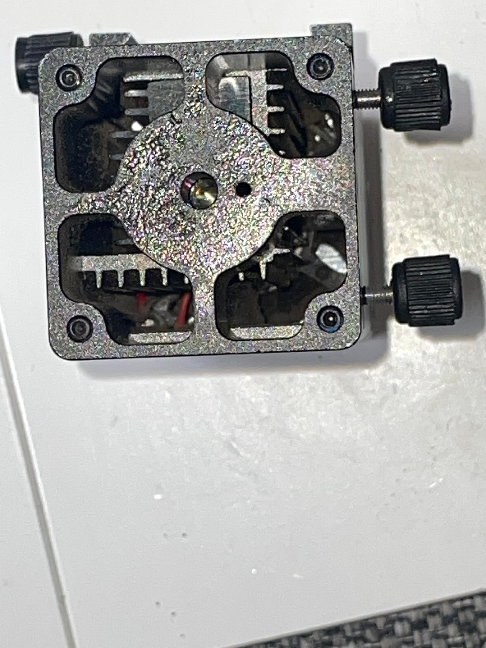

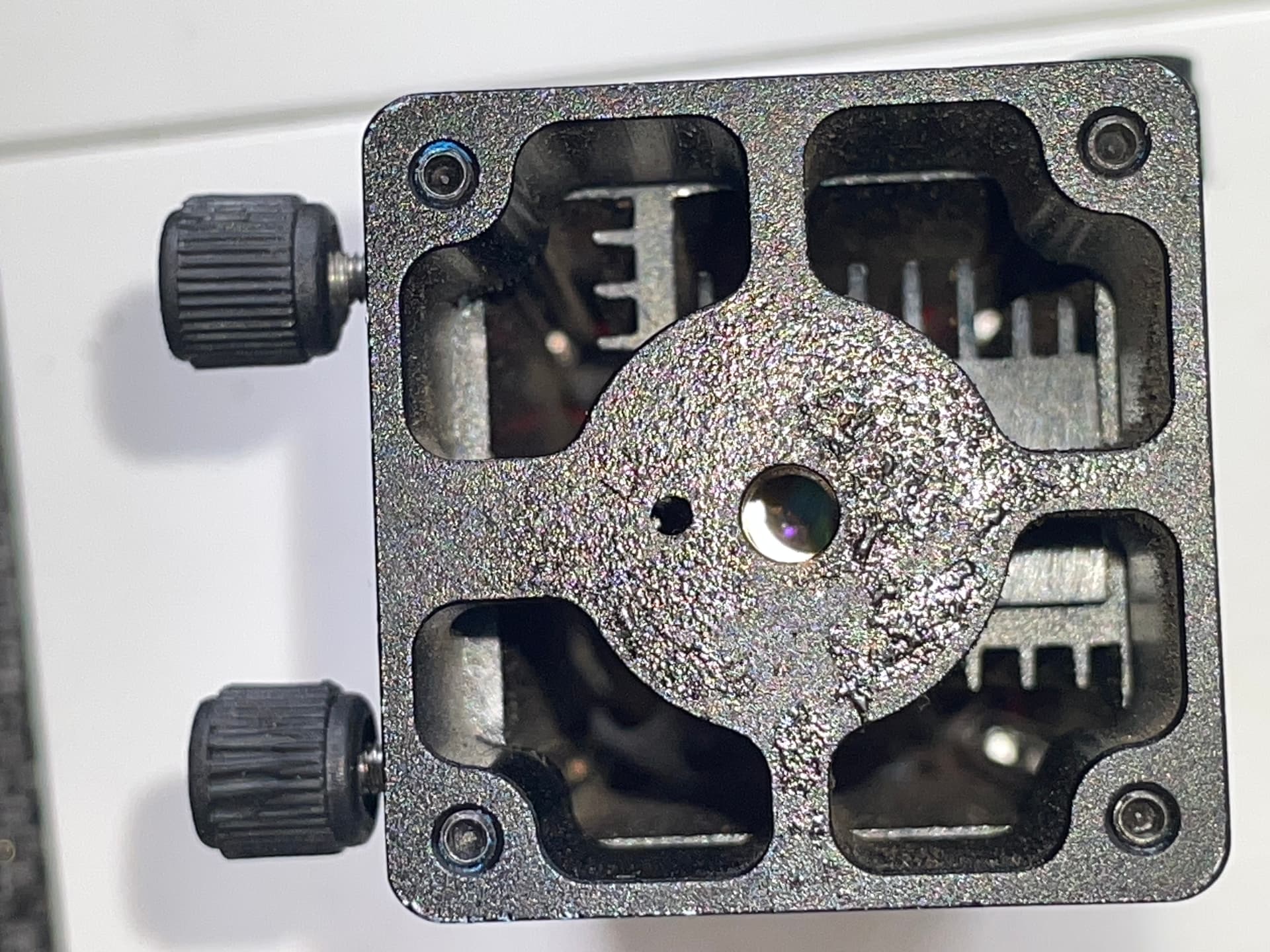

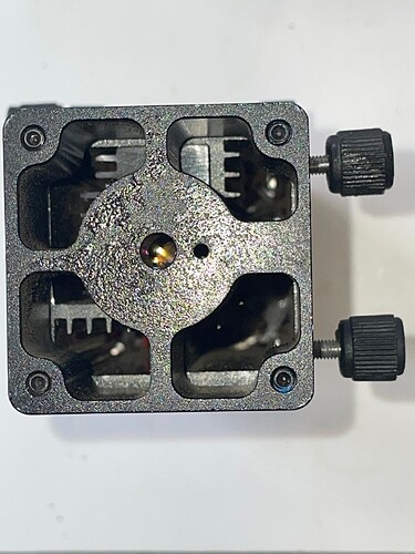

I had previously used a small brush to clean the fan but I could only get to the top and a very small amount of the underside of each fan blade through the side of the module. So this time I removed the top cover and took the fan out to clean it. I also removed the adjustment block from the bottom to clean the fins within. It was then I noticed a small amount of the black paint missing from the side of the centre hole at the top of the adjustment block. clearly the beam had been partially obscured therefore only a very small percentage making it to the material. See the attached photo.

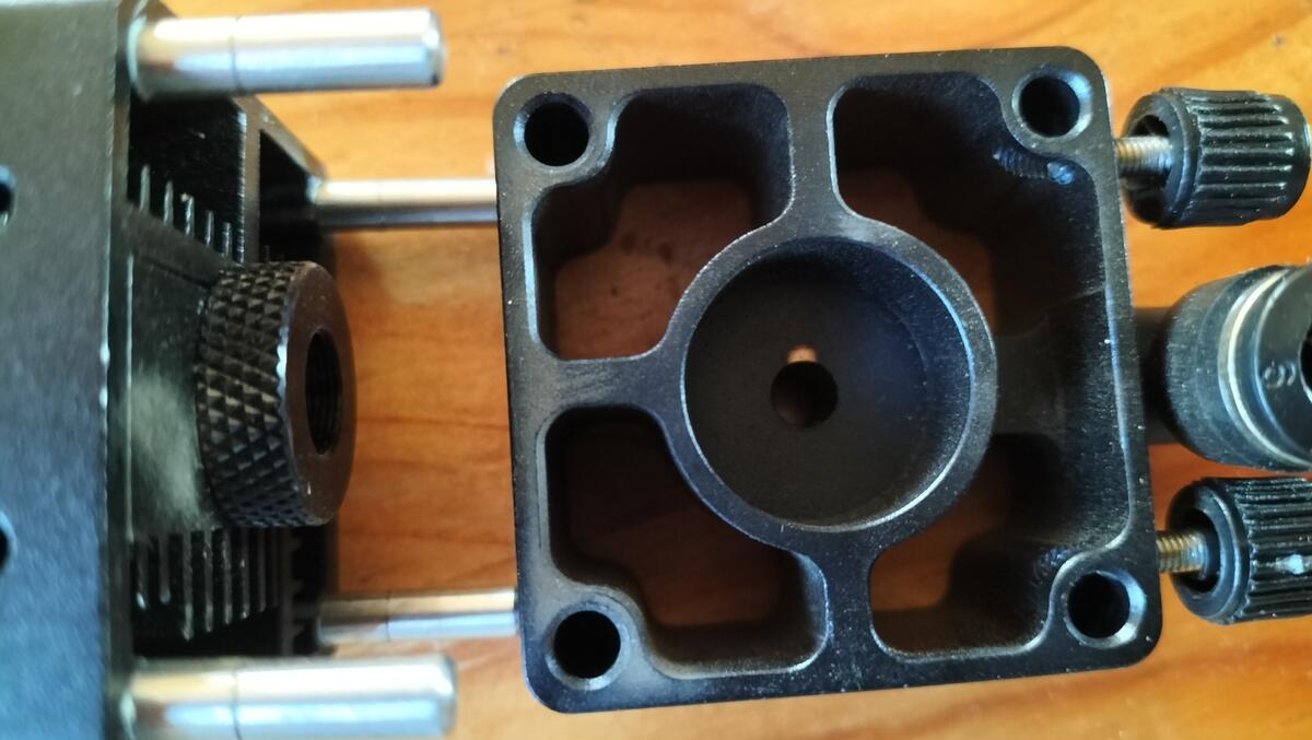

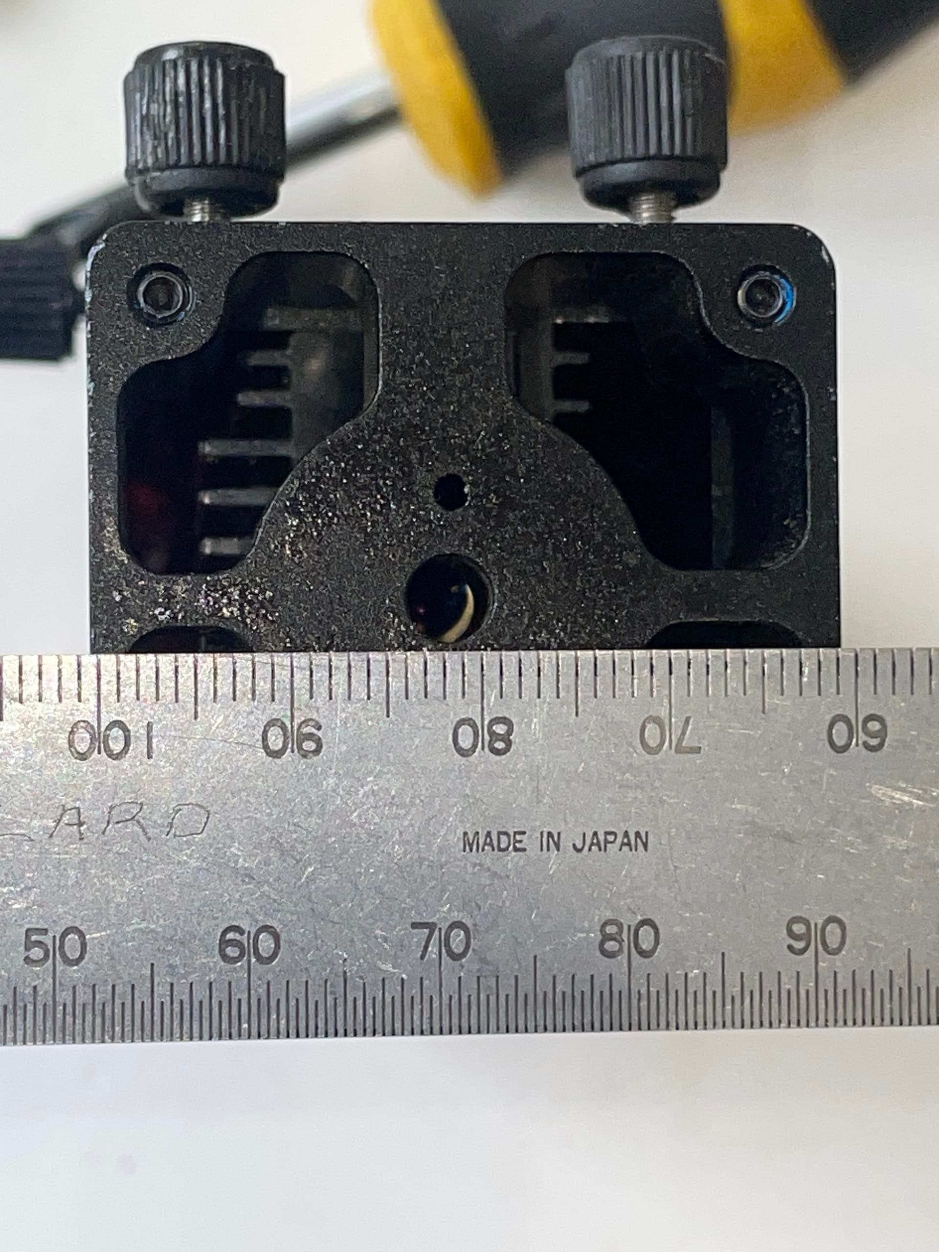

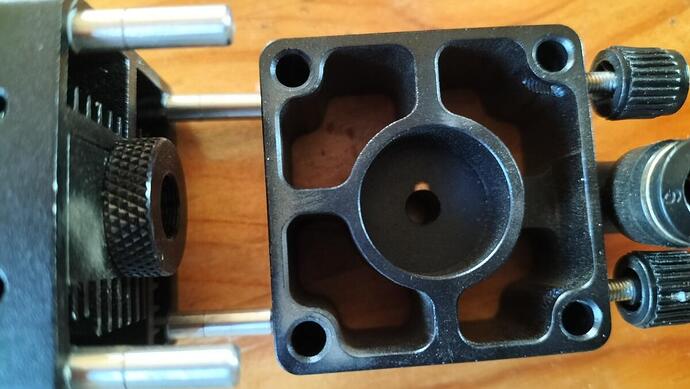

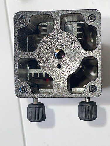

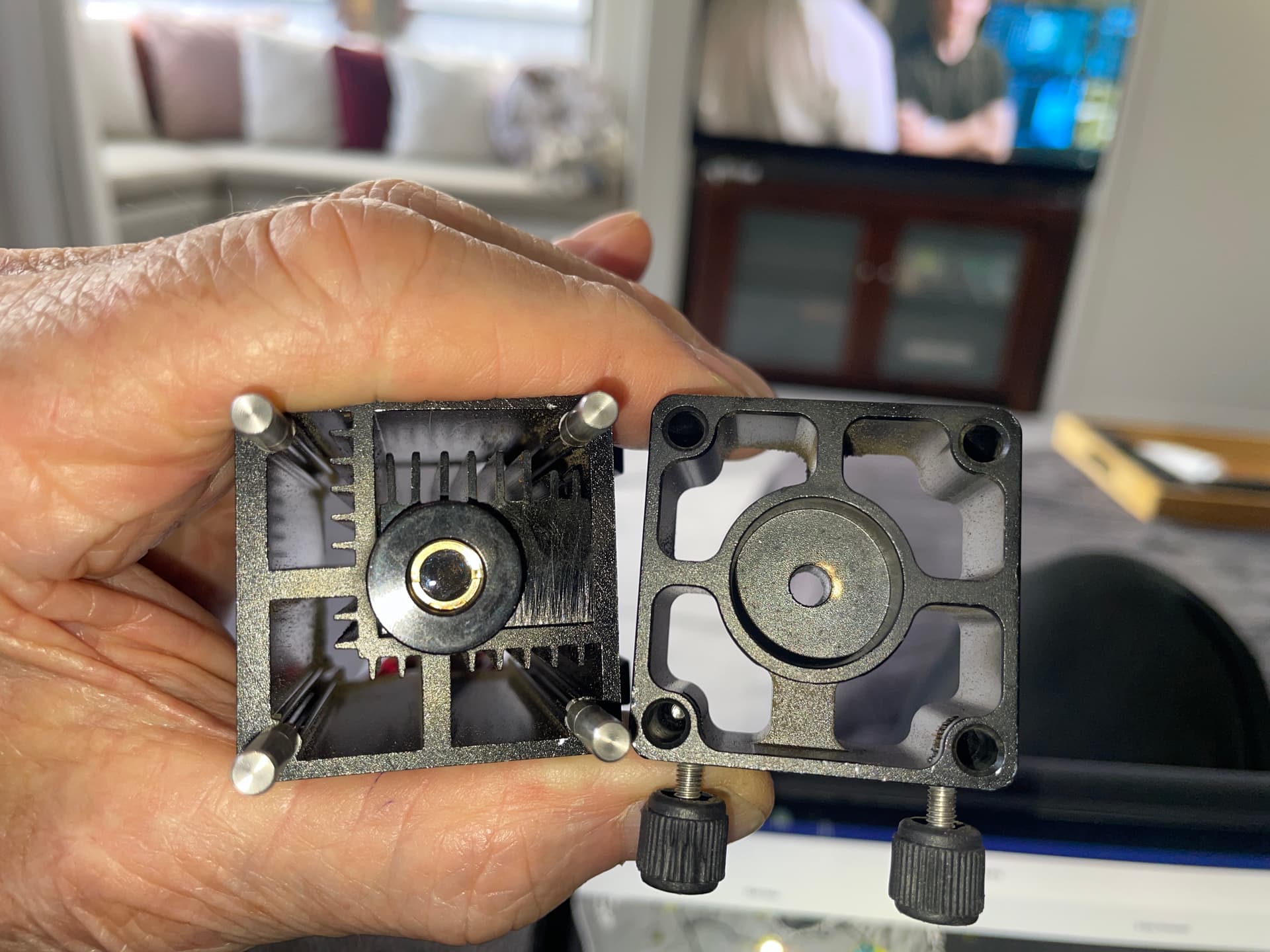

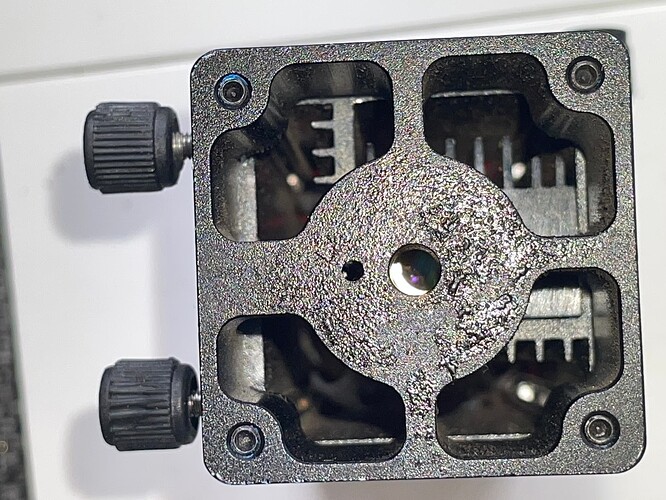

I then found the lens was off-centre by 2mm. There was no easy way to tell which was the correct orientation for the adjustment block. I tried each way until the best fit was found. Photos 2,3, 4 & 5

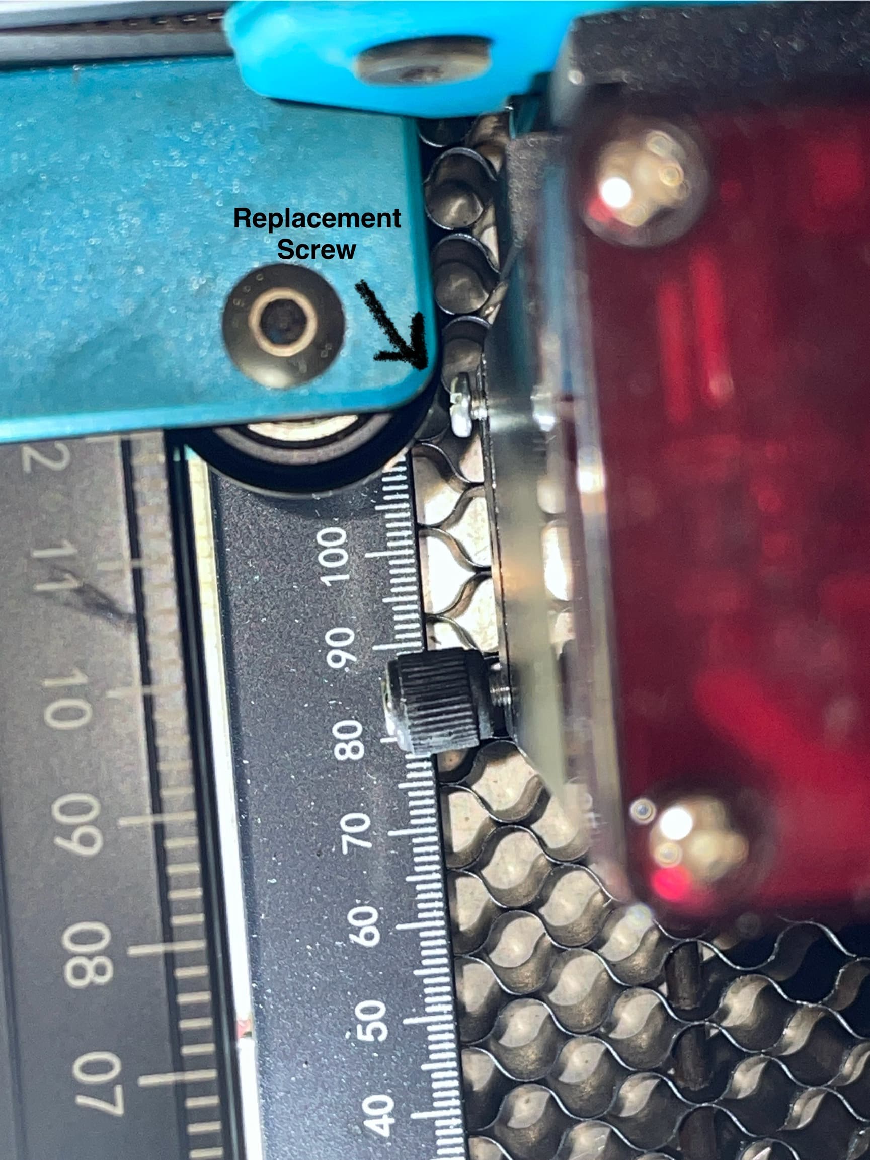

The last photo is the best orientation for the adjustment block so the lens is aligned with centre of the hole but then I found the set screws interfered with the left Y-motor assembly so I had to replace the thumb screw with a short flat head screw to give the full 300 x 300 work area.

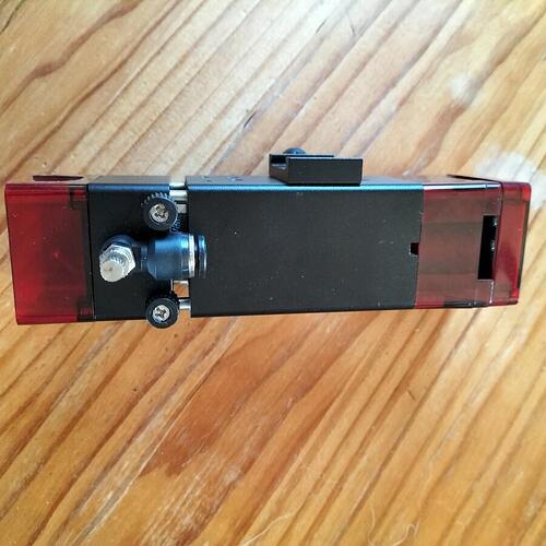

I have the same but it has an air assist connection.

If you look at my photos the block is able to be fitted in four different positions because the four spigots are evenly spaced in a perfect square however the hole for the laser beam is NOT in the centre. My final photo above shows the only way the lens perfectly lines up in the centre of the hole. The fault happened to mine because the thumb screws were fouling the y-motor assembly when x was in the zero position so I wasn’t getting the full x travel. In an attempt to resolve the issue I turned the block by 180° so the thumb screws faced the other way. But because the hole is off-centre the lens was partly obstructed by the block, the black paint was burnt and the full strength of the beam wasn’t getting to the material being cut. To resolve the x travel issue I put much shorter set screws in place and turned the block back to the original position.
Here you can see the small replacement screw and how the original thumb screw would’ve come in contact with the y-motor & belt wheel assembly.

I had thought of drilling it out too but decided not to as it’s size could possibly be correct for air assist air flow. I measured the lens position in the module itself and found it is also offset from centre as well. So the hole in the block can only be centred in one position out of the four ways. This begs the question why the spigots/mounting posts aren’t arranged to only allow the block to be fitted in one orientation. It would only take one of them to be a couple of millimetres off the perfect square that they are now.

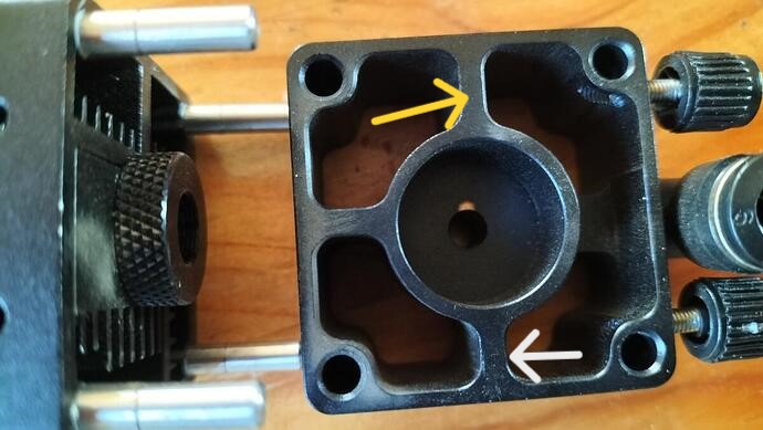

I noticed the stiffener (yellow arrow) is longer than the one with the white arrow. That would offset the hole. Turn 180deg’s.
The fault happened to mine because the thumb screws were fouling the y-motor assembly with the laser head in the zero position on the x-axis so I wasn’t getting the full x travel. In an attempt to resolve the issue I turned the block by 180° so the thumb screws faced the other way. But because the hole is off-centre the lens was partly obstructed by the block. Therefore the black paint was burnt and the full strength of the beam wasn’t reaching the material being worked on. Instead to resolve the x travel issue I turned the block back to the original position and put much shorter set screws in place to clear the obstruction(see the photos attached above).
This only works if you do not have the air assist nozzle there.
I had another look at mine. There are two options, the thumb screws to the left or to the front. Either way it fouls the x-axis or the front frame. A design fault that has to be remedied by enlarging the centre hole. I don’t think it will affect the air assist. It’s a mod I’ll try, I don’t use a 10W much I find Two Trees 20W better. Complain to Two Trees and ask them what they are going to do about it. There is too much competition in China now and these smaller companies like to please their clients. I’ve always had problems solved when complaining, in a nice way.
