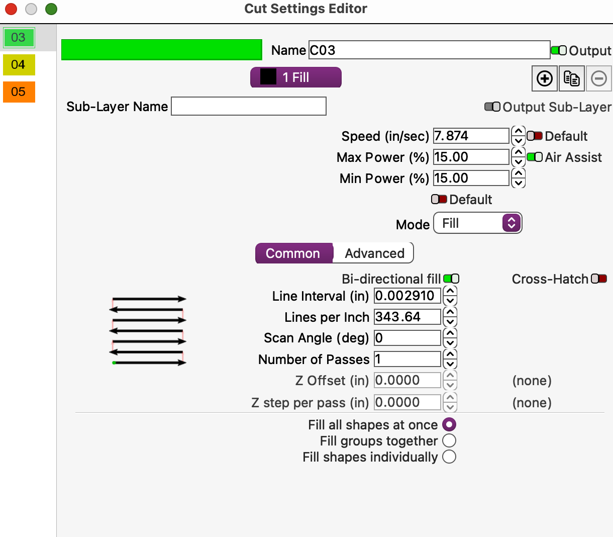

I understand that to fix the double lines when you do Bi-directional scanning, you fix this by adding an overscan amount but I don’t seem to have that option in my settings. Could someone help with this? I would like to someday take half the time to make something. Right now I am doing everything in a single direction to get a crisp scan.
Overscan is handled automatically by DSP controllers. What you’re describing is fixed by scanning offsets:
