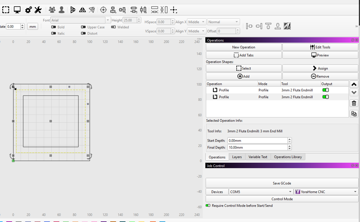

I have an operation in 0.8 and when trying to preview I get the message below but the operation has output checked
Thank you for bringing this to our attention. Have you ‘Assigned’ a shape to this Operation? If not, there is nothing to preview, as no cut paths can be generated without a defined shape.
I do note the wording of that warning could be adjusted for clarity. Will make a report for refinement. :slight_smile:
Yes I have a 100mm x 100mm x 20mm block I was wanting to cut out
Ah, thanks. Please show a full-screen cap and the settings for that Operation for review.
Can you post the .mage file here for us to look at?
hey im no expert but had similar problems press select and see if the square you want to profile lights up , for the want of a better word! if it doesn’t highlight it and add and apply
i have fixed the problem now for the preview, I had tabs selected
