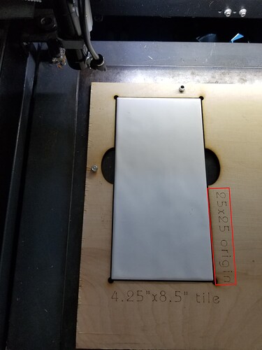

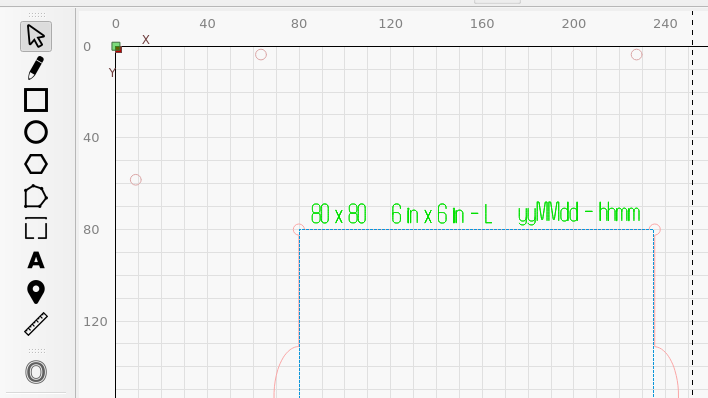

On my jigs, I engrave a 0, 0 location for the object that takes into consideration the jig offset. From Lightburn, I move the machine to the specified coordinates, then I set that as my user origin. Then it just moves out of my way…
At this point, start from is set to user origin.
I only use absolute coordinates when I’m making jigs to use in the machine.
In this jig, I’ve set the cutout so the corner of the object (blue tool layer) is at the 80x80 mark and I cut it out with absolute coordinates. Notice the alignment pins on edges. I usually use only a pair of them at a time.
