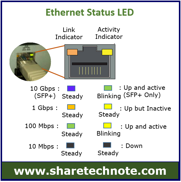

When you connect ethernet, do you see LED indicators at the plug that show network activity? You should see this on both the computer and controller side.
While you’re at it, make sure that the issue is not on the extension from controller to outside of laser. You can try connecting directly to controller to bypass the extension.
The Ruida has a LINK and ACT led, the LINK shows it’s electrically connected (not talking) the ACT led should light up with a data flow.
This is the back of the connector – RJ45
