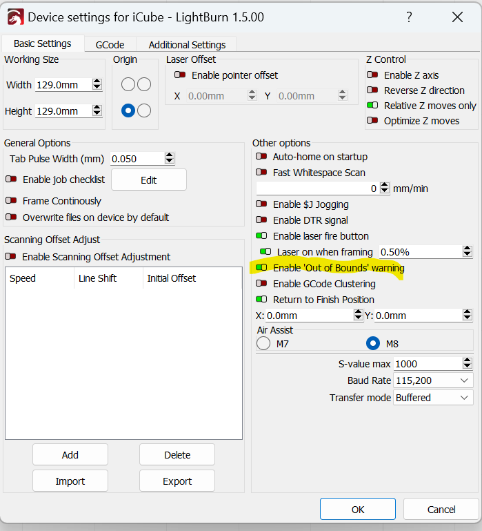

Did you enable this setting?
That’s enabled, but it only warns if the shape itself is out of bounds, not the overscan.

I do have the out of bounds warning that @misken mentioned enabled.
If not enabled, I get no warning.

I’m getting the same thing with my new Algo DIY on 1.4.05 and the warning works fine on my Ikier using the same PC. I feel like an idiot. Sure I missed a setting somewhere.
Make sure all of these things are true:
  1. Your work size is correctly configured in Edit->Device Settings. If you have changed the laser module from the factory default the work size may need to be adjusted to accommodate the new module
  2. The machine is homing properly and that position after homing is correct for your laser
  3. No moving of the laser head by hand. Use jogging controls exclusively.
  4. “Enable ‘Out of Bounds’ warning” is enabled
These things alone should get you proper out of bounds warning. If any of these are not true then out of bounds warning will fail in some situations.
Additionally, these things can simplify troubleshooting or avoid other similar issues:
  1. Work in Absolute Coords. Out of bounds situations while using User Origin or Current Position can be non-obvious
  2. Make sure max travel dimensions are configured properly in GRBL machines ($130, $131).
  3. Enable soft limits in GRBL

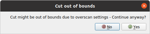

Right, well this is weird. I just tried it again, and I did get a warning this time. It’s strange that the warning only appears when you attempt to start the burn, rather than previewing it, but I did indeed get the warning. And if you’re paying attention, the preview will show the movement crossing the boundary, so it shouldn’t get to the point where you’re starting it.
I can only assume that the time recently when my laser head crashed into the side rail while overscanning was due to me setting the starting position by hand, which I rarely do.
