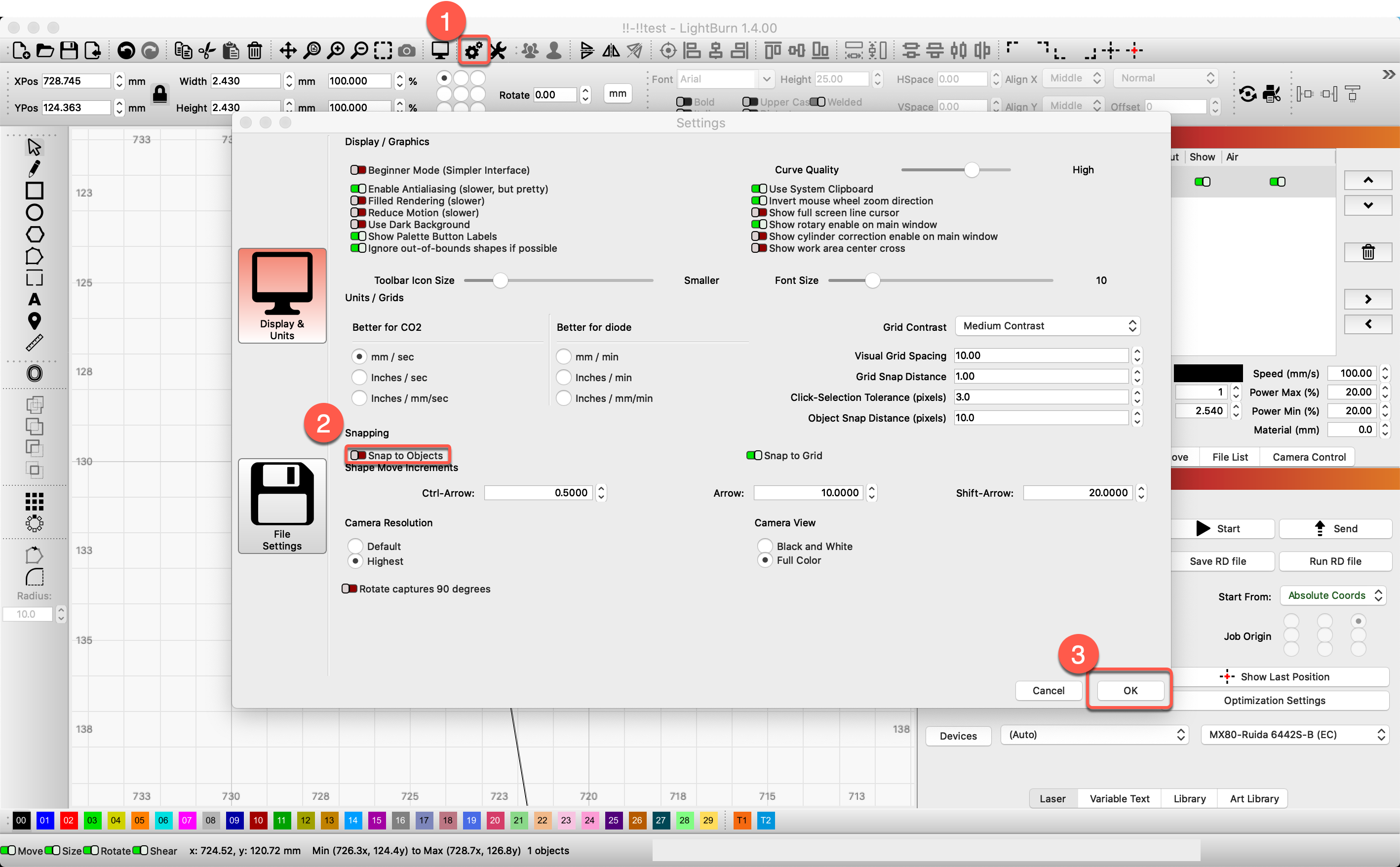

When I turn off the ‘Snap to Objects’ and commit this change, the behavior of the cursor changes, no longer showing the snapping behavior marks. Using our latest public release, LightBurn 1.4.00, running on an older MacBook Pro, I am finding the change to snap behavior retained and set as expected upon restart of LightBurn.

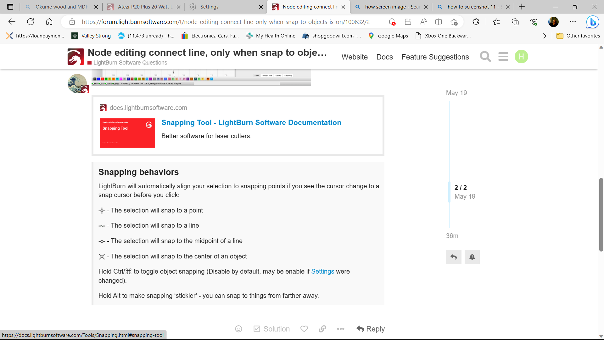

Snapping behaviors
LightBurn will automatically align your selection to snapping points if you see the cursor change to a snap cursor before you click:
- The selection will snap to a point
- The selection will snap to a line
- The selection will snap to the midpoint of a line
- The selection will snap to the center of an object
Hold Ctrl/⌘ to toggle object snapping (Disable by default, may be enable if Settings were changed).
Hold Alt to make snapping ‘stickier’ - you can snap to things from farther away.

  • Start LightBurn anew
  • Click the ‘Gears’ icon near top-center
  • Flip ‘Snap to Object’ Off (red)
  • Click the ‘OK’ button to commit change
  • Quit LightBurn
  • Restart LightBurn
The result should be that the ‘Snap to Object’ switch should still set to Off (red).
Please confirm what you observe.

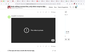

your site wont let me send a video of the screen. and screenshot doesn’t capture the cursor.
whats happening is:
the cursor doesnt change when the snap to objects is switched off and its hovering over a node.
when snap to objects is on, the cursor does change when hovering over a node.
You can host the video on YouTube or similar, make it public, so we can see and then publish the link here. For screenshots, you can drag and drop directly in the forum editor.
Alternatively, hit the ‘Upload’ button image and navigate to the file(s) you want to upload.

Ill try to upload the video.
Not a bother on our end. We are here and want to provide assistance.
Please make public so we can view.
For the majority of my personal usage, I leave both snap behaviors on, and use CTRL or SHIFT to alter the behavior as needs arise. This way, I get the best of both.
You also have control of the distance and tolerance for snapping behavior that you can adjust / tune to your liking.

I’m only 64 so I’m getting slow! lol thank you for your time, and the video is what you described, a guy that doesn’t know he can switch with control shift,
and its public now!
