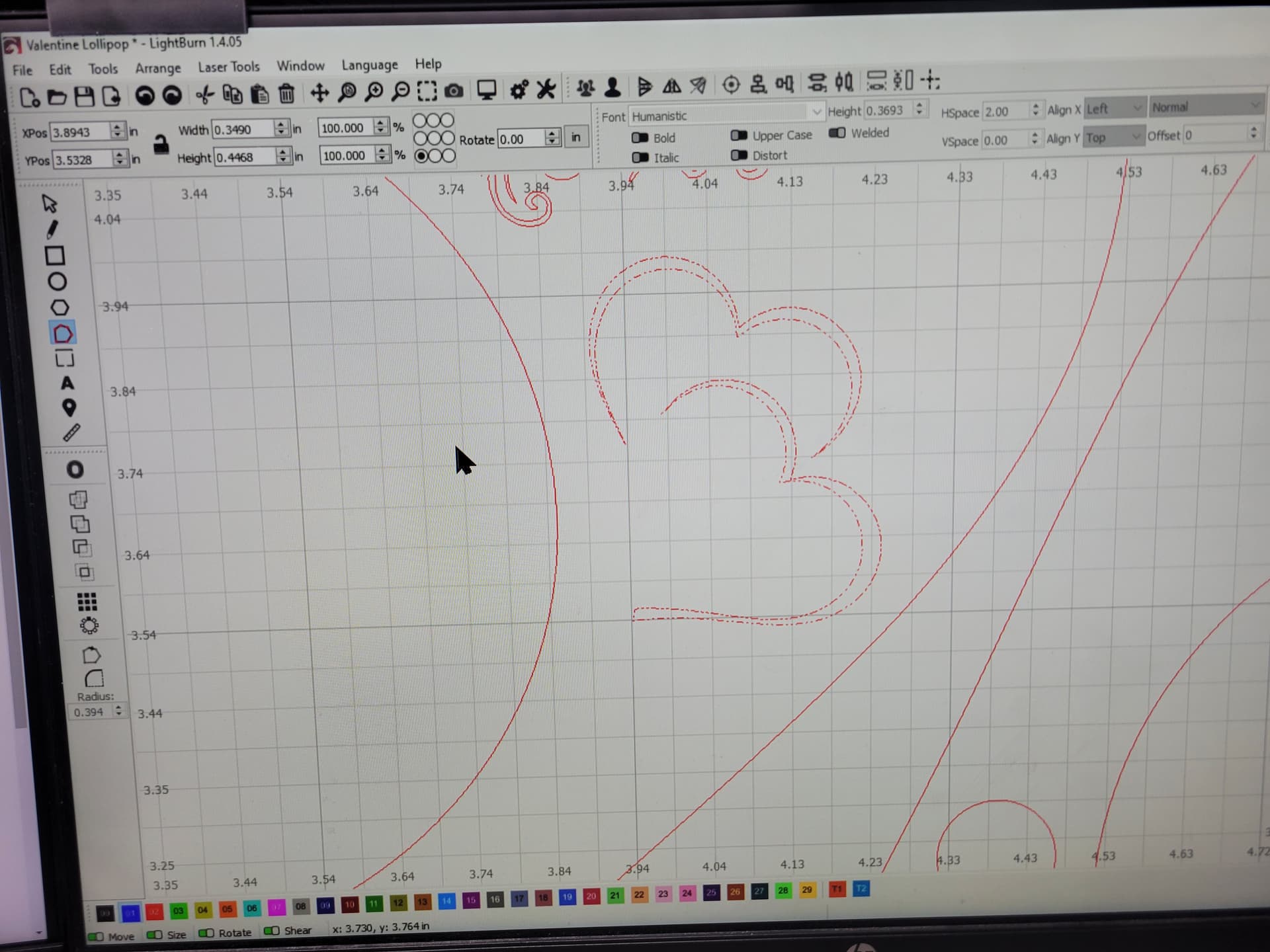

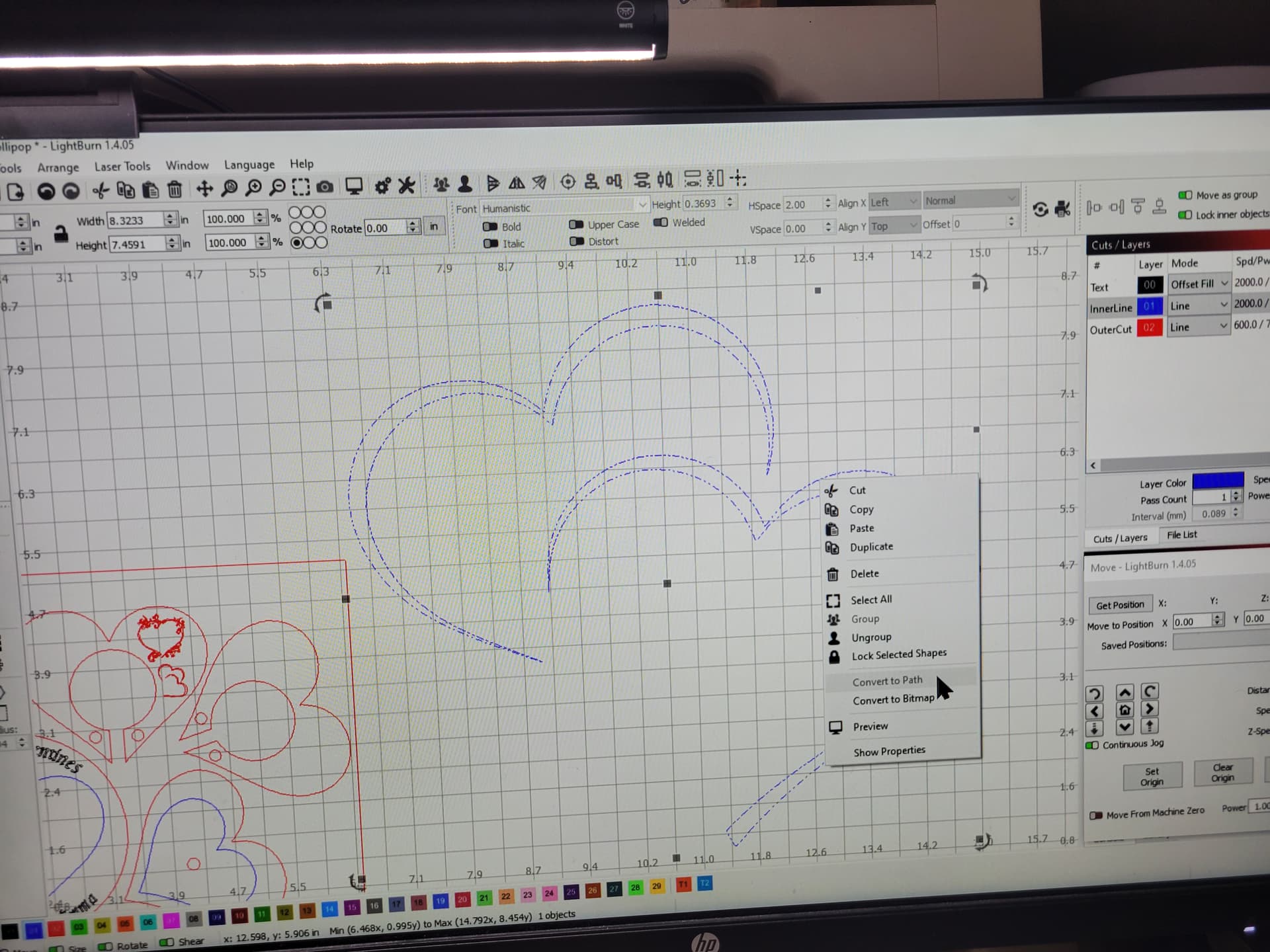

I have imported a simple image to use in a project. When I click on the image/right click to select Path/ the command is grayed out (I assume it means it is already a path). At that point, with the image selected, select ctrl + " ’ " yet the image does not convert to nodes for editing. Where is my error?

I verified that it was indeed a Trace. Second screenshot was a fresh Trace, full size.
I selected the image then ctrl + '. Still not opening the Node editing tool?
Thanks for your quick follow-up.
Ungroup your shapes
Boom! Deeply appreciate your All-Pro support!
