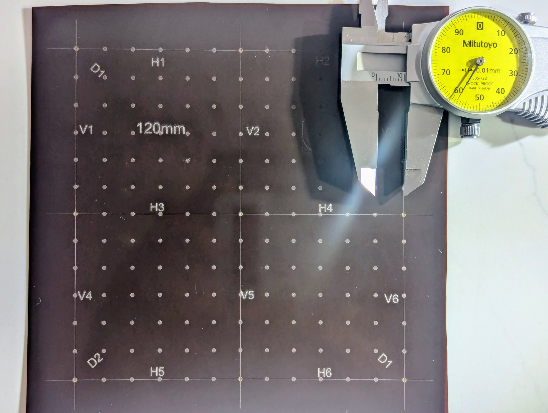

Here is a photo of the test calibrator I made, which is similar to the one in Lightburn but with more distances (1cm spacings) and labeled to make things easier to measure. Note, I designed the round holes to be cone shaped into the plastic so that it is easy to insert the caliper points and measure the distances more accurately with a caliper. (I’ve check for no bias here.) When I measure the spacing at the center, I find 9.9 ± 0.05 mm, whereas at the edge I find 10.6 ± 0.05 mm. You can even see by eye that the spacing is greater on the outside.
Because I am trying to use Lightburn for laser machining of a flex circuit board, I would like to calibrate with this additional correction, which seems to be a simple correction from distance proportional to theta to tan(theta), for both the x and y axis. I have also figured out a way to use my calibrator to iterate on the Lightburn “calibrate galvo lens” feature to do the lens correction even better, using this precision measurement with calipers.

As I mentioned in my previous post, a spacing of 9.9mm at the inner sesction inner, and 10.6mm at the outer.

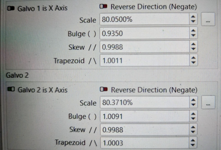

Trapezoid is X: 1.0011, Y:1.0003, very small. The trapezoid should not correct for this error, which seems to be only a function of x for the x correction, not a function of y for the x correction

Yes, I was surprised it was this big, but I think expected from the angle geometry. Thanks, it would be nice to have another measurement. Here are my parameters; taking a picture is the best way to make sure no transcription error.

Did you manually measure/ adjust your skew or did the 9 point correction generate it? Sorry off topic but just curious. Mine always came out zeros, I just assumed 9 point didn’t calibrate skew. Maybe I’m missing something in the procedure.
I calibrated with 9 point. Since the skew corrects for the x and y axis not being orthogonal, it probably has to do with the setup of each galvo. Mine is slightly off, but yours was built perfectly.

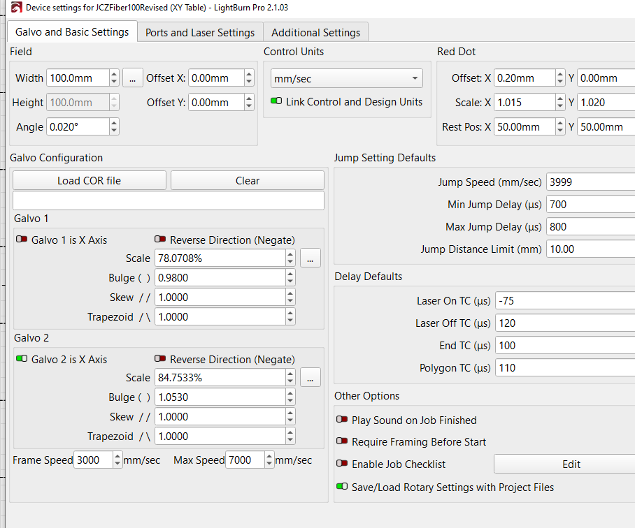

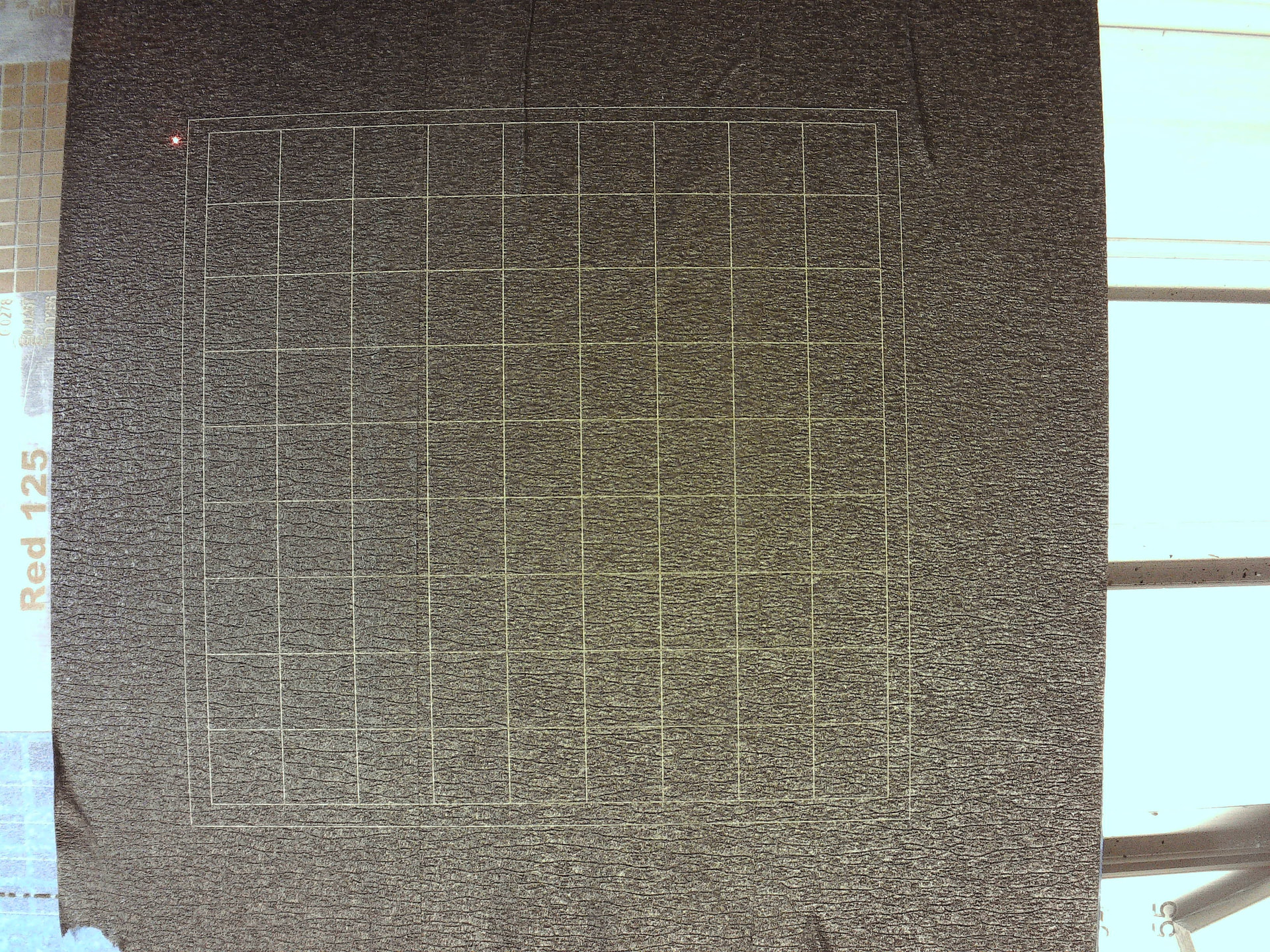

I have the 100X100 in right now so did a 90x90 10mm grid, measured a little over 127mm corner to corner, squares were equal in size and 9 squares = 90mm at edges and center 1 square was 10mm x 10mm where ever i checked, obviously measuring lines on black tape isn’t a super accurate method, but same method I used for 9 point. Next time I have a larger lens on I’ll give it a try.

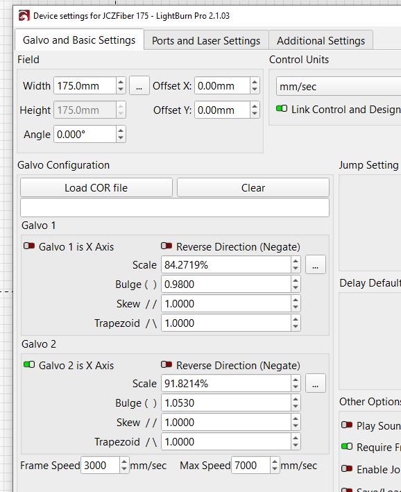

60W MOPA SG7110 Galvo no brand name on the lenses 2022 XT Laser build Speed 300mm/s 20% power 20kHz 2 passes
100X100 no trap no skew

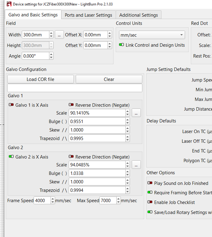

the 300X300 has a little trap
175X175 no trap no skew
